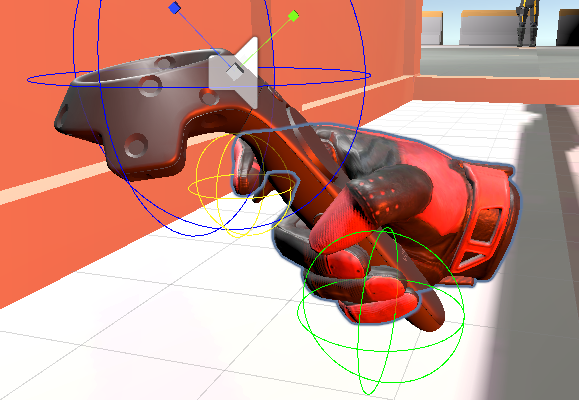

Hi All… I’ve been working in VR (hobby only, not my “day job”) using Vive 1.0 and Pimax 5K+ on the same pair of lighthouses. I didn’t know there was a Pimax Unity SDK… Generally I’ve found the SteamVR API to work fine. I only have one problem at the moment which is my hand models sometimes get “tangled up” and the model is all messy. Does anyone else have this problem or maybe know how to solve it? Thanks in advance! Attmepting to attch good and bad example images - note that if I build the app and run it on my Vive, the problem goes away.

Bad:
image2019-10-5_22-5-37
Do you build it specifically for Vive? If yes, how? Which headset configuration do you use on Pimax (FOV, parallel projection, supersampling)? Did you try different configurations?
I’m not building for the vive, I’m just using standard Unity settings, which are meant to work for all headsets.
As for the projection/FOV/etc., everything else works fine on my Pimax system - I can move around my scene and the game works (for what it is, which is a sort of tech demo) and I play games all the time, that’s fine. I think it has something to do with the SteamVR API inside unity talking to some aspect of the Pimax headset. Also, should have mentioned before: sometimes the hands disappear completely, leaving only controllers, no hand models. These are standard Vive controllers.
Maybe I was not clear, my question should have read:
Which headset configuration do you use on Pimax (FOV, parallel projection, supersampling) when you run your app and your model is trashed? Did you try different configurations and did you observe the same behavior?
Sorry, I should have responded in more detail.
  • Smart Smoothing ON/OFF : no difference
  • Parallel projections ON/OFF : no difference
  • Fixed Foveated Rendering ON/OFF : no difference
  • Field of View Large/Normal/Small : no difference
Sometimes, without changing settings but on exiting/entering the Unity Play Mode, hands disappear completely.
When I Build and Run the app, I see exactly the same behaviour as in Unity Play Mode.
My next plan is to upgrade SteamVR to latest although that can be a painful process. They changed something about the hands in the latest version.
Footnote: I upgraded (and for once it didn’t break everything!) - after generating input maps everything is exactly as before in SteamVR 2.4.5 with the exception that the physics they added to the hands is now a disaster becase the rapidly switching hand models means you can’t pick anything up! Your random fingers collide with any interactable object and push it away. So I had to switch off the Hand Physics script.
