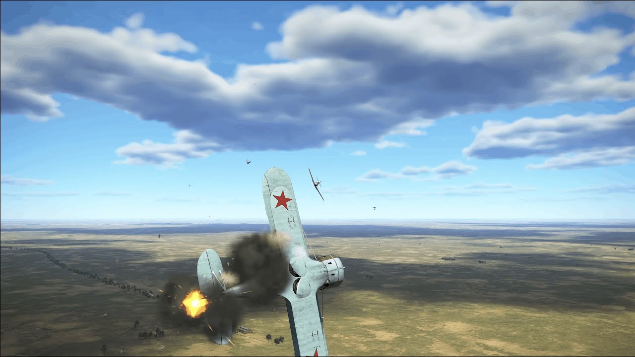

In fact, I would directly attribute my most recent feat of 8 enemy planes shot down in 1 hour while flying solo on the Wings of Liberty server to the Crystal Light. This is a true hunter’s headset.
