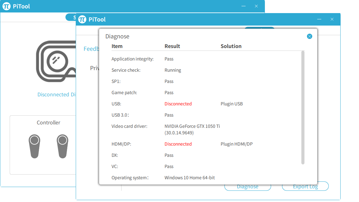

My Artisan doesn’t start. PiTool says DP and USB (2.0) is not connected, but it is. All three cables are plugged in.
What can I do? The headset is complete NEW, ordered and shipped from thze Pimax store. Di I have a guarantee?

Pimax shows only a red LED on the top and a green stripe on the front.
I don’t have base stations or controllers, only the Artisan (and NOLO, but not connected).

I cant go to Settings/HMD, because it says, the device is disconnected

Now I have unpluged the HMD complete, but PiTool says, that it is plugged in (USB 3).
Why can’t PiTool show me the right connections in real time?
