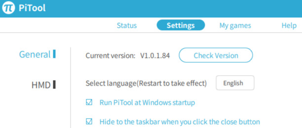

So I decided on one final step before getting into any games, and that was to deal with the PiTool Version I’d installed a couple of days previous. It was version 1.0.1.84
…and following watching SweVivers vid last night ( Pimax - We Have A Problem! Update fail, crashes & no motion smoothing? - YouTube ) I was aware of the potential issues with this version and the suggestion to downgrade to 1.0.1.76.

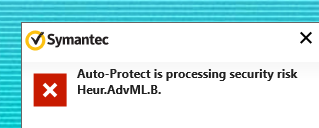

So I downloaded the earlier version, ran through the installer, dealt with the now expected AV red flags and got that part done. However, the HMD was not being detected. It was via USB but not via DP. I tried numerous things again… disconnecting/reconnecting cables, powering off/on HMD and PC, more disconnecting and reconnecting cables but no luck.
I upgraded back to .84 and it instantly worked, downgraded and failed. So maybe it’s a firmware thing although it’s said to be working for SweViver I’ve decided for now to upgrade back to .84 and all working again.

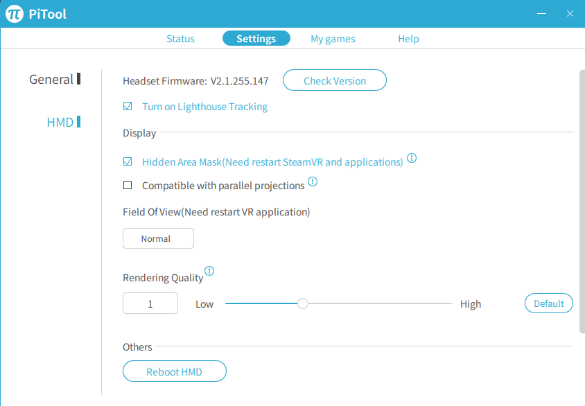

I had initially seen SteamVR home working so was surprised to see ED show a problem when it started up, the L/R eye view was massively out of alignment! Not just a bit… I decided to come back to this later! (EDIT: SOLVED: Check ‘Compat with Parallel projections’ option in PiTool… thanks @Zerenoth)

Overall I’m massively impressed, I know the software is still work in progress and I’m sure issues will crop up (such as finding out what’s going on with Elite Dangerous (EDIT: SOLVED: Check ‘Compat with Parallel projections’ option in PiTool)). But I love how clear it is, how much more detail can be seen, the image looks a lot cleaner and I’m sure there is more to be improved upon.
