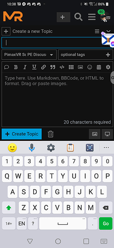

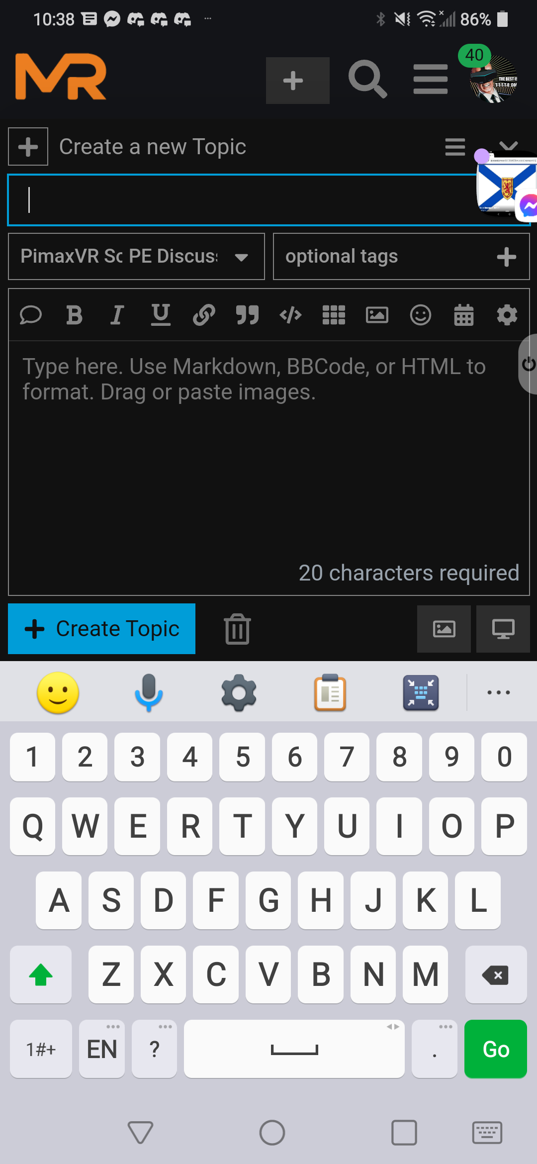

Not able to post this as a topic but I have a similar issue.

To post new topic

Excellent, thanks for the new post info.
