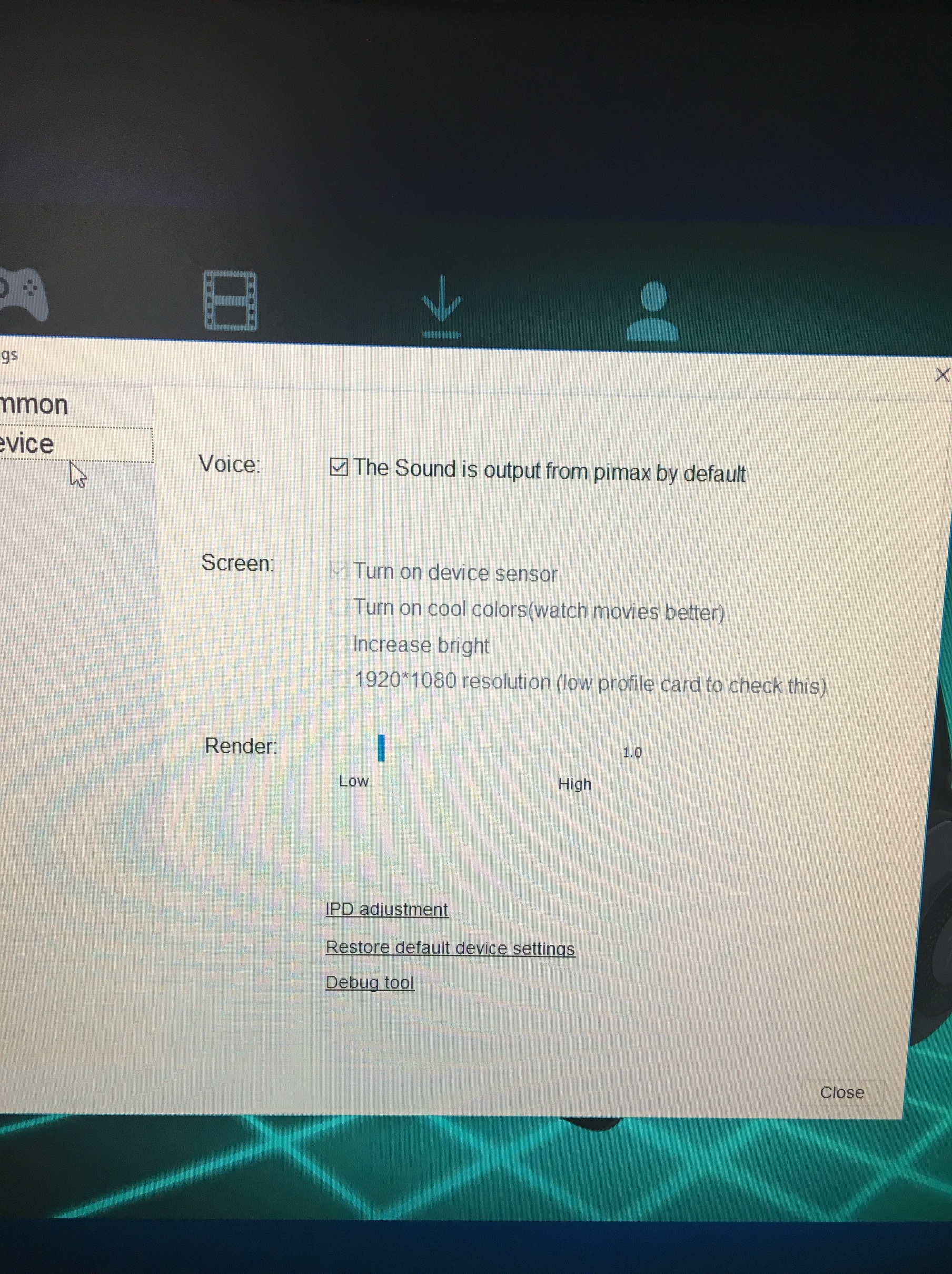

@Aneurism @Skindred are your options for turn on device sensor and so on also greyed out with piplay 1.2.75 ?
Yes, it’s normal.
In consideration of usability and convenience for new users, our engineers closed those options. I wil report this issue to them, maybe we will open them in further version.
Ah ok, thank you @PIMAX-Support[quote=“PIMAX-Support, post:19, topic:2172, full:true”]
Yes, it’s normal.
[/quote]
