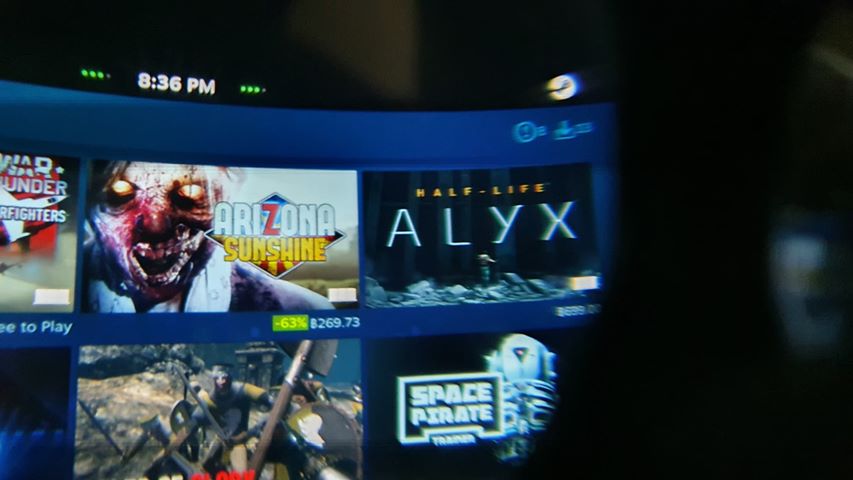

New 8K+ Owner - Visual Problem Difficulty Troubleshooting
Yes, I have tried this setting before…nothings changed. I have the same problem in Pimax Menu (this in space), so it has nothing to do with SteamVR?!
@twack3r Yes German, in Fulda…its 4 hours from Munich… My experience with shutter glasses was headache and the same feeling I have in VR. But the sight was clear.
Have you set SteamVR’s maxRecommendedResolution setting? If not, this is probably the source of the blurriness.
https://community.openmr.ai/t/solved-maxrecommendedresolution-issue-problem-with-pimax-8k-on-iracing/27411/2?u=neal_white_iii
Ok, Fulda is a bit far.
What ‘feeling’ are you referring to that you experienced both with shutter glasses and VR?
@neal_white_iii yes I have tried this before…nothing changed. this has only something to do with steamVR? Its the same for me in the Pimax Menu.
@twack3r Like I’m drunk and want to shut down my eyes.

Yes, this is only for SteamVR. As mentioned in the link, it’s possible that you’re editing the wrong file (which can be in different locations) or that the setting has been cleared. Are you sure the line you added is still there? Unfortunately, this is a SteamVR issue and Pimax has limited options for fixing it.
This setting is the most likely source of the blurriness, otherwise it’s probably a hardware issue.

The fact that you are having this problem even with just one eye open is… staggeringly unusual.
Only obvious thing I can think of is maybe the shipping carriers are severely throwing/dropping packages in your area? This seems like some soft of extreme physical damage having misaligned optical alignment.
But then, not having heard of that happening to one, much less two headsets in a row, normally I would suggest meeting a VR experienced friend in person.
Keep posting any information you can here, and people will try to help at least.

Hi cinemon, besides all the mentioned, have you tried getting one eye in focus by moving also up down? Sounds and looks a bit like looking to high or low or angeled at the lens from my experience. I took the velcroed cushion of the comfort kit, the head rest part made it difficult to get a good view on the lens for me ( forehead to large or what ever) It can just be pulled of and gives a bit more room for trying to get a good location in terms of eyes and lens. Angel and the hight also make a lot of diffrence for my perception.

First, Pimax headsets are not easy to wear and even people who otherwise would have no difficulty to use another headset may have serious problems with Pimax. This is related to the design with canted lenses and displays and an unnatural way the eyes need to focus. You may just face that.
However, if you had problems on Quest, which is otherwise pretty easy going headset, I would like to make sure that:
  1. You set up your Quest correctly - related both to your IPD and to position the headset on the face.
  2. You checked with someone else that your Quest did not presented the same problem for him.
If you can answer both points by yes, I would suggest consulting an ophthalmologist and specifically discuss the possible impact of VR tech.

This is bad brightness and blur when I use 259, but look better in 260 beta.
But my friend who use 2080ti , he told that 260 still blur although sampling at 500% and every fov get the same result.
And these are the the factor which make the headset to has more clarity. Try to test it to check that your headset is normal or not.
  1. Try to change power hub.
    I notice from this issue
    "The headset lose connection every 10 seconds ", I ever found this issue on my friend pc, but not sure what happened. You should try to test by using the 9-axis and if found that the headset still have wrong orientation. I think it is about power source.
  2. Try to decrease refresh rate to 72Hz, my friend tell that it has better clarity.
  3. Try to compare between 259 and 260 version
    https://pitool.pimax.com/PiToolSetup_1.0.1.259.exe
The 259 has wrong brightness, if you use 260 and it not better, I think you still have the wrong brightness.
  1. Try to use 144 version (he tell that this version has the most clarity, but image is not correct, fish eye distortion).
