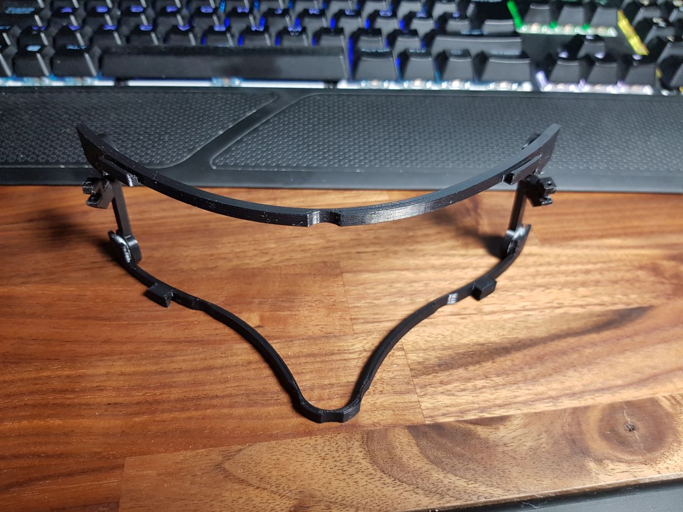

I’ve made my own solution for using prescription glasses. The solution uses three parts:
A lower part and a upper part that are clipped into the pimax. Both parts have magnets clued to.

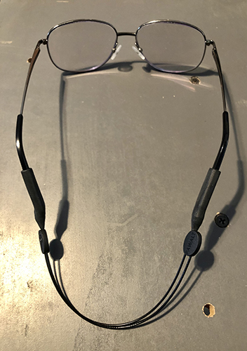

On these magnets the middle parts are mounted with other magnets. The idea was, the glasses can be removed without dismounting anything. It is not perfect but also not bad.
The other improvement is a solution to avoid lightleaking from the nose opening. I used this already with my 5k+ but because the 8kx doesn’t have the threads at the bottom anymore I had to redesign it a a little bit.
This consists out of 2 equal parts. Both have magnets inside, which were put there during the 3d-printing. Between these two parts a “Buff” (www.buff.com) or something similar is put and clamped by the magnet force
