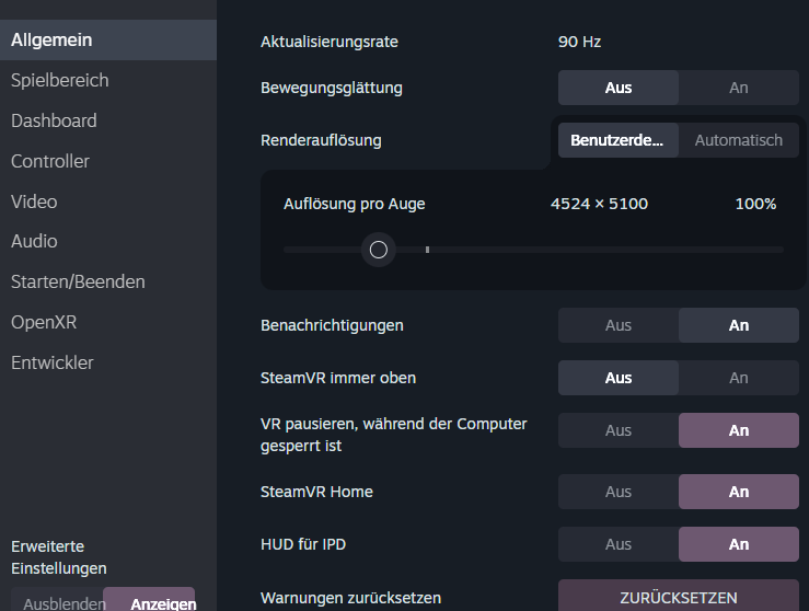

I remember before when setting Crystal OG to supersampling in Pitool and SteamVR booth 1.00 (100%), then my resolution was 4312x5100.
Now is 4524x5100 ? Why?
PS:Now I use pimax Evo
This is Pimax EVO issue! I went back (clean install) to Pimax 1.43.7 - there resolution was as always 4312 × 5100.
In Pimax EVO my resolution on SS=1 is (again after clean install) about 4524x5100.

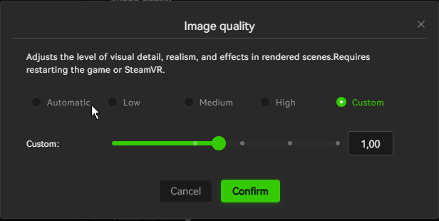

Just to confirm, is your image quality setting set to Custom – 1.0, rather than the preset High setting?
The testing team has provided the results.
Using both EVO and Pimax Play 1.43.7, with image quality set to either Custom – 1.0 or High, the SteamVR resolution was 4312 × 5100.
For booth is same in pp 2.0…

I use always additional IPD correction +1,3mm per eye. In the past that change never influenced my horizontal resolution, but with latest EVO and PP 2.0.2 my IPD correction makes horizontal resolution bigger (exactly 40pixels per +1mm per eye).
Is that intentional? I do not like it, as it affects performance.
Ahhh, yes! How could I forget this…
Changing the offset also affects the resolution.
