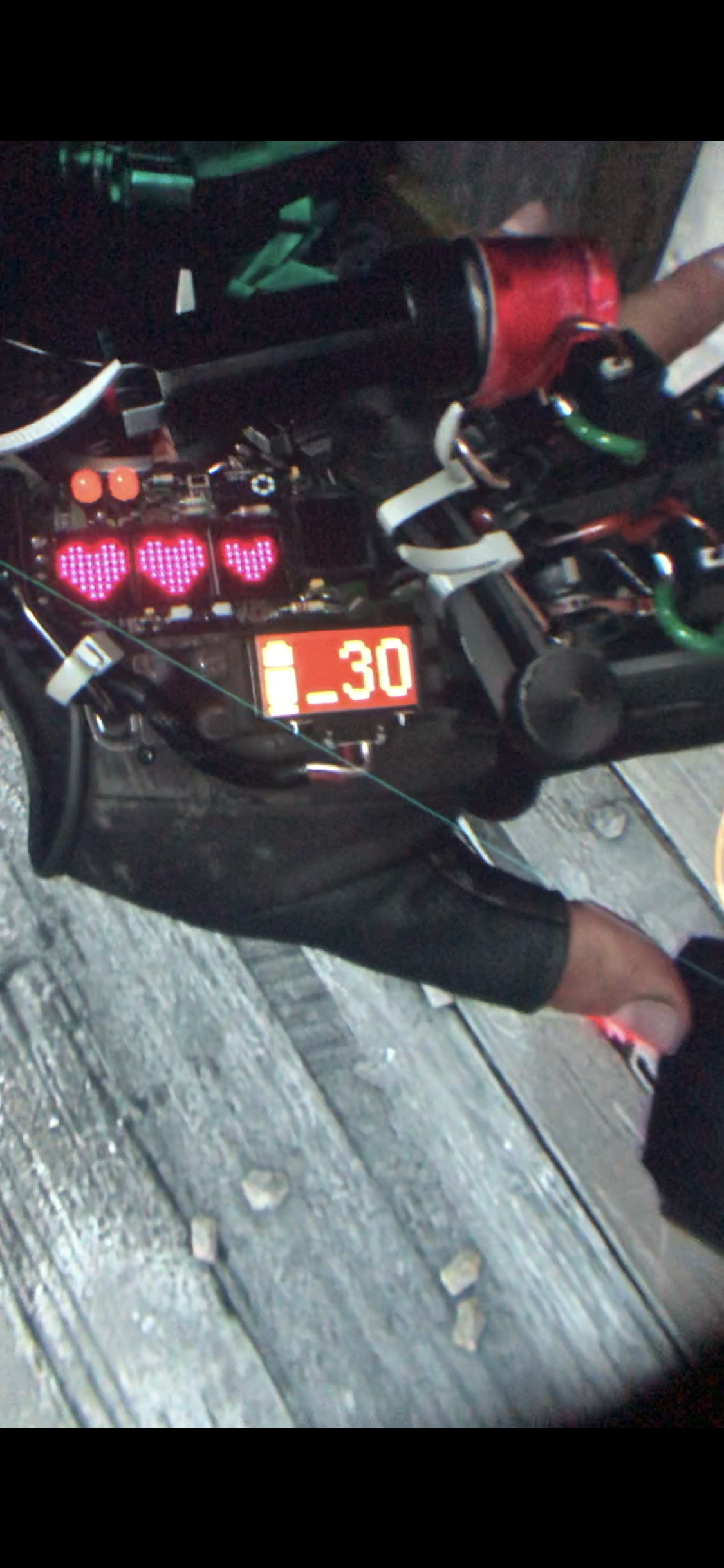

The above image is a screen grab through the lens of my lens modded wireless Vive cosmos.
I know it’s not an apple to apple test and I’m only using my iPhone but thought it would give an idea of colours etc.
This is a grab from Sebastian G2 footage.
That’s with the gear lens mod I presume , given that the cosmos can work with wireless it might be a consideration to upgrade my vive pro , Is it possible to get eyes close to the lens ??
Hi yes It is the colours are fantastic way way better than an index. Yes you can I ordered a set of pu leather face pads from AliExpress for £6 and modded the front cushion the difference is night and day to the fov. The wireless cosmos (modded) is very underrated.
Have you compared it to a modded vive pro ??
Hi I never ordered the Vive pro but have read good things. The barrel fish eye distortion and scale problems are not present with the latest adapters and a cosmos. I wish MRTV could test it or more people could try it because it’s very good as Sebastian’s would say.
If you get any eye strain / discomfort from the lens mod , I found adding a thin strip of double sided tape to the peripheral edge of the lens adapters fixed it for me
Good suggestion thank you I haven’t had the issue thankfully I was fully expecting it but all good. My daughter uses it daily and has never complained either. :0) I wonder if they have altered the angle of the adapters to compensate?
