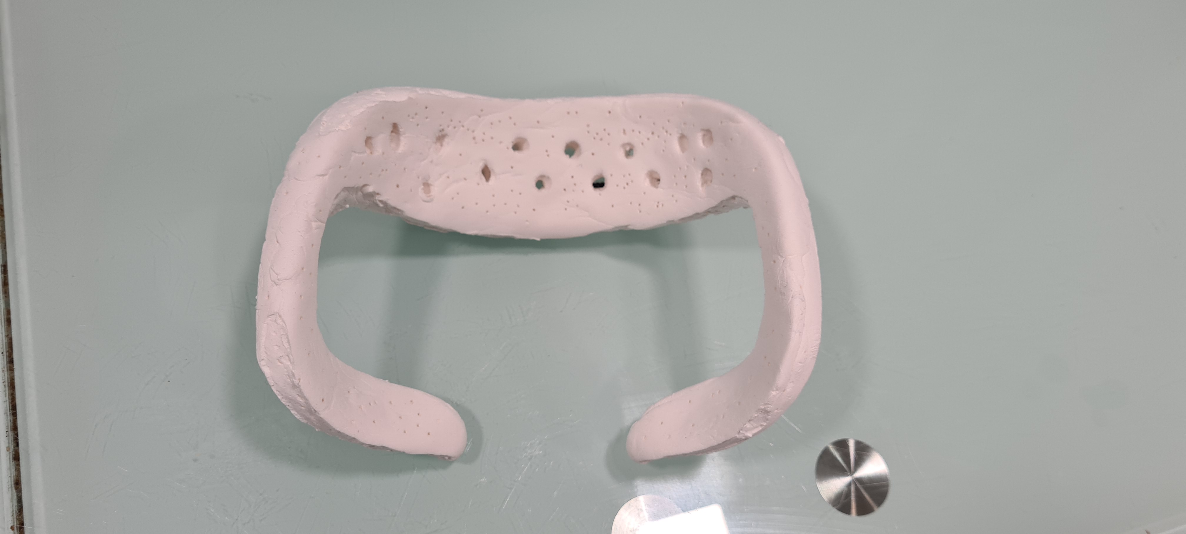

After making a hard clay/foam that works as per what you said may need to create a new mold or perhaps a 3dscan of the piece you formed and decrease the thickness of your hard insert and 3dprint. You could then use pimax foam or cut foam gasket to attach via velcro for comfort to attach to your facial adapter.
I just made the second unit, pressing more towards the lenses and to the sides, giving it the necessary slack so that the foam layer and the fabric fill that distance. This time it was white, although they were of the same material, it took about 3 days to dry completely, I even put it in the microwave to remove the moisture from the putty, but it has to be at minimum power, as if you were defrosting bread, why else it swells and explodes,
. It is still a very light and flexible putty but it is true that the touch on the face is hard. But the soft foam layer and fabric make it feel great.
But I think the V3 will be taking advantage of the plastic and vercro base of the original foam, it can even be detached without breaking it.
So the idea would be:
Separate plastic and foam from the original Pimax (the 11mm thin foam).
-You put the plastic with velcro in the comfort kit
-You put an abundant layer of putty as we are used to,
-You put the foam that you have taken off on top.
-You crush your face to the ideal position of vision
-You let it dry for 3 days, or you can try to speed up the process in the air and in the sun.
-Then it only remains to trim the excess of putty and I am almost convinced that the 3 parts will already be joined without the need for contact glue.
In this way, as soon as the mold is made, you can remove it from the conford kit and it will maintain its shape while it dries. And you donât have to have the Pimax âhijackedâ one day before you can remove the putty.
I think this streamlines and makes the process easier.

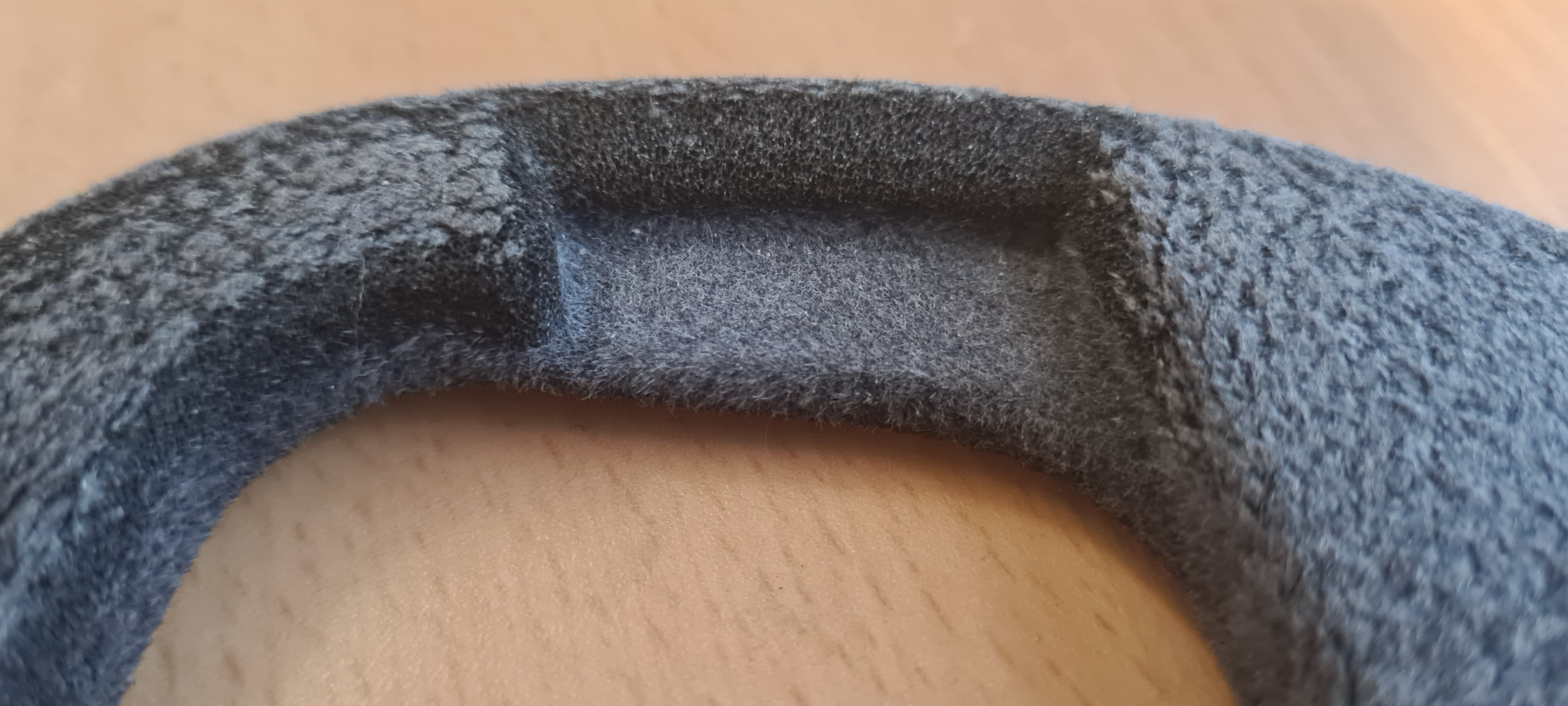

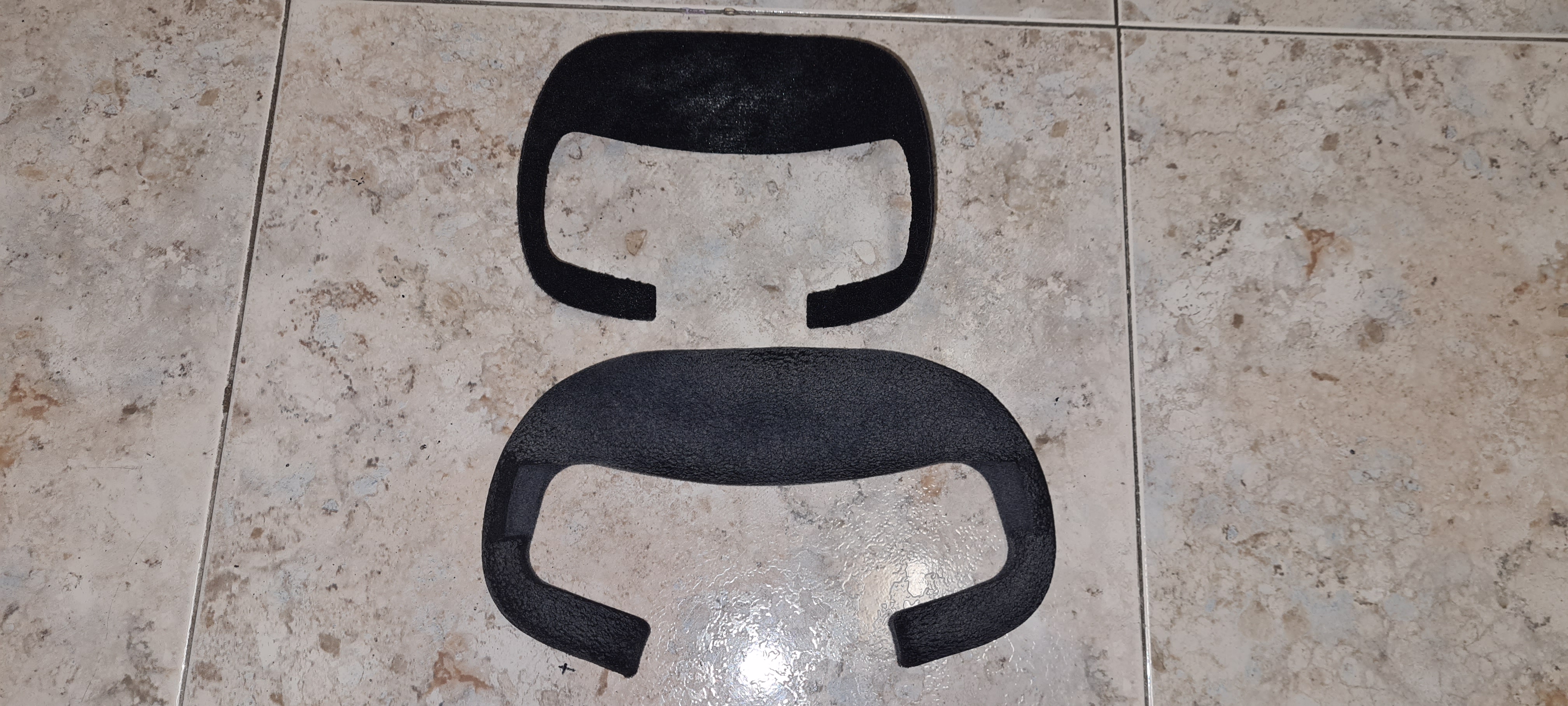

Hello again, as they say, the third time lucky(at least in Spain). This time I used the velcro plastic part of the original Pimax thin facial foam as a base. It was worn out and I wasnât wearing it, it needed too much thickness for me. As I also have the original thick foam, I stick with that one.
So here are the steps:
We separate the foam from the plastic:
We add the âmagic puttyâ on the plastic with velcro, On the inside, where we have removed the original foam. And put soft foam on top. I have used this time, the one from a gymnastic mat, but this is quite soft and cheap. ⏠10 2x1 meter.
You place the sandwich in the Pimax and put it on, tighten until you get the ideal vision and you can take it off, remove it from the comfort kit and let it dry.
As a recommendation, after one day of drying, I removed the mat foam to facilitate internal drying. And I was also able to verify that I needed very little putty to fill in the gaps in the shape of my face.
When it has completely dried, do not be impatient. I have left it for 3 days, you can rejoin the foam and the putty / plastic / velcro mold with contact glue.
We trim the excess and sand a little around it.
We cover it with thick, soft, resistant fabric and if it is elastic, the better.
I have used the same type of cotton thermal shirt, but in black. Glued everything with the same contact glue, but applying glue on both sides to the entire edge so that the union around is instantaneous and resistant.
The result, in my opinion, better than the original facial foam, it will not wear out in a short time, it is soft but has more consistency and since it has the exact shape of your face, you do not need to apply any pressure to find the optimal point . You put it on and everything looks great, just a little tension on the rear nut of the MAS so it wonât move, but no discomfort. This time I think it is the final one.
I have managed to find the balance between, simplicity to make it, quality and comfort. All looking very professional.
