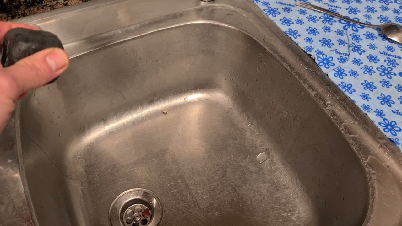

And another of what happens if you wet it, roughly. I see that if the surface layer is soaked in water it tends to dissolve, staining the hands. But I think I have passed the test. The most convenient thing would be that the foam is isolated from the outer fabric to prevent sweat from seeping through and dissolving material from oozing through the fabric. But I think that once the product has completely dried it will not turn into a misshapen dough like when you take it out of its packaging. I believe that the recommendation to wet it when you work it is when it is still soft but begins to lose its elasticity.
I know all this is very freaky and I laugh with all these experiments, but I will get to my purpose. I just want to encourage people to try to experiment and improve this idea so that we get to create an ideal foam and have no further problems.

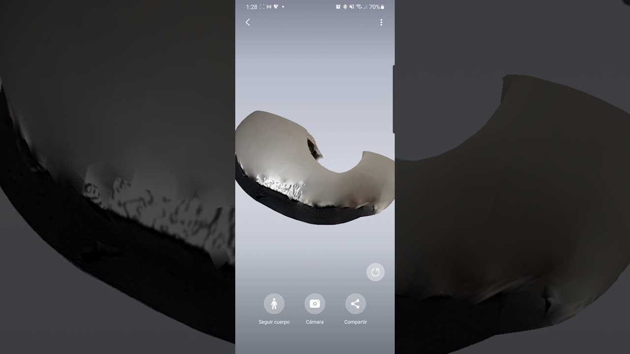

Once I used this SW, and I managed to reproduce a part of the piece that I wanted, but not all. A bright and uniform environment is needed so that the images taken are centered on the object to be scanned. I just tried it again, but it is not the most accurate I have seen.
Here are some phone aps
I just tried the apk that my S20 + “3D scanner” brings and I can’t believe it:
Now I have to see how it is processed in CATIA V5
That’s really cool!
This way we could use the putty to create a custom literal facial interface, scan it with an app, export the scan and have it 3D printed with memory foam filament!

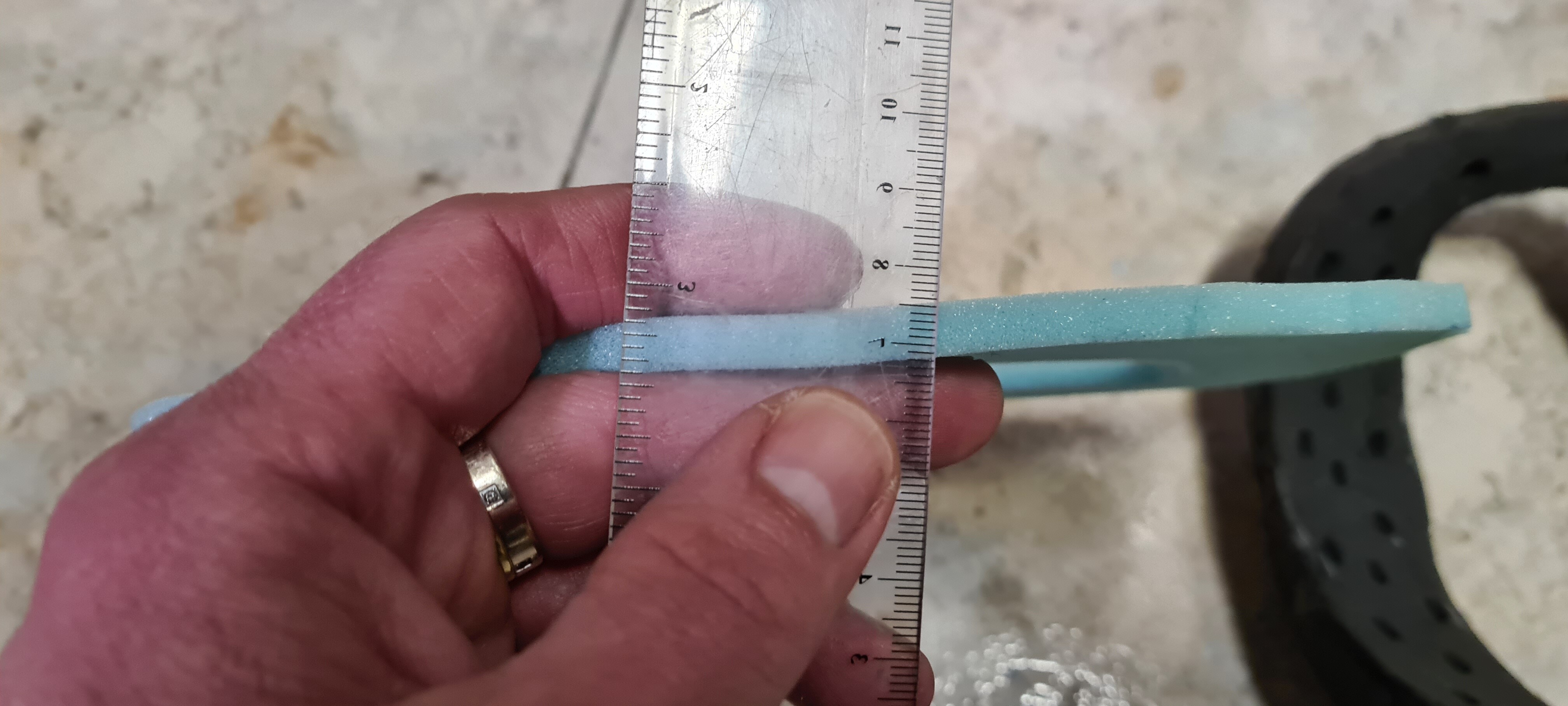

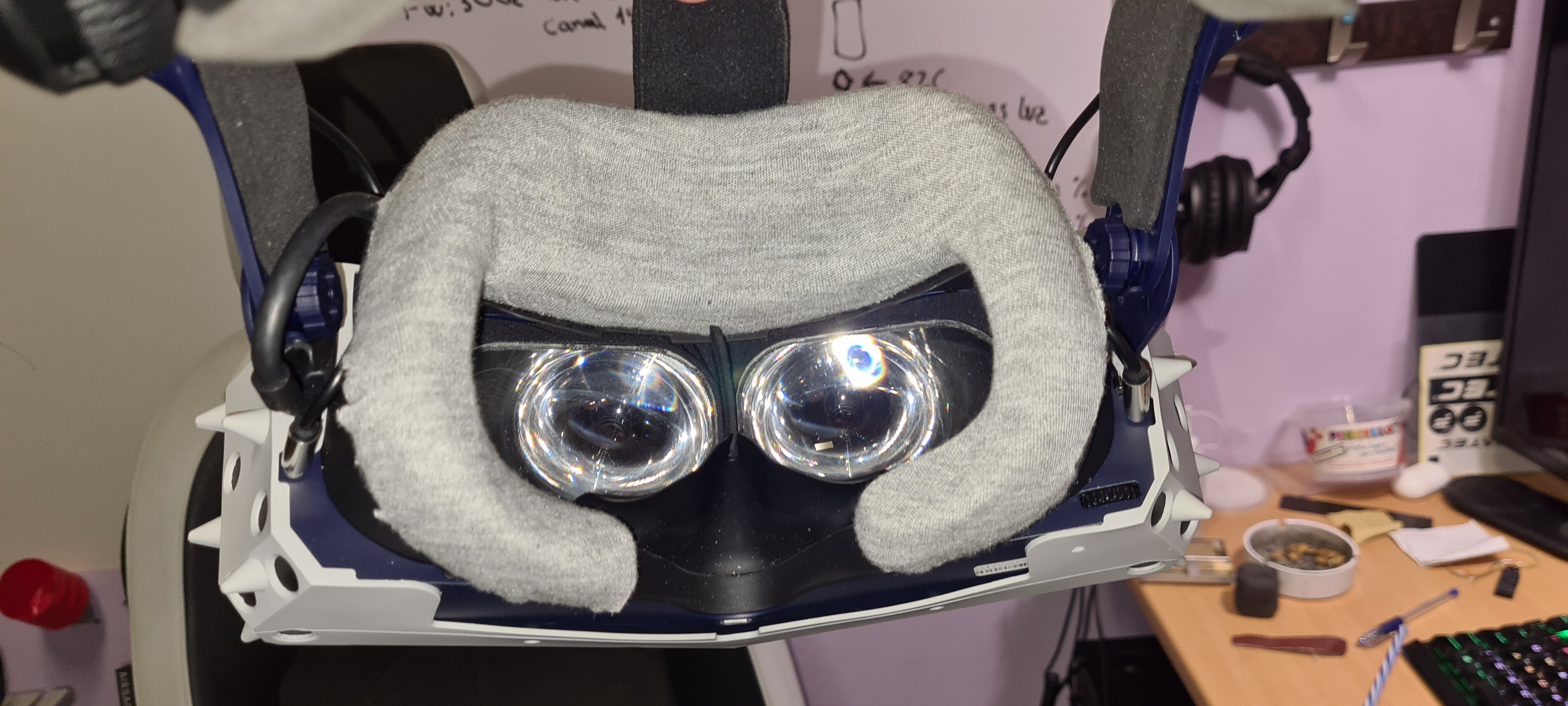

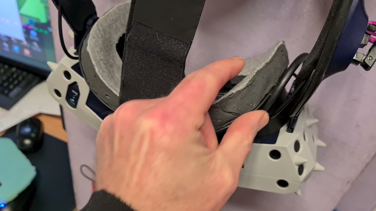

I have emptied part of the foam by making holes with a soda straw of those that are rigid. Then I have sanded it to give it a more rounded and porous finish so that it allows a better grip of the glue. This time I have used contact glue applying only on one of the faces. I have added a very soft 5mm foam. And I have covered everything with the same cotton thermal shirt fabric. One with a darker color and nailed to the Index.
Now the result is spectacular, just adding that that extra thickness makes you need to squeeze the MAS a little, I hope that everything will give way and little by little you do not need so much pressure to obtain the entire field of vision, now it becomes very blurry on the sides , lack of proximity to the lenses.
What impressed me more every day about this light molding foam. It gives a lot of play in the creation and it works very well. But I have noticed that when punching the holes it was still a little soft on the inside, so the holes fulfill 3 functions: 1- Softer and more elastic, 2- less weight, 3- help to dry the inside.
For those who are going to start doing it @Strydr, when you press your face against the putty, spend a bit, I would say that almost your eyelashes touch the lenses, so then you compensate it with a thin foam coating, before covering it with the cloth.
And as a much better glue, contact glue: Contact glue
Now I think that nobody is going to laugh at the result, everything is more polished and evolved:
