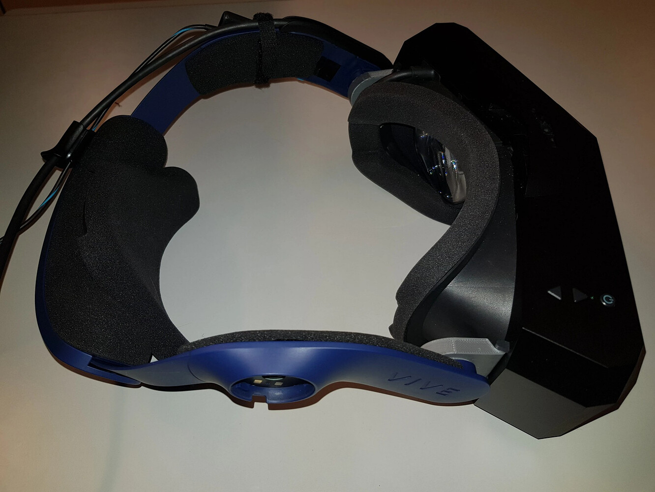

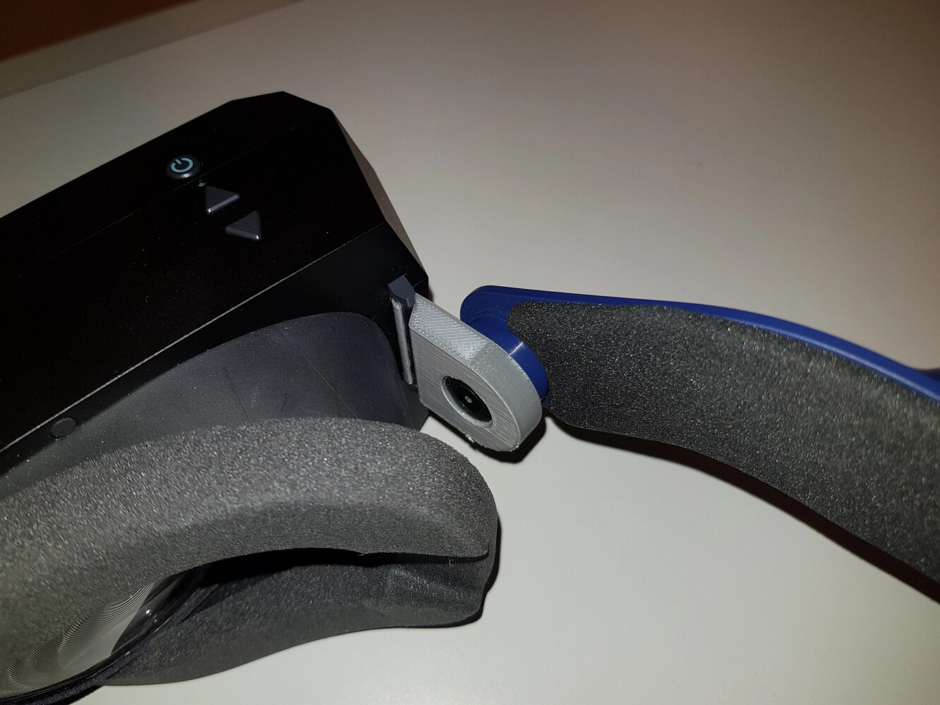

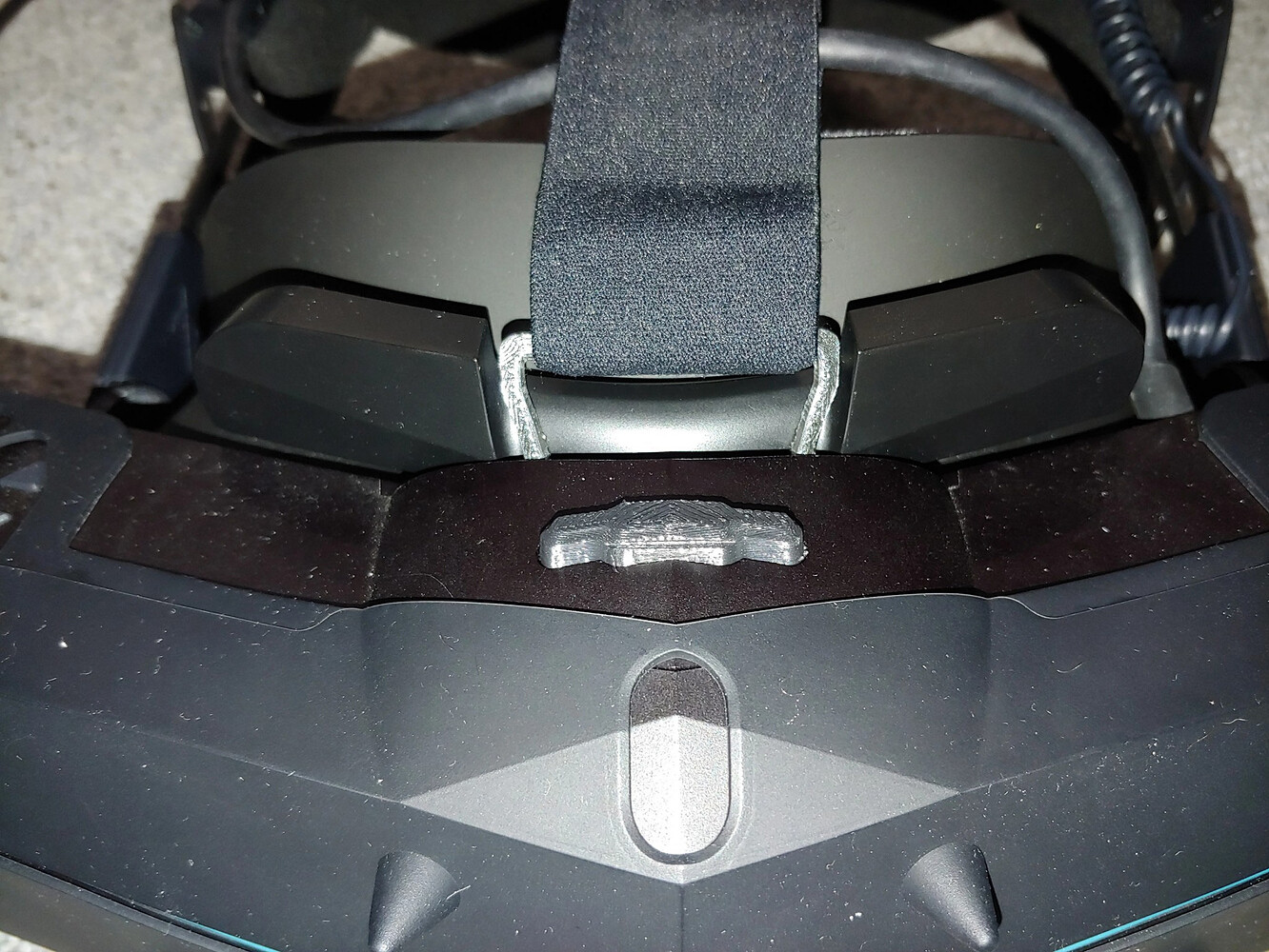

A) Menithal * Top Clip & Hinges - Oct 2018
Originally Made for the Pimax 5K+/8K Headset using measurements from @UnholyBeardedOne at Pimax Forums, and ‘image-reverse engineered’ from video stills frommixedrealityTV and SweViver. Not all measurements are done with a caliper.
This Refined version is improved upon using materials that come with the Pimax.
https://www.thingiverse.com/thing:3167993

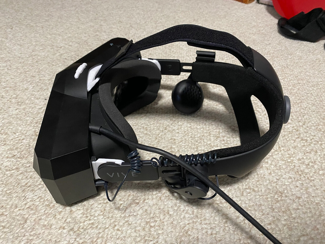

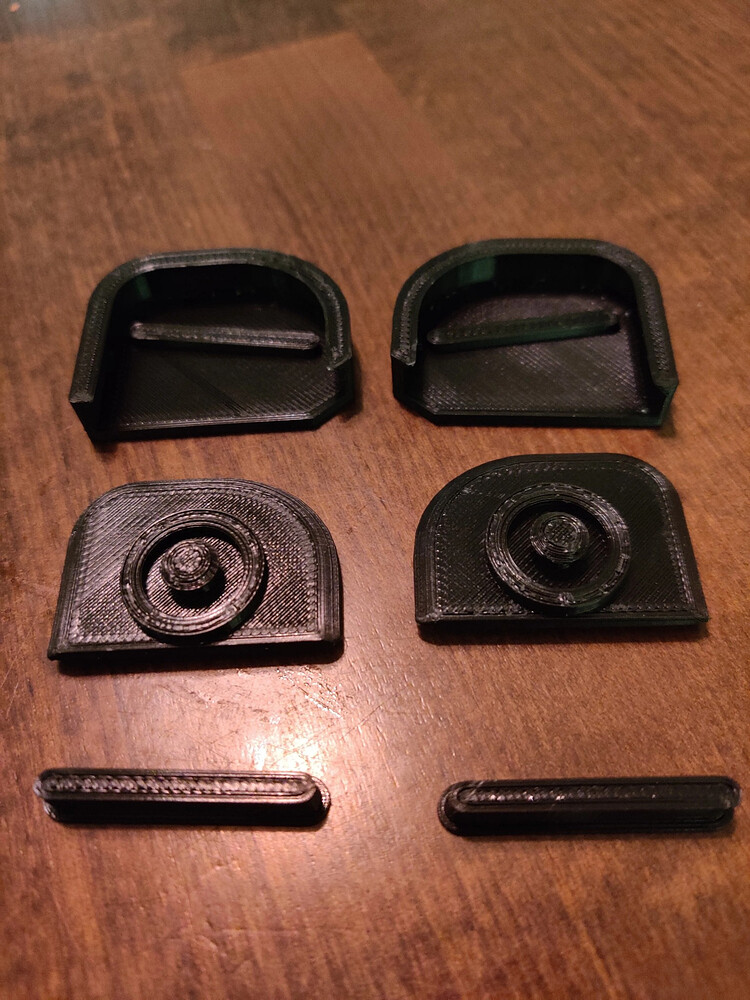

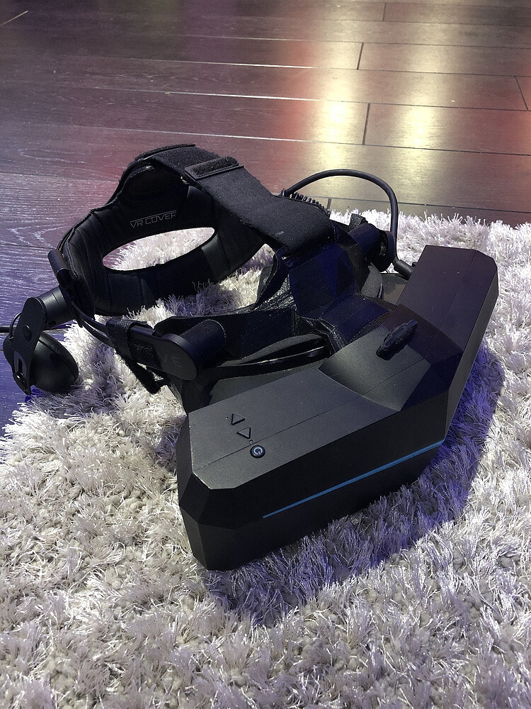

B) DrCube * Top Clip & Hinges - Dec 2018
Hinges and clip to allow you use your Vive DAS with your pimax 5k or 8k. There is a shorter and longer version of the side hinges depending on the size of your head. No supports required for top clip
https://www.thingiverse.com/thing:3285729
1. Tighter Fit Hinge Adapter
Apr 2020
By: Spdqbr
After printing the most excellent “Pimax + Vive DAS Adapter” by Drcube, I had trouble getting a tight enough fit for more vigorous games. This part simply takes the “DAS_Adapter_Short_Sideways_Printable_A” part and moves the pimax attachment point in, to give about an extra inch of tightenting room.
You will still need the rest of the parts fromDrcube’s adapter
https://www.thingiverse.com/thing:4274101

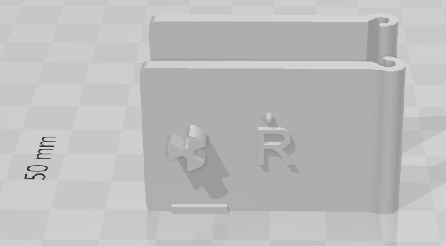

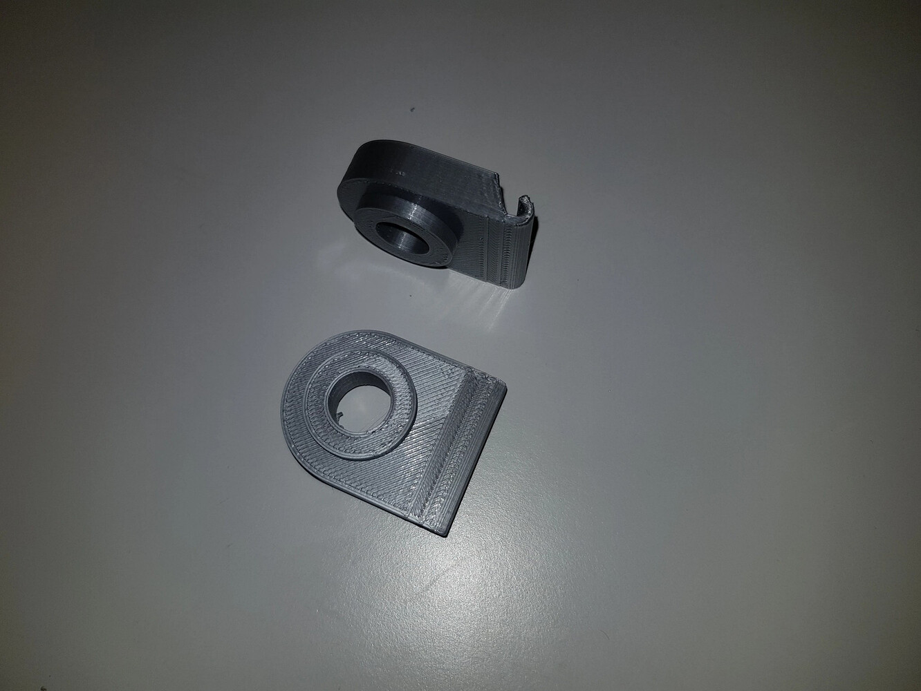

C) g_code3d * Slide Over Hinges - Feb 2019
Pic Version v2
This is a remix of DrCube’s Pimax + Vive DAS Adapter(used DAS peg portion), but instead of removing the Pimax hinges, these pieces slide over the hinges and use the strap loop as a locking pin cutout.
https://www.thingiverse.com/thing:3444424

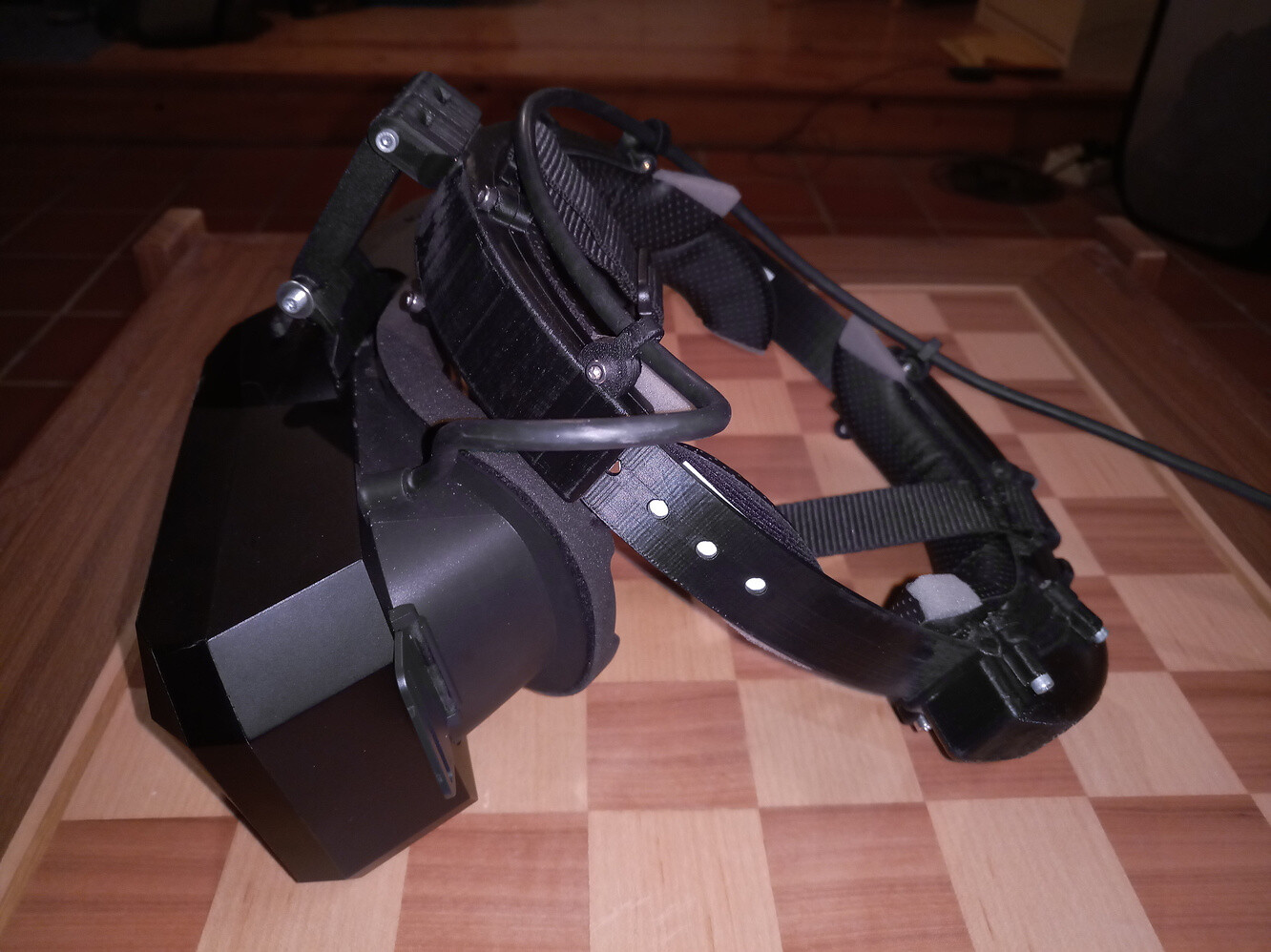

F) Yengalvez - Super DAS Mod - Dec 2019

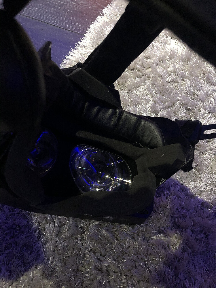

Finally, I finished my headband mod version. As you can see the weight is on the forehead, and not in the face. It makes that you don’t feel like you wear glasses.
You will need some foam to finish the headband and make it comfortable :slight_smile: See pic above.
This Velcro it’s necessary if you want to attach it to your face as near as possible.
https://www.thingiverse.com/thing:4073140

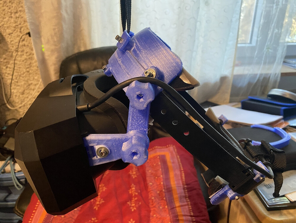

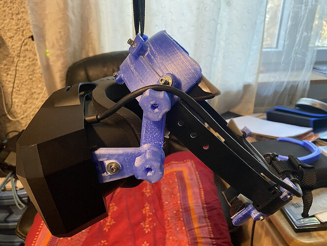

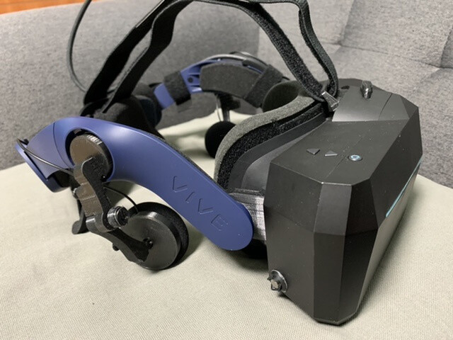

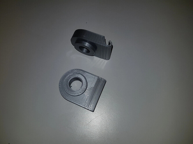

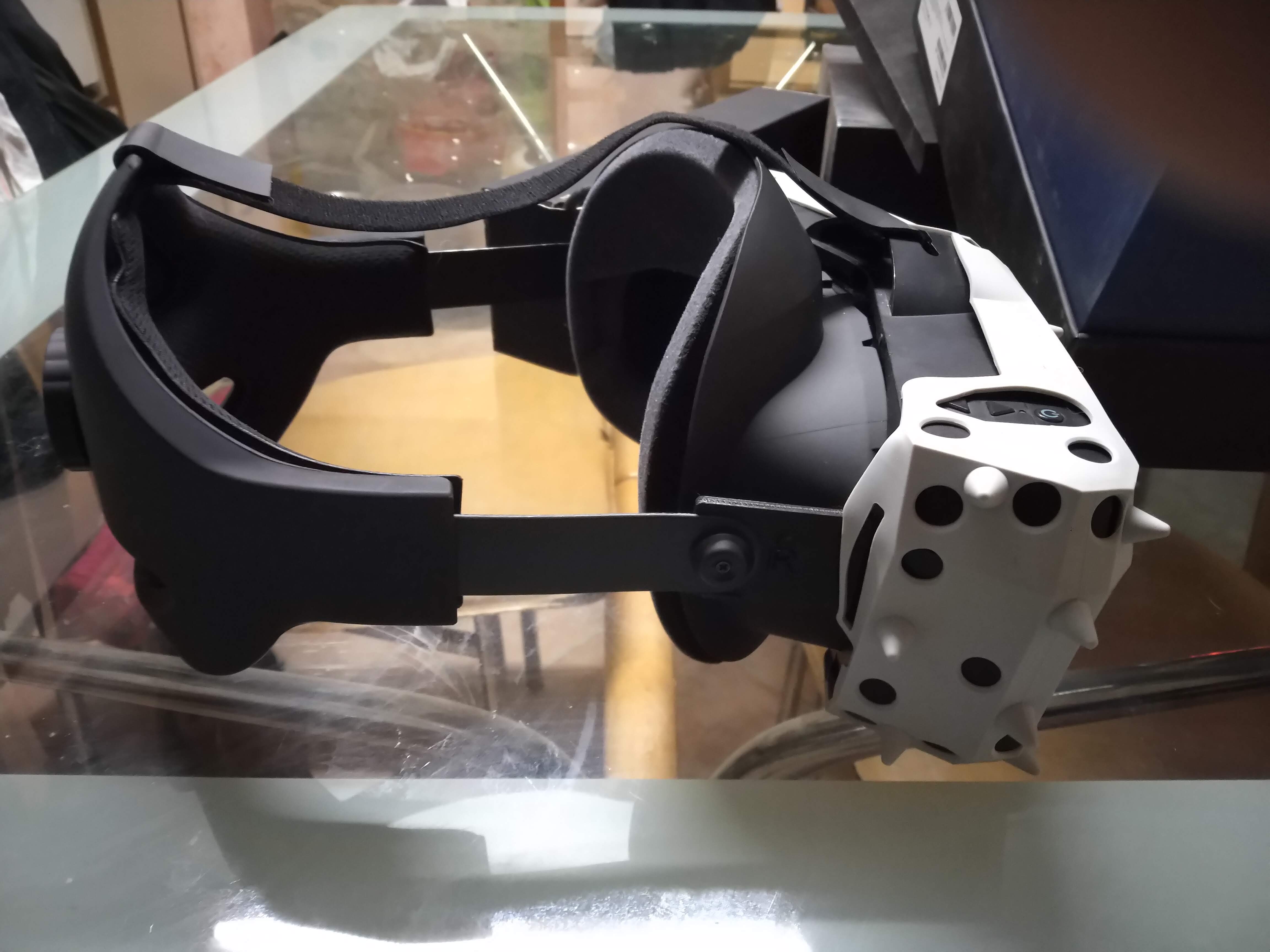

2. Vive Pro Strap Adapter
Date March 2020
By mathias_delahaye
This part is an adapter between the Vive Pro / Vive Pro Eye harness and the Pimax head mounted display
https://www.thingiverse.com/thing:4198341
ShawnMayer Print with Koss Headphones
March 2020
I complete my Pimax Artisan with Vive Pro Strap using this adapter and koss ksc75 headset
This is really comfort and koss ksc75 sound is really great.

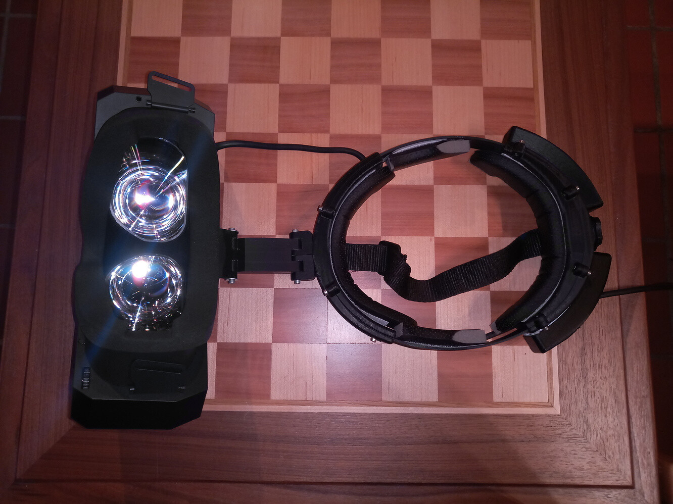

3. PSVR Headstrap Adapter
https://www.thingiverse.com/thing:3526859
Date March 2019
By: @Virtualmisterl
I took a headstrap from a broken psvr & created a headstrap adapter which has at least some adjustment on all axis.
you can move the whole headstrap up & down, you can slide the hmd in & out on the psvr slider & it can also be tilted up & down on the hinge..

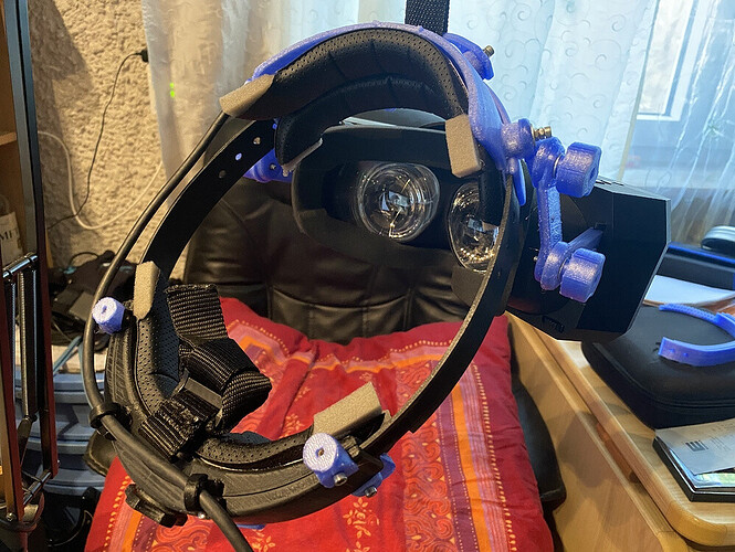

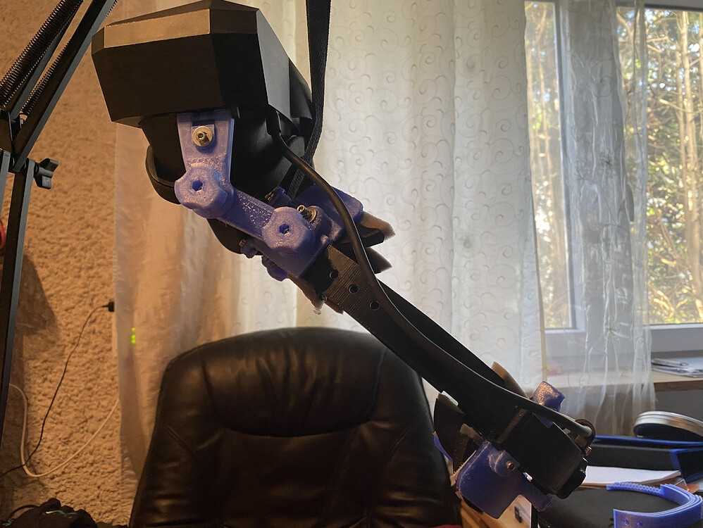

4. Custom Ridgit Headstrap Flip up able
Date Nov 2019
By: @Nid
Because I had problems with the fit and the weight balance of the standard headstrap, I designed a 3D printable headstrap:
I should mention, that I’m able to flip the HMD up, so I don’t have to take the headset of, when I want to check something on my PC.
V1 Design
V1 had too much Wobble. So V2 attaches from sides.

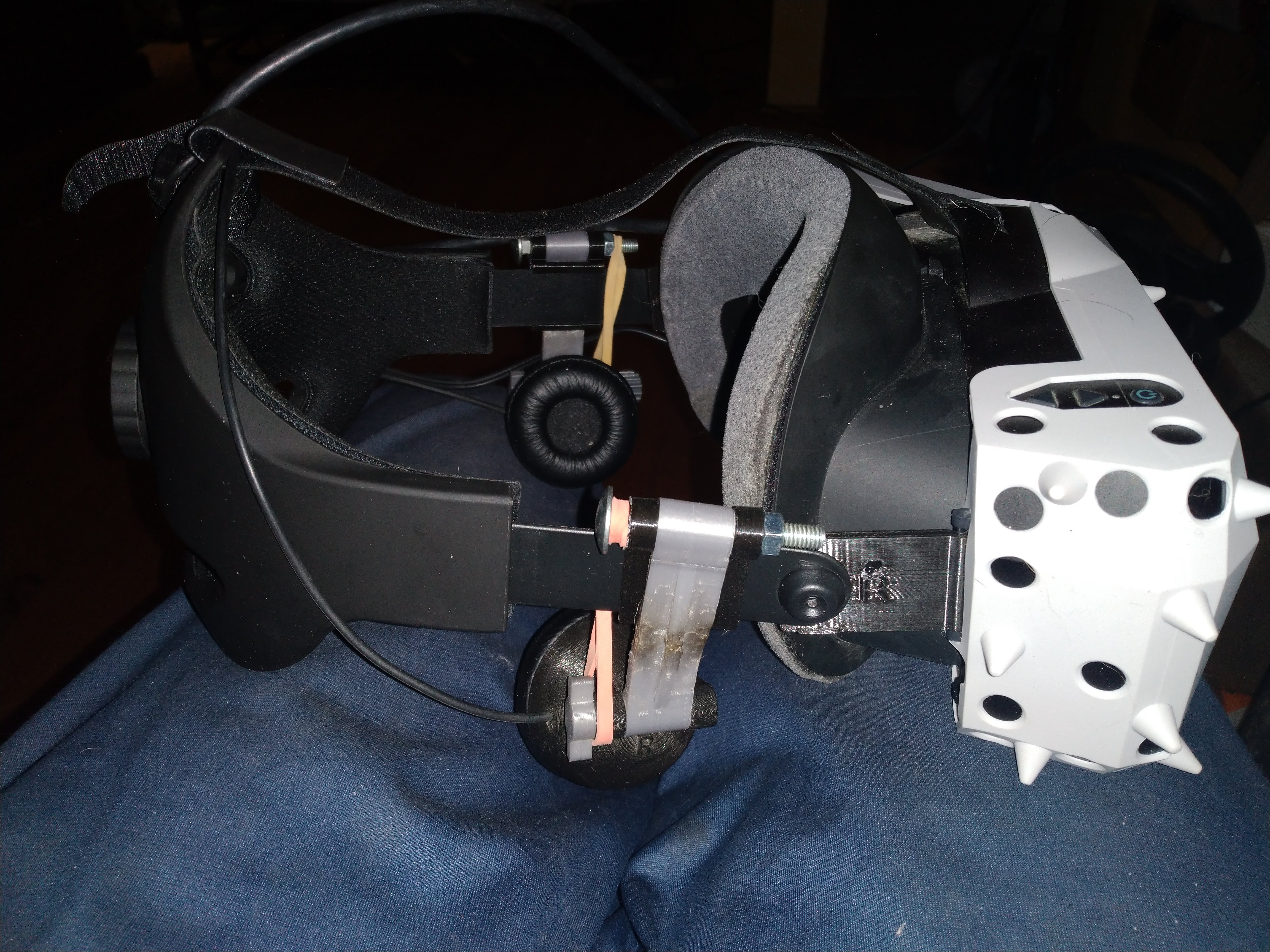

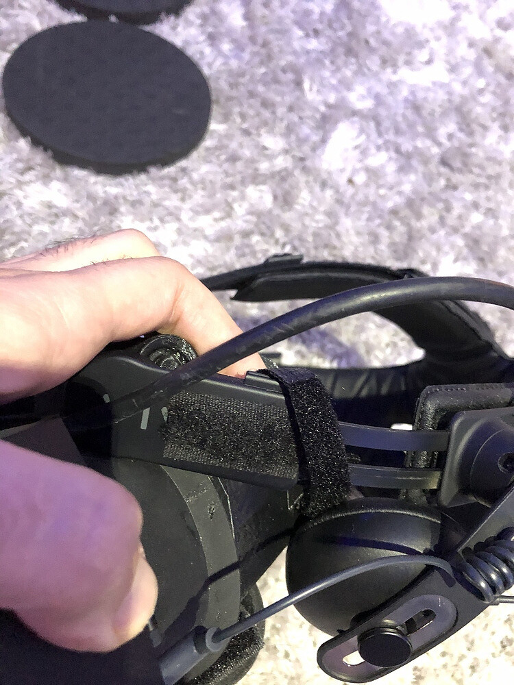

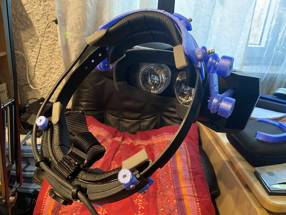

5. Quest 1 Strap Adapter With Custom Audio.
As I shown yesterday on another thread I got this headstrap made for Quest 1 on AliExpress
https://aliexpress.com/item/1005001562458200.html?spm=a2g0s.9042311.0.0.27426c37P6KO7t
I printed some hinges to make this fit
And it was great, confort is outstanding lol
so I had to add it speakers, I used the one I had on my previous Gambling Apps Philippines - find best best betting and casino apps
and voila :
As I noted in the post, I used drivers from cheap AE headphones and the sound is amazing, if the DAS as a 7/10, KDMAS a 7,5/10 (because of huge bass) this one is 10/10…hardly can be better.
Rubber bands are for maintaining pressure on the ears.
I will pack every files and put this on Thingiverse in case someone want try it out.
https://www.thingiverse.com/thing:4669418
