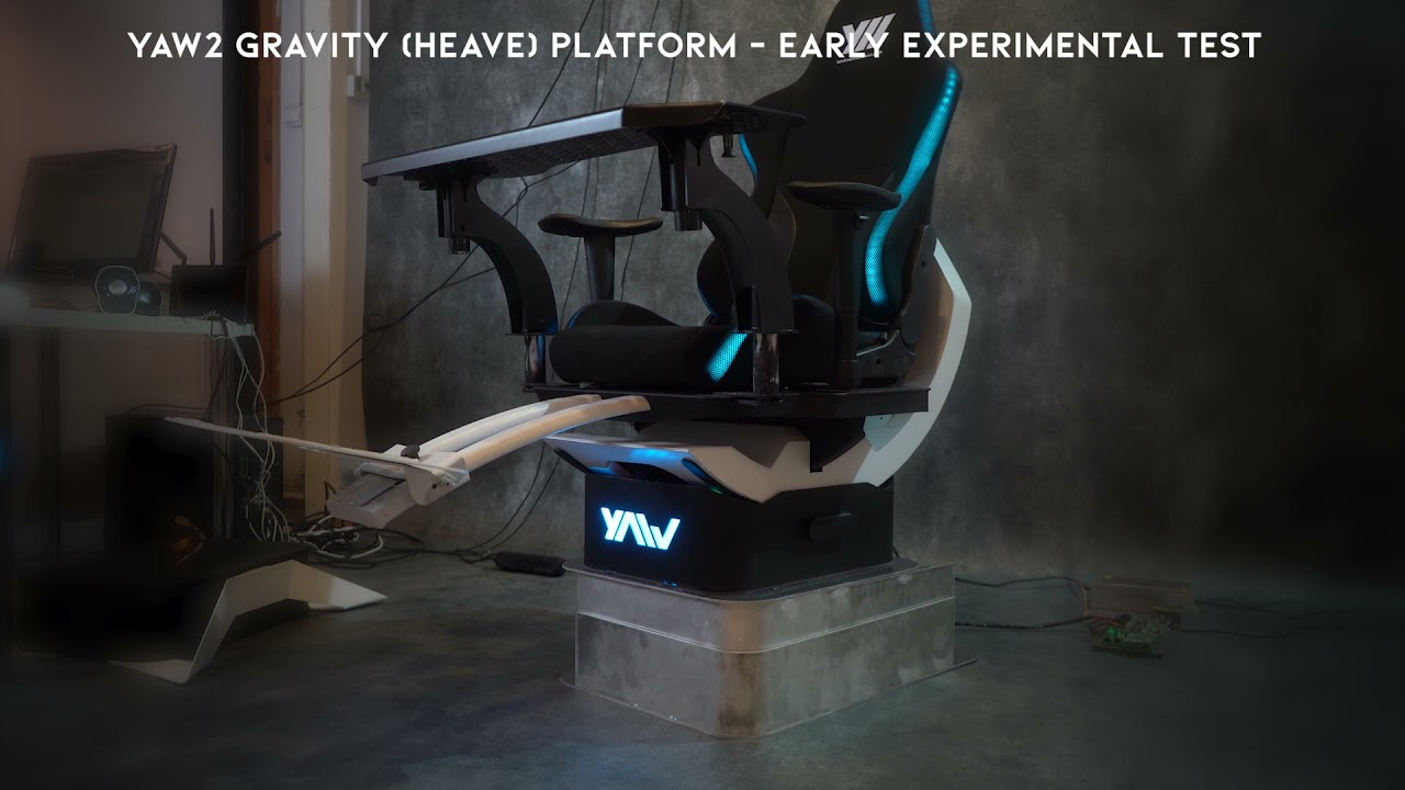

If you had to choose heave vs yaw which do you think you would pick?

Heave vs Yaw do you mean 6dof vs 3dof? Because IIRC heave is up/down movement.
