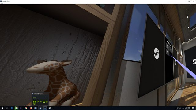

What we see in steamvr home, is a laser coming from our headset (a pimax and an oculus go) when driver4vr is on and leap option in driver4vr is on.

I do not see my hands. Again, There is just this line in the center of the headset , like my hands are at the center of my headset.
