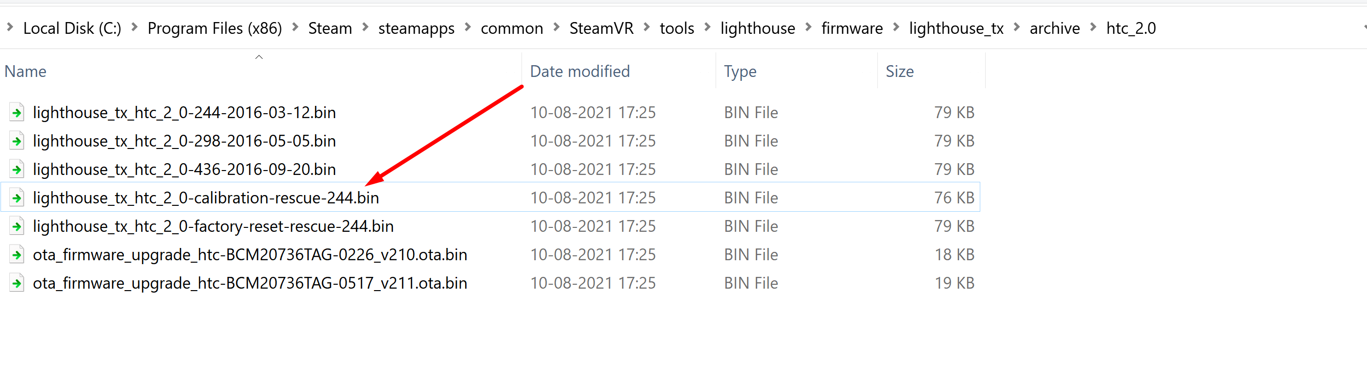

Well, I just tried something out now with that firmware thing by following a post on Reddit which I shared below and noticed when I remove that firmware.bin file and replace it with lighthouse_tx_htc_2_0-calibration-rescue-244.bin which I found at the path below
C:\Program Files (x86)\Steam\steamapps\common\SteamVR\tools\lighthouse\firmware\lighthouse_tx\archive\htc_2.0
And by following the process I just replug the power cable then there are no lights blinking it’s like nothing is happening and it stays in completely off mode, no motor vibration also so again I just connect the micro USB cable and then hold that back button for 5-10 seconds to get into that base station drive and check which file is there now and it’s the same which I deleted earlier firmware.bin but fortunately before doing all this process I took the original file backup which was having the same name firmware.bin so I just deleted this one and pasted the original and plug the power cable and Base station turned On again like before but with the same issue.
The confusion is what exactly happened when I replace that original file firmware.bin with lighthouse_tx_htc_2_0-calibration-rescue-244.bin :thinking:
Anyway, these are the list of file I can see in that folder shown in the screenshot below so I will try more with other files also to see what Impact it make.
Just an update FYI, I tried all the files which have lighthouse_tx_htc_2_0 from the folder but none of them were even able to turn on lh2 so I put back the original file again and it’s turning ON there so got a thought in mind now to get that firmware file from working lh2 and try it on this non-working lh2 but other mind says don’t even think about it otherwise you have to activate the 9-Axis Tracking mode in Pi tool :joy:

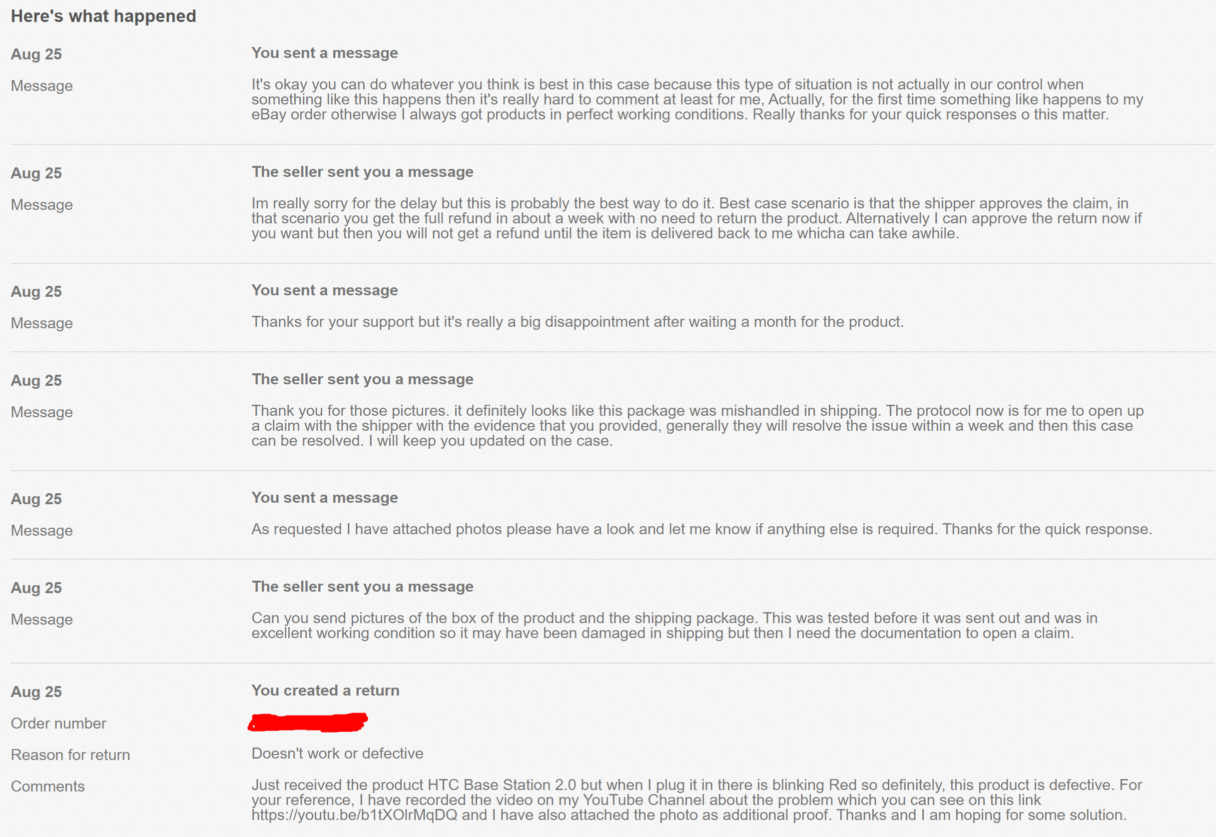

Actually, the unit I bought from that eBay seller was barely used one but I still created a return request even though that seller clearly mentioned there was no return accepted and after my request and all supported photos of the shipping and product box sellers got convinced that this package was mishandled in shipping and he opens up a claim with the shipper with the evidence that I provided and he also said In best case scenario if the shipper approves the claim, then I will get the full refund in about a week with no need to return the product. Honestly, I didn’t expect that I will get any good response from that eBay seller but the way he responded to my request and working on it is really commendable but still, I don’t think that shipper will approve any claim made by the seller but let’s see what happen next :crossed_fingers:

Well, check the screenshot below this is what happened between me and the eBay seller yet and what you said I just give a thought on it and you may be right because the seller immediately agreed that it’s happened because the package was mishandled in shipping just by seeing the photos which I sent to him. Maybe some kind of tricks by eBay sellers doing these days to provide refunds to buyers from shippers for their faulty products by making a reason of package mishandling. I will wait and see what happens next and what that seller does from now on otherwise will always have the option to involve the eBay support center in it however I have never been in this type of situation before with any of my order where I need any help from eBay support center so will be a good experience to understand how eBay to support center handles such matters. Thanks for your time and straight to the point responses mate

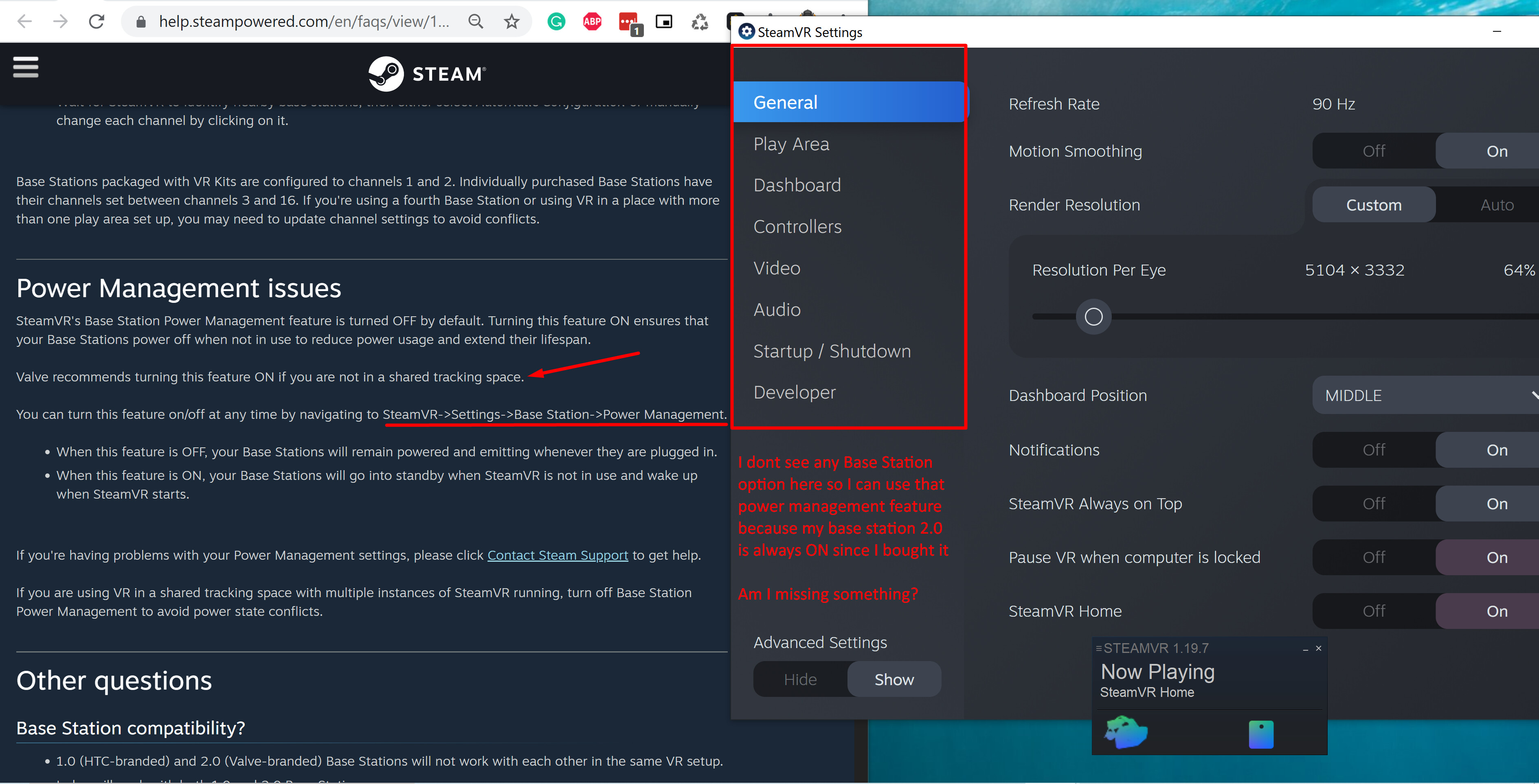

Something got to my notice while reading on the link you shared, I just saw there Valve recommends turning the power management feature ON if we are not in a shared tracking space but I don’t see any base station option in steamvr setting from where I can make it ON…check he screenshot below and please let me know If I am missing something there because now after all this I really don’t want my one and only base station to get into some problem in near future :worried:
That is the problem with combining Pimax as HMD and valve or HTC base stations. You lose control of LH energy. This energy control can only be done by bluetooth integrated in the HMD of valve Index or in the linkbox of HTC but Pinax does not have that bluetooth in particular. That has been another losing fight for me.
In this case, Pimax should make their own base stations and controllers instead of depending on other brands’ devices.

  3. What you flashed on your base is the firmware for the LH v1, so it will not work at all.
