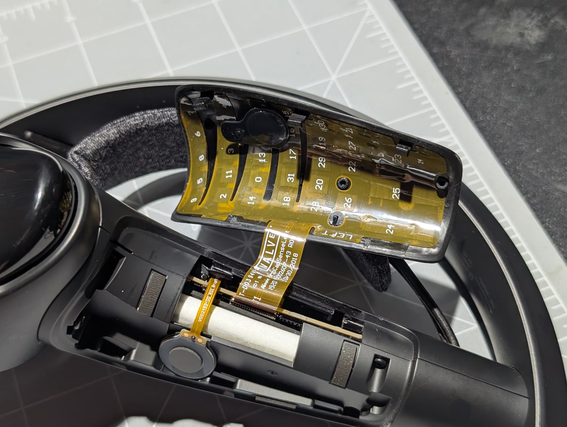

Index controller disassembly
For those interested, here is a disassembled Index controller…
Cap sense on grip plate, and grip sensor

It’s a really complex piece of engineering and seems quite fragile in places.

The cap sense on index seems to be divided into multiple zones. Tgo’s etee controller with its intelligent sensing material was completely superior to Valve’s solution and also wouldn’t break down over time.

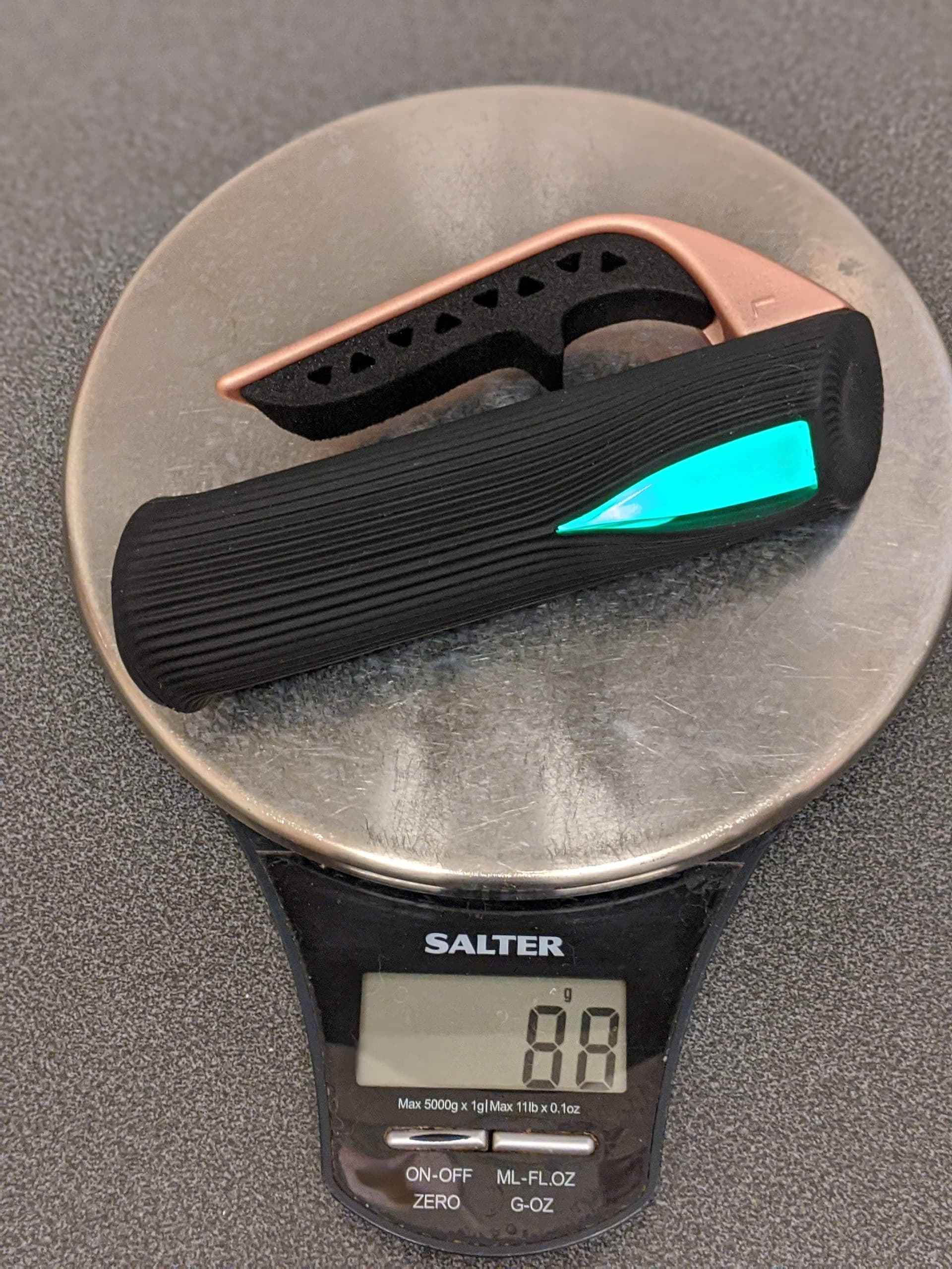

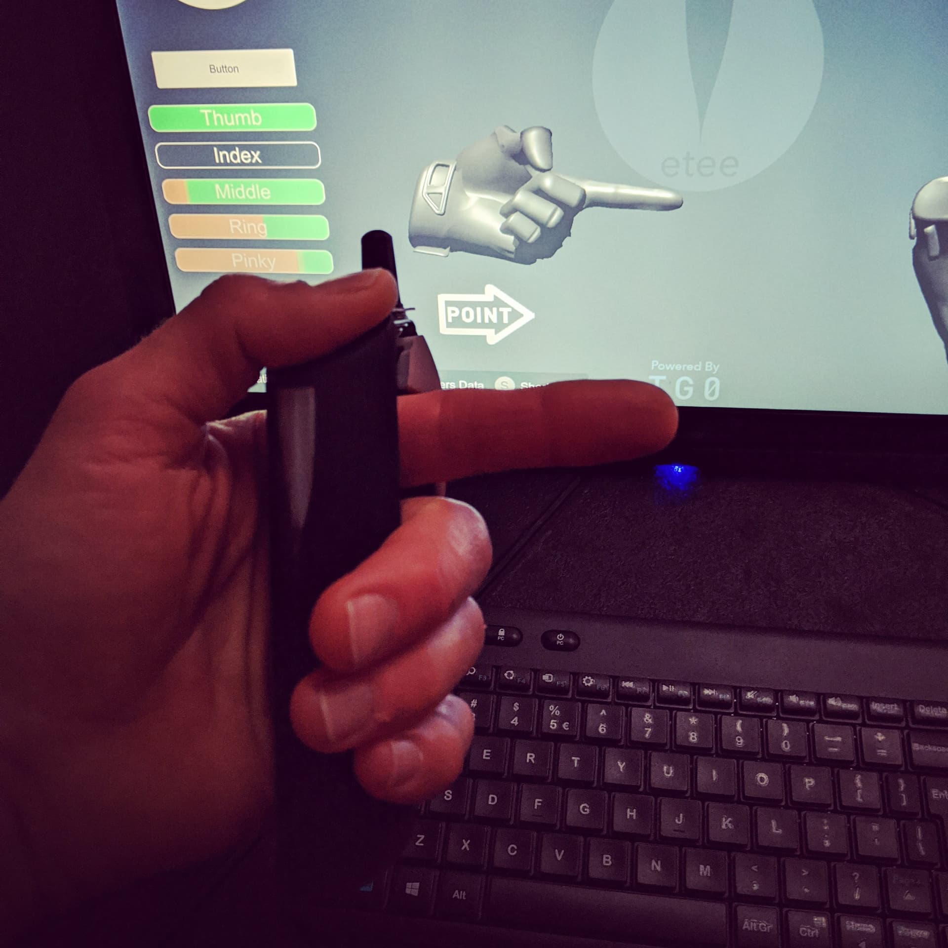

Etee 3dof prototype with my ergonomic adjustable modifications
Some more…

The mod made the etee “finger bar” fully adjustable for different hand sizes, finger length, etc.
The black knob is loosened allowing adjustment (rotation and depth) before tightening which locks it off.
I also modded the cushion so it was adjustable as part of the ergonomics improvements.
This was prior to the 6DoF tracker being released I was lent 1/6 prototype for assessment
The stock bar actually snapped during testing as it was much too tight for my fingers causing the plastic to fatigue and fail.
Their material sensing technology was absolutely stunning, but clamping the controller to the proximal phalanges was just really weird, the controller would “roll” inwards when closing the hand changing the distance to the trackpad on top :face_with_hand_over_mouth:
That is quite cool. One issue I suspect with Etee controller might be first person shooters. I think the controller will bounce maybe a bit in the hand simulating pressing trigger

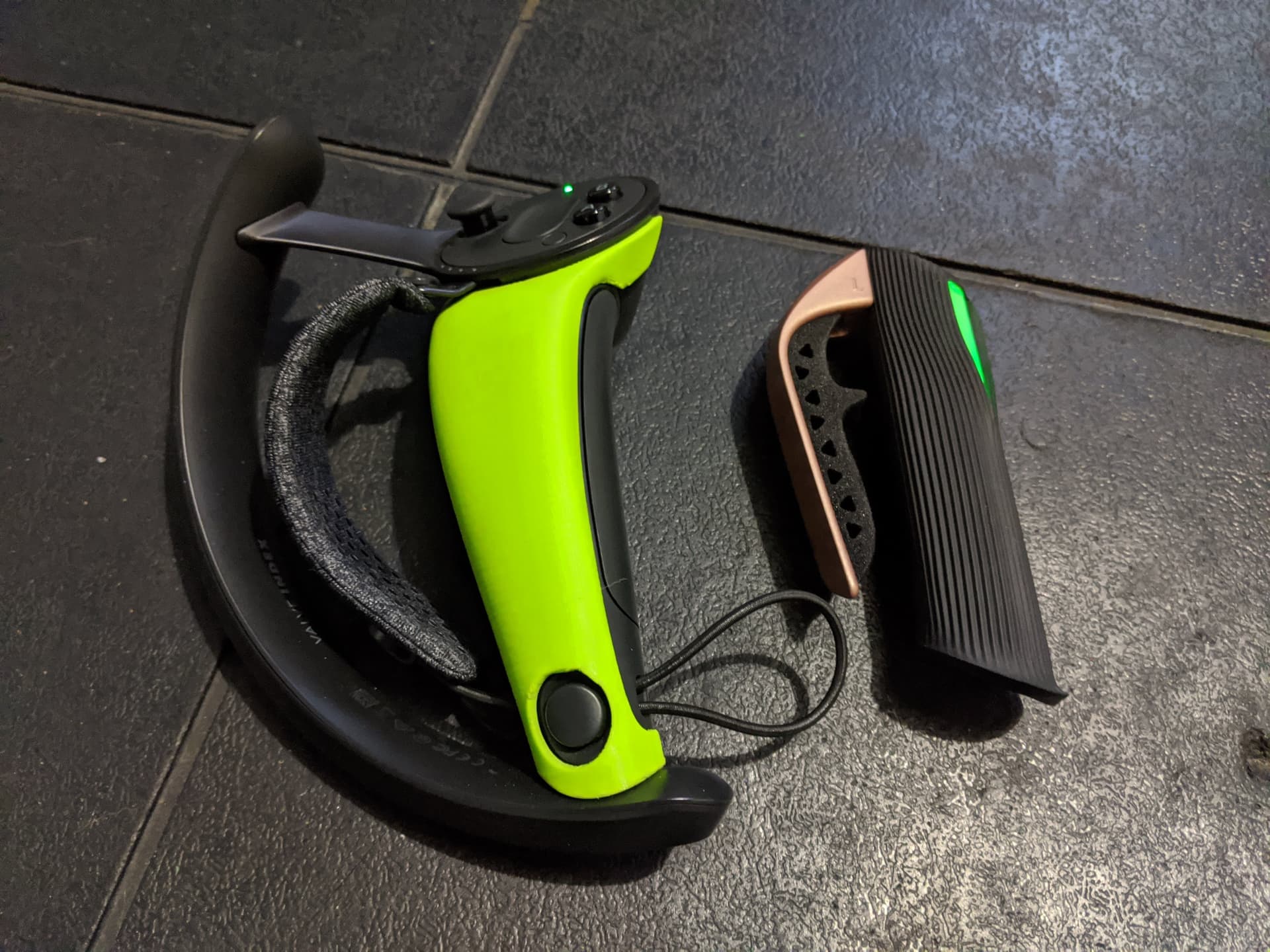

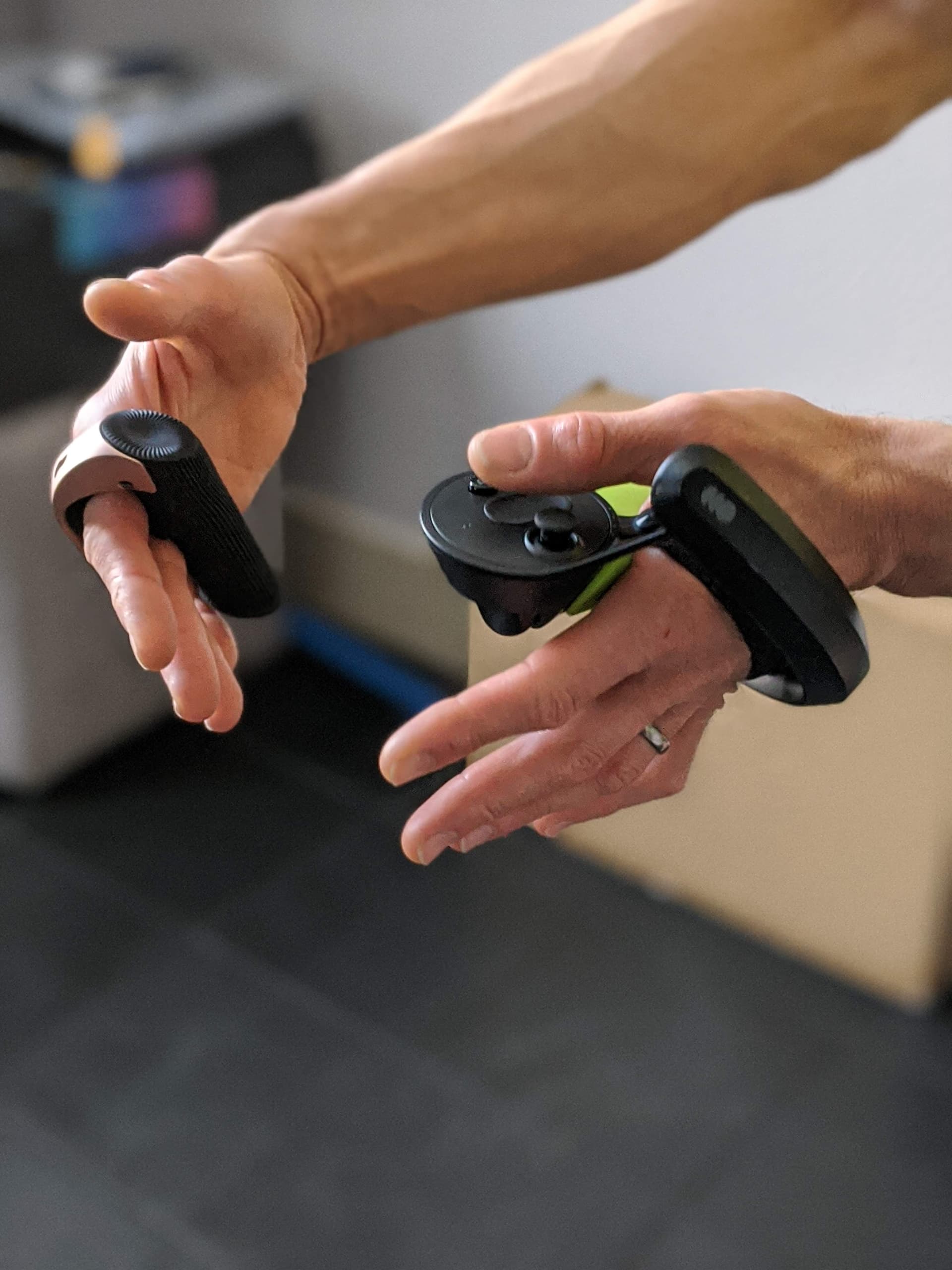

Comparison with index
