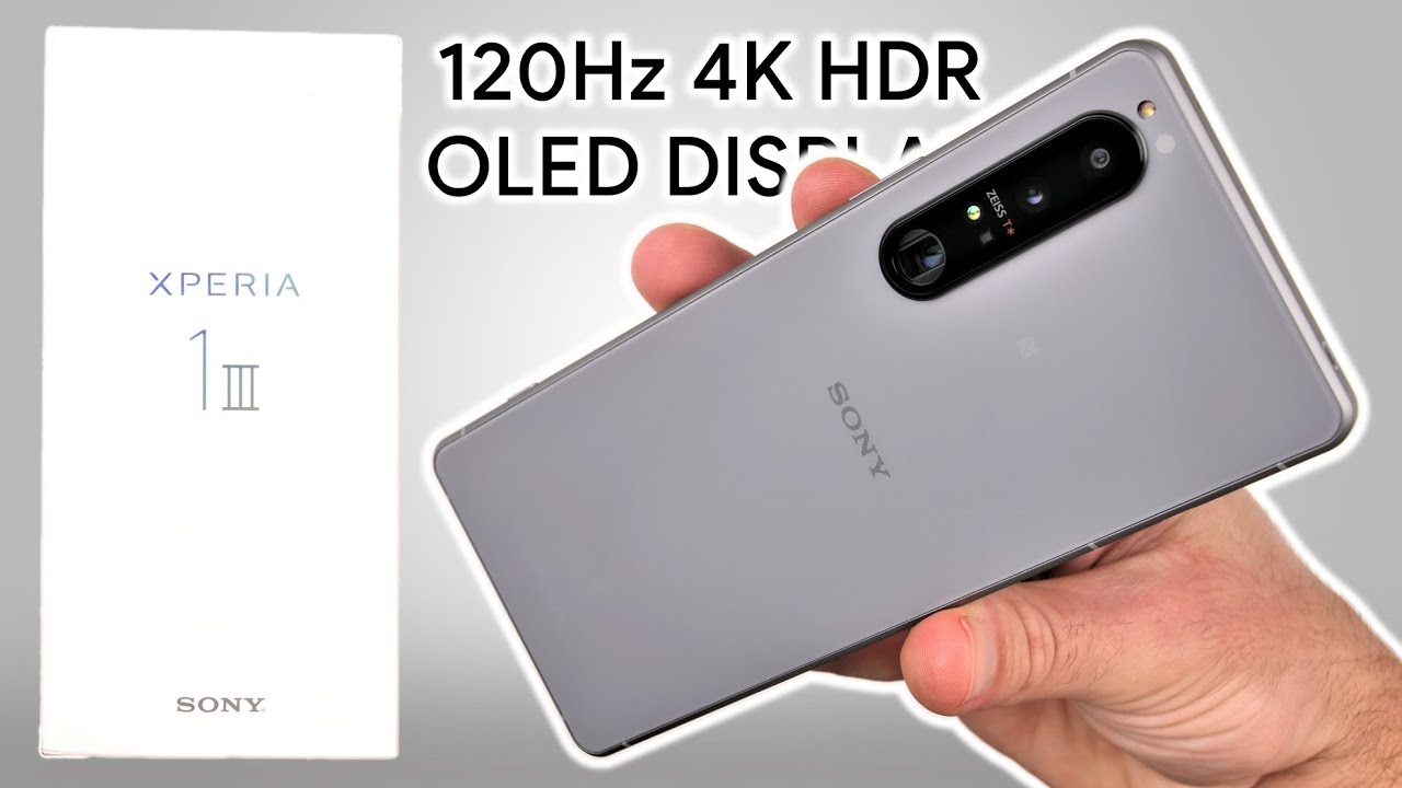

I think I have found an 8K-X BE display option
@SweViver @PimaxVR @anon57422158
The display in this new Sony phone is 4k (3840x1600) 120hz with 21:9 aspect ratio with 1300 nits peak brightness.
If you guys want to make an OLED model, I would look into this puppy.
Even if its not RGB stripe, the refresh rate, aspect ratio, HDR, and OLED would work great with a slightly lower magnification lens on your normal FOV setting.
Even with your upscailing chip in the 5K, this would be awesome.
This display has higher spec than most TVs on the market right now. At 120hz or 144hz motion blur should be ridiculously low. The phone even says it has 240hz blur reduction. (that probably means its designed to accomidate large vertical totals and panel scannout of 240hz.)
I would happily pay upto $1500 for an OLED model with these specs. Now that Vive switched to LCD there’s a huge gap in the market Pimax could be tapping into
@anon57422158 @PimaxVR Hope you have somthing in the works :sunglasses: Give us a sign bud :pray:

The question remain if its PenTile matrix or RGB Oled?
Okay $2000 then :grinning_face_with_smiling_eyes: It would easily beat star VR
…Screen yes, FOV no
That would be my question to. However, I think with special lenses optimized for what is the “normal” FOV it wouldn’t matter strictly if the matrix was pentile.
Its also a 21:9 panel, so you might not lose too much resolution on the horizontal axis.
Just my 2cents - to me 8KX BE is instabuy, even if it will have some of the technological OLED drawbacks (smear, screendoor). Will pay over 8KX price, and LCD screen used in 8KX is the reason I am still on 5K XR.
Yeah, but Pimax would have to manage to get proper Nits on those displays as they tend to have dim displays on their products
Pimax’s low brightness is probably a circuitry issue, or maybe their supplier. The fact that this panel is advertised as 1300 nits is probably not its full field brightness. Even so, being OLED in a VR HMD it wouldn’t need insane brightness to really pop.
