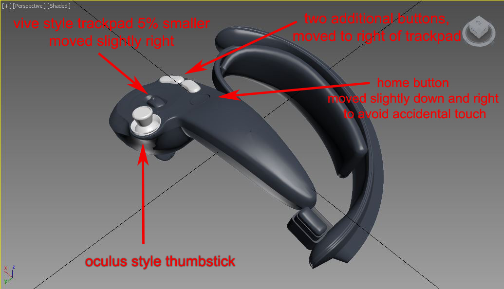

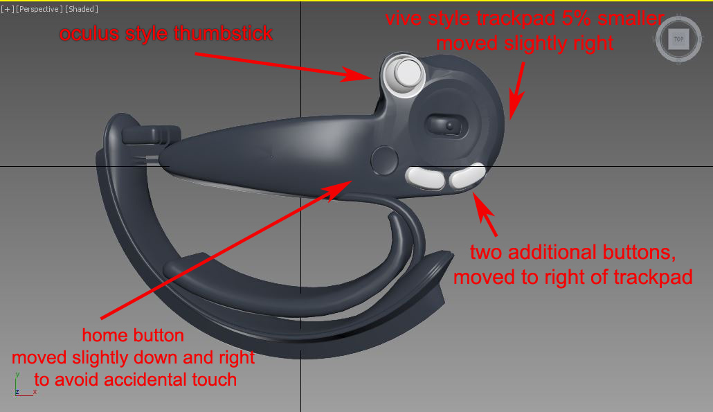

My idea of the perfect VR controllers based off Valve’s knuckles design, not the best modelling but I was in a rush. It would also need to have a middle finger grip button as in the Pimax design (and similar to Oculus Touch). What do you guys think?
I like it but i think 1 button should be on the left side like the Valve reference design else you will always have a pain with the button assignment. Left Trigger Left - Right Trigger Right with your concept you have Left Trigger Top - Right Trigger Bottom or the other way around.
Yes that’s possible. Maybe one of the buttons would be better sitting between the home button and the thumbstick

Interesting design, though after thinking about this, a controller should be ergonomic to our hand as much as possible, we neglect our body natural characteristics for wishful thinking features (and I do this mistake too).
From ergonomic part, I think this controller offer a lot of buttons on the upper side but they seem to be useful only for the thumb(?) In this case we will have to work our thumb most of the time…
I might missed something but this is how it looks from the pictures.
I’m also puzzled that there are no pictures from the other side (flipped side?) of the controller, there should be a trigger button for middle finger (I think I see one) and maybe another one at the bottom or side for the other fingers (like current vive ones). I do admit that the bottom side button in Vives controller case (not the nuckle model) was not intuitive as the others although it was placed correctly for the hand grip, but it is better than moving your thumb left and right down and up to do all button work.
The pros here: There is a touchpad, joystick and options/home button does not interfere.
@petes117 I hope you will have more time to show other angles of the controller, I might miss other buttons though.
@andrewb - I think your clay design is interesting and ergonomic for hand grip, though I would like to have both worlds, stick and touchpad.

I really hope pimax doesn’t do any two in one controller design. I don’t want a trackpad on my stick controller and I know many don’t want a thumbstick on there trackpad controller. It’s better to keep them separate as they already agreed to do. They perform the same function, both are not needed on the same controller. The thumbstick or trackpad need to be in the optimal position and putting both on one controller means one will be awkward to use almost certainly.
I agree ![]()
I think that the conclusion was already made somewhere. Putting a joystick over the trackpad or a trackpad over the joystick is an excluded idea already, I think.
But putting two, where one would be on the side of another, I think you would agree, seems to be a nice idea.
That would be really un-ergonomic, like the Microsoft ones. Exactly what I don’t want.
Or maybe that isn’t what you meant?
That is exactly my point! The ergonomics of putting both on the same controller would be terrible for at least one of them.
Maybe you didn’t read my comment very well. If you read it again I think it should be clear that I actually think it’s a terrible idea to put them both on the same controller. Look at the Microsoft controller, people are not happy with it. If both are put on the same controller people who don’t care about having a trackpad will not be happy that the stick has been pushed over to an inconvenient spot just because some group of people who want trackpad can have a choice of using a stick. How about a design that puts the stick in the main position and shove the trackpad further away? How would you trackpad supporters like that?
