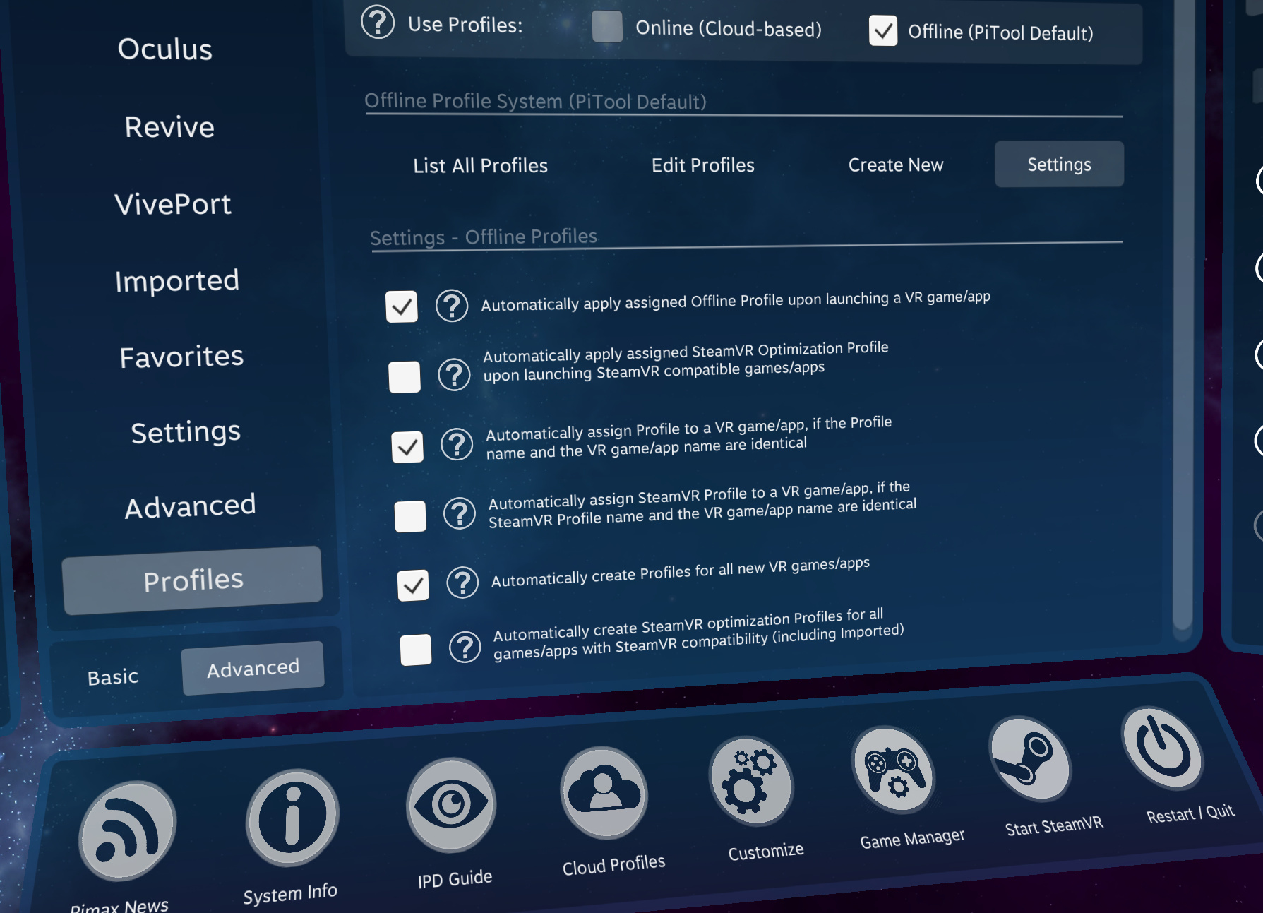

I would like to try out Pimax Experience. The problem is, I set up a custom steamvr.vrsettings file (I guess most users here did this). I gave “gpuSpeed” 1-9 a value of 2000 and the gpuSpeedRenderTargetScale a value of 1.5. Also, I set the Steam Render Resolution to 1.5. Then I set the steamvr.vrsettings-file to “Read Only”, so the values won’t be overwritten every time.
And here is the problem: when I want to use Pimax Experience, the steamvr.vrsettings-file must be editable (I guess). But this means the preset gpuSpeed and the gpuSpeedRenderTargetScale values get overwritten every time.
How do you handle this? Or maybe am I getting something wrong here?
