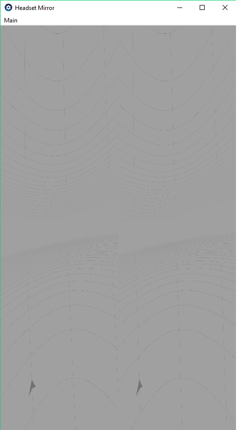

When the headset are in a horizontal position - in the steamvr i see a tilted image:
Room setup in steamvr does not eliminate the problem.
How i can reset device sensors?

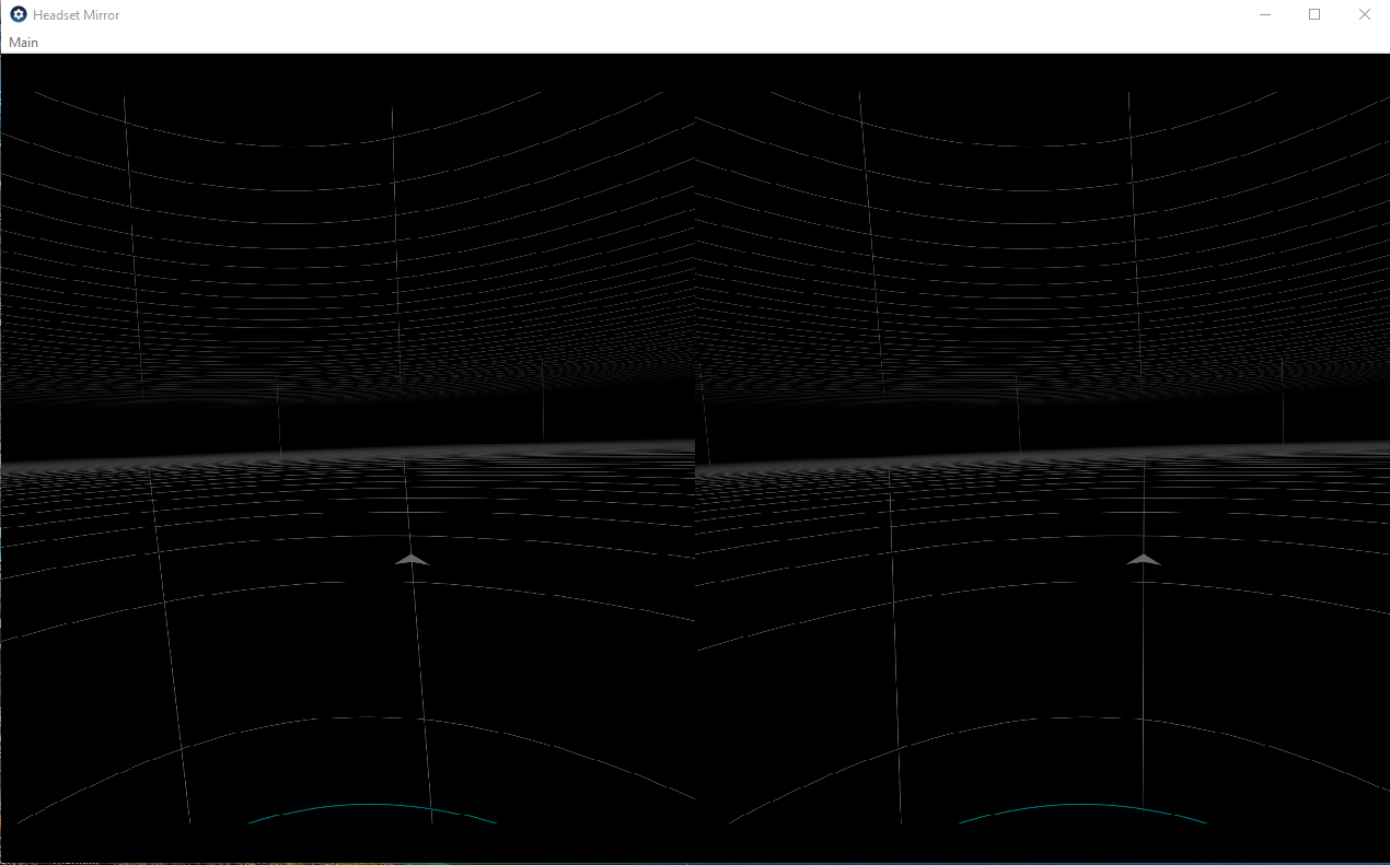

Close SteamVR down/Relaunch while holding the HMD directly in center of play space.
Restarting steamvr does not solve the problem. I also restarted my computer and reconnected Pimax - nothing changed.
