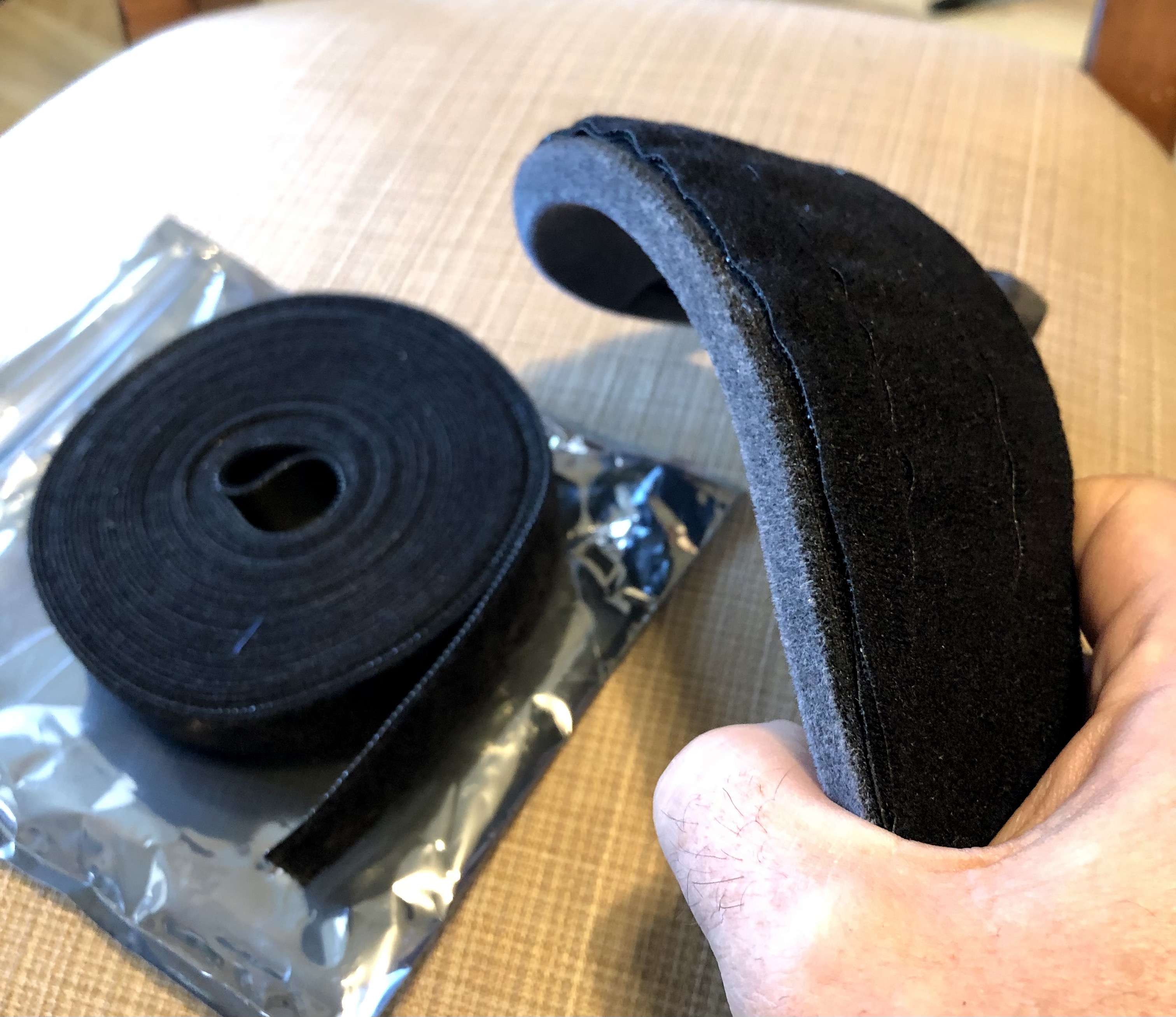

After trying four (4) different face foams, I found that my thin foam with some velcro cable tape added the perfect adjustment needed to move my eyes about 2mm further away.
Ya, I also found the thin foam to my liking with some additional shimming at the edges with pieces of foam. The topper though was literally that (the top fit). To that end, I imported my Studioform Creative strap that I had used with my Vive DAS over to my KDMAS and found the most solid and comfortable fit. For myself anyway.
