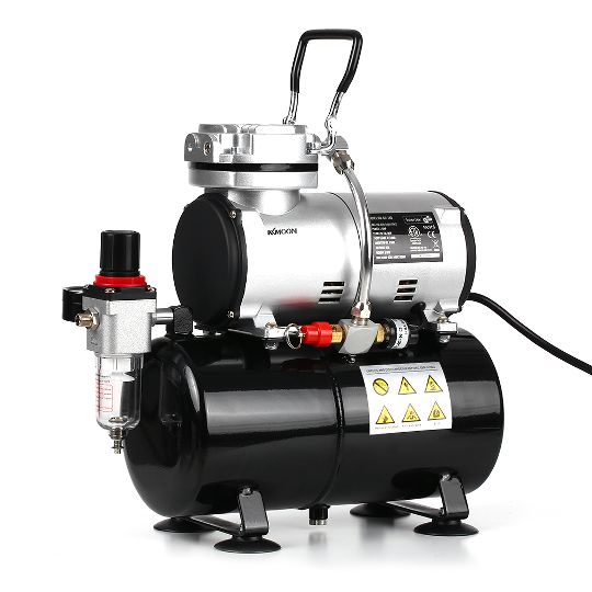

If You’re trying to say that condensation can be an issue it is possible to use an air compressor instead… :+1::wink:
I agree, only the compressor should be with a drainage system
I would’nt use air from a compressor system without proper cleaning of the air( oil film etc) cleaned by active coal and drying filters. Should be as clean as breerhing air to be safe to use.
Compressed air for electronics can be bought in small cans like spray cans. These are safe.
