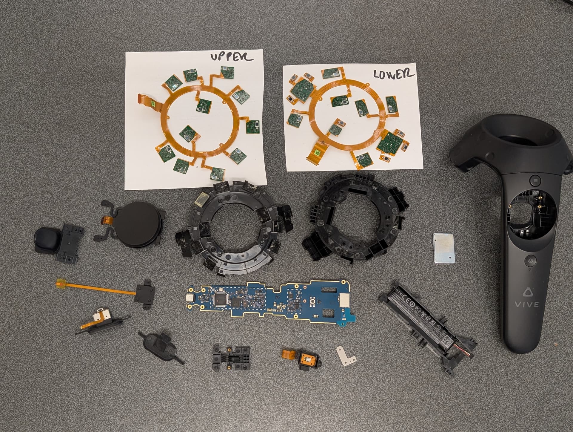

The triad semiconductor diodes in the controllers and headset require laser light hits from the base stations, you can see the diodes here in this disassembled Vive controller, I’ve marked the upper and lower tracking webs

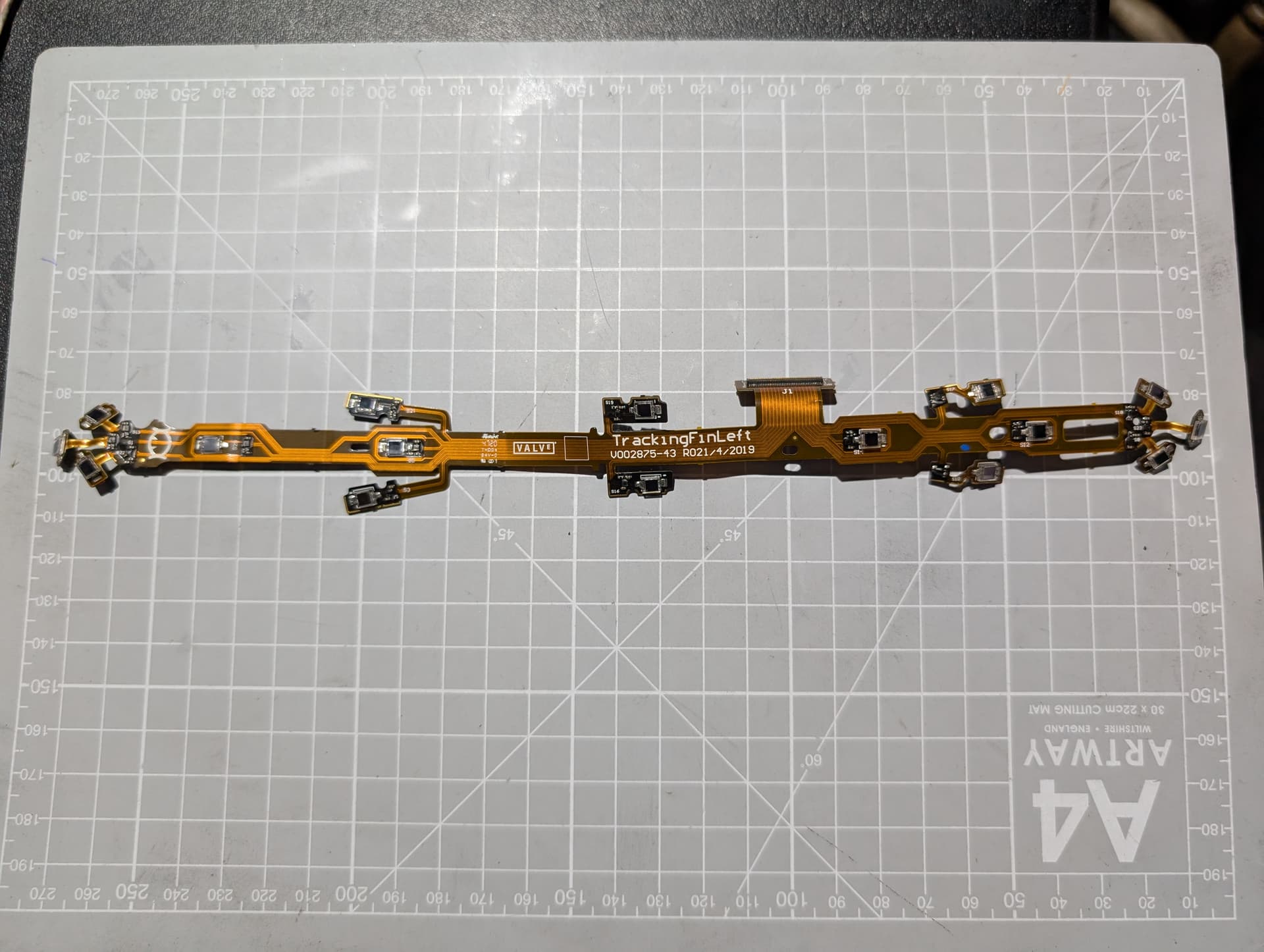

This is a tracking web from Index controller showing the triad diodes
