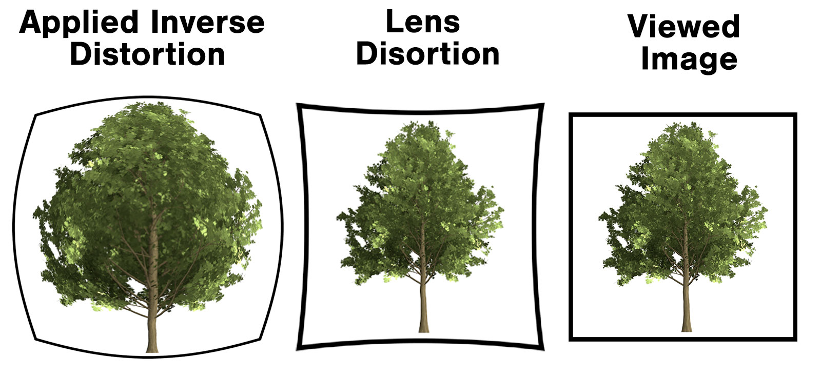

To correct for lens distortion, your VR headset predistorts the image, so if youâd look at it through the lens, it would cancel out the lens distortion and you would see the correct image:
But as you can see, in the predistorted photo, some areas are âblown upâ. Now if you only have the frame in its native size, you can only blow up by duplicating (or interpolating) pixels. However if you have a higher resolution photo than the original, you donât need to âinventâ data, you can just use the original data! This causes the higher quality.
So itâs pretty much the difference between zooming in on a low resolution photo and a high resolution photo. With the low resolution it will duplicate/interpolate, with the high resolution photo it will just show original data.
I completely understand that the bulging predistortion would be of a higher dataset with a higher res source image. I just wonder wether that actually is being rendered that way. It would be much easier and cheaper to just bulge a flat image and duplicate a pixel here and there and then let the lens distortion put it back to where it belongs again.
In theory yes, the extra data will travel to your eyes but at such a small detail, would you notice that compared to a supersampled pixel?
