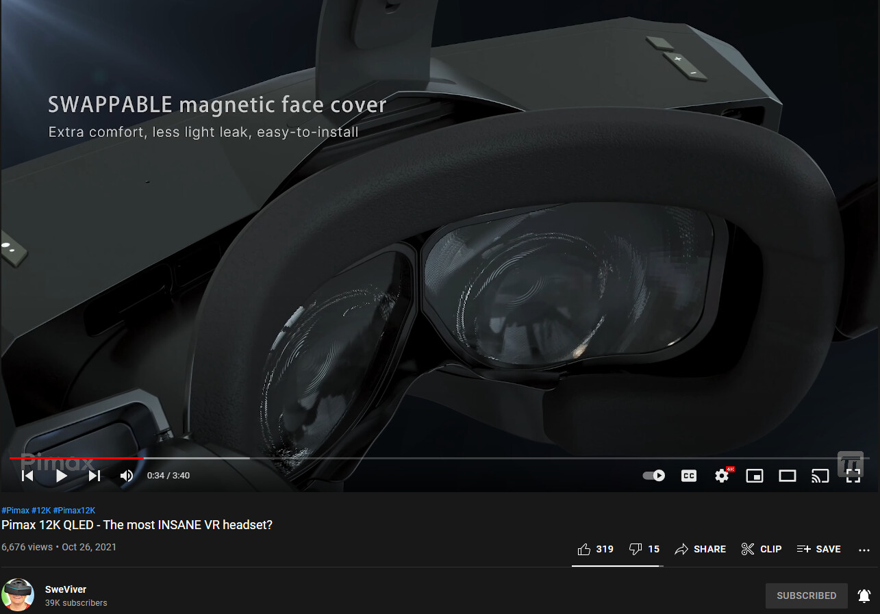

maybe they allready have that covered it seems, especially if it comes with more than one swappable magnetic face cover thickness.
don’t see any mechanics that moves the screens along with the lenses either, even though IIRC @anon57422158 confirmed that on @mixedrealityTV stream, maybe there was a misunderstanding
I really really REALLY hope im wrong about this. :smiley:
