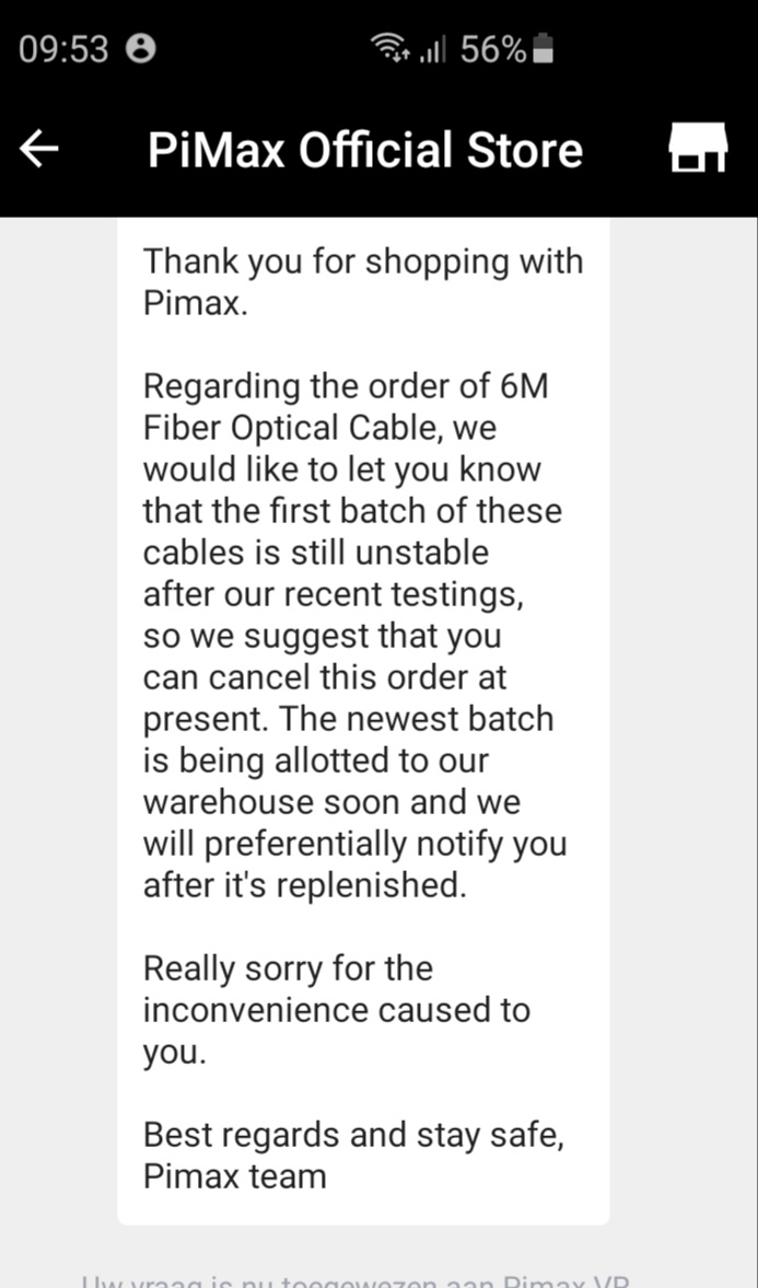

i ordered the 6meter optical on aliexpress on the official pimax store there.
I did get a email that i need to cancel my order,because the cables are unstable .

It’s really interesting they decided to cancel your order, since in Pimax Update #95 (Dec. 3rd) they release once again.
yes very strange…
Unless we are still seen as testers
