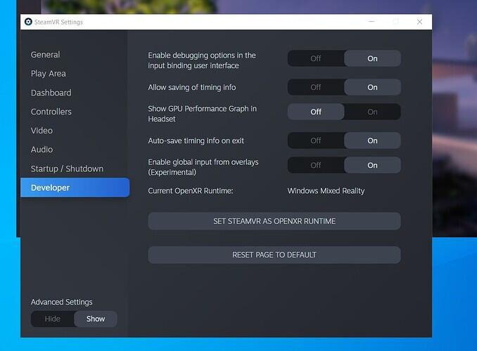

For all of you folks out there having a problem with the pimax (and other VR headsets) not beeing recognized. I found a solution that worked for me:
You need to set SteamVR as the default OpenXR runtime.

If someone already has SteamVR & WMR plugin, It looks like we can just set the OpenXR runtime in (Steam VR > Settings > Developer menu), instead of the Registry or command prompt?
There is a button to “Set SteamVR as OpenXR Runtime.”
I could be wrong tho… but wanted to try FS on SteamVR also.
This one helped to get my pimax recognized and start SteamVR with the Microsoft Game Pass version of the game.

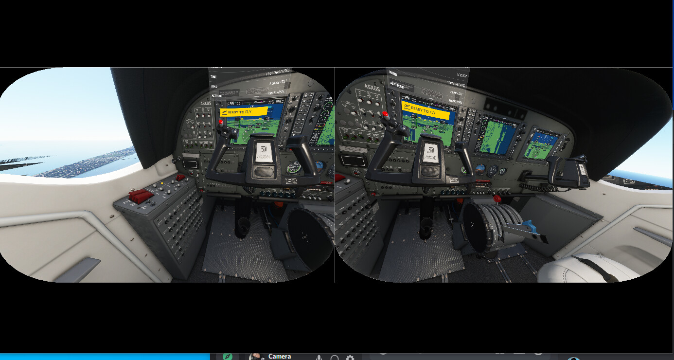

dont you want the canted display view? for me the artifacts at the right side of the right view were gone when this occured but now for me its gone back and i want the canted view back any ideas?

i dont think thats a pp issue when i first started in vr i had the same annoying view in the right eye (jaggies) i started the sim in gforce experience and had the same view as sweviver. (canted display view)? the jaggies were gone and my experience was great a game restart later and im back to this
would love to get back to the correct view

i’m in VR already but either steam or ms2020 doesn’t see my headset as canted as per swevivers view above i did have this view once when i loaded the game via g-force experience but sadly no more

I Dont get this i get squares how do i force it to your view
