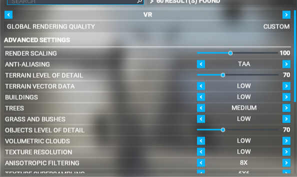

My 2D (monitor) settings, in MSFS:
http://puu.sh/H10Ws/637a83e79a.jpg
My VR settings in MSFS: With these settings I get about 25 - 30 fps in VR, which is still flyable with my 8kx.
http://puu.sh/H10Xa/4c83dfc4a0.jpg
