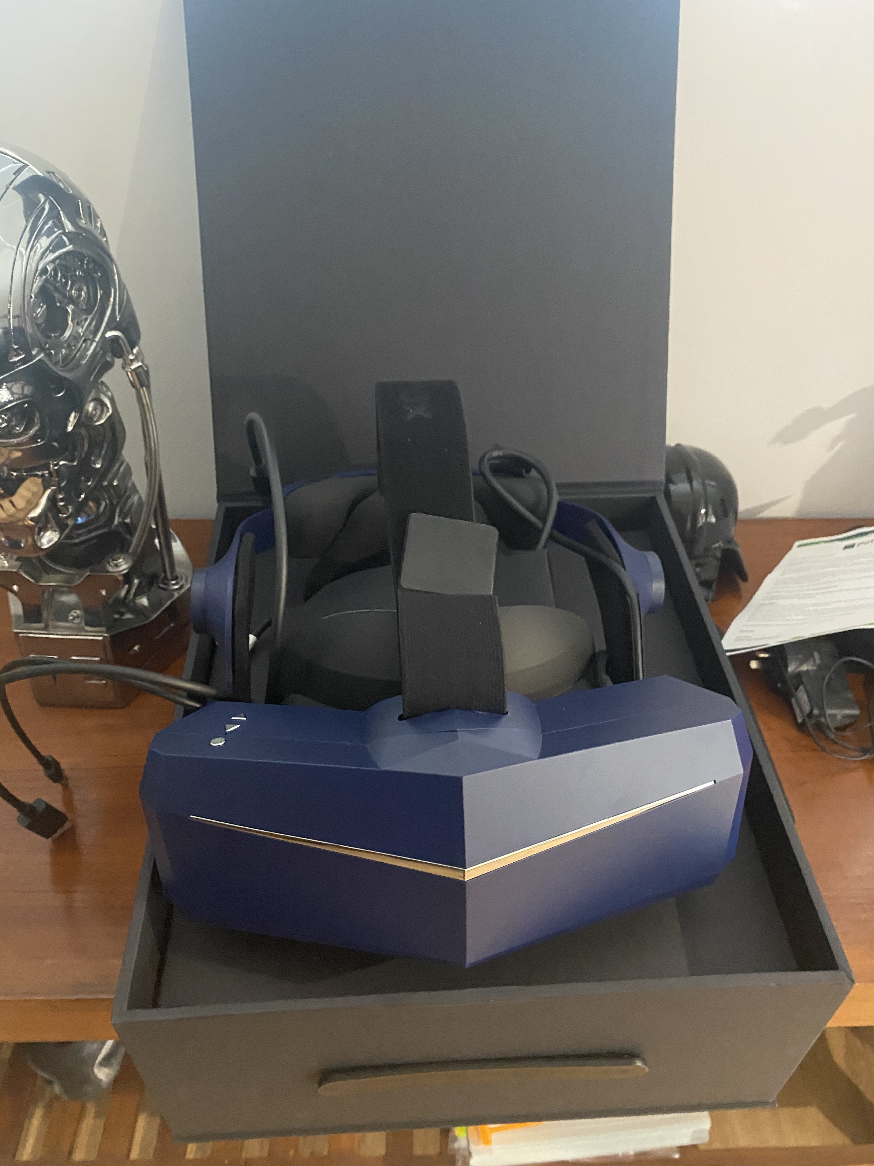

Mine has arrived. Haven’t turned it on yet but my first impression is that it’s not very comfortable at all. Plastic hinges and only one face foam.

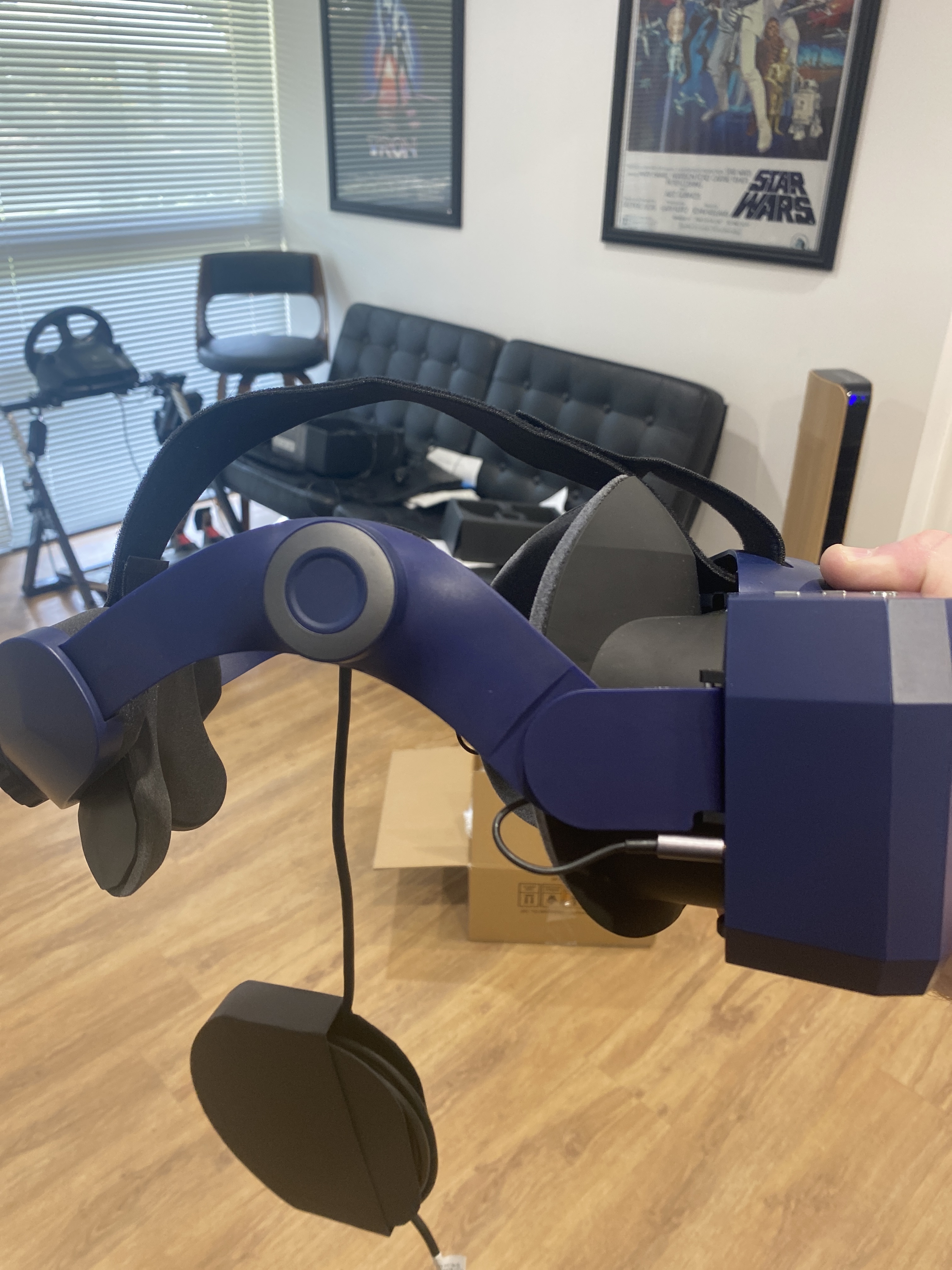

It definitely does. It should cup the lower back of Your head.
According to others, it seems there’s a notch it has to go past on the plastic hinges.
Why it doesn’t? charcharchar
If you have plastic hinges, it should go down more. A LOT more.
Look at mine LOL:
You just need to apply some more force to it.
And loosen the top straps a lot or it won’t go down (but I think you already did).
how much force? ![]()
does it break anything in there or it just jumps over the notches?
It seems to be that when you reach a point there is a lot of friction but once you get past it it just goes easier.
so when you reverse the action is friction still there or it’s lost & something plastic clicked before?
It is still there. There is no hard ‘click’, it is just a lot of friction. Doesn’t feel like plastic against plastic, rather rubber against plastic or rubber against rubber maybe.
nice to know, I guess prong of the hinge just bypassed strap hole’s notches & gets in the next pocket.
any problems with the strap length when you loosen it like that?
No, I think the length should be enough for most people, but maybe some people with big head may have problem with it not sure
Thanks so much for posting this. I’ve been worried that it wouldn’t fit well on my head with the reports so far on hinges… but fedex man just dropped mine, and my experience is exactly as you described.
At first it felt like there was limited downward movement, and I gave it a gentle push further through the increased friction section to see the same range as you. No clicks, no worrying feeling of breaking something. Just increased friction that is still there as I move the headset hinge back up through that same range.
Unfortunately quite busy at work so will have to leave it for now, but I’m happy this range is there in my unit as well.
Also you must greatly loosen the top strap as indicated already. Doesn’t seem like there would be an issue for running out of strap, except possibly for heads much larger than mine.
i cant get past that point,i need to put to much pressure on it… it can break

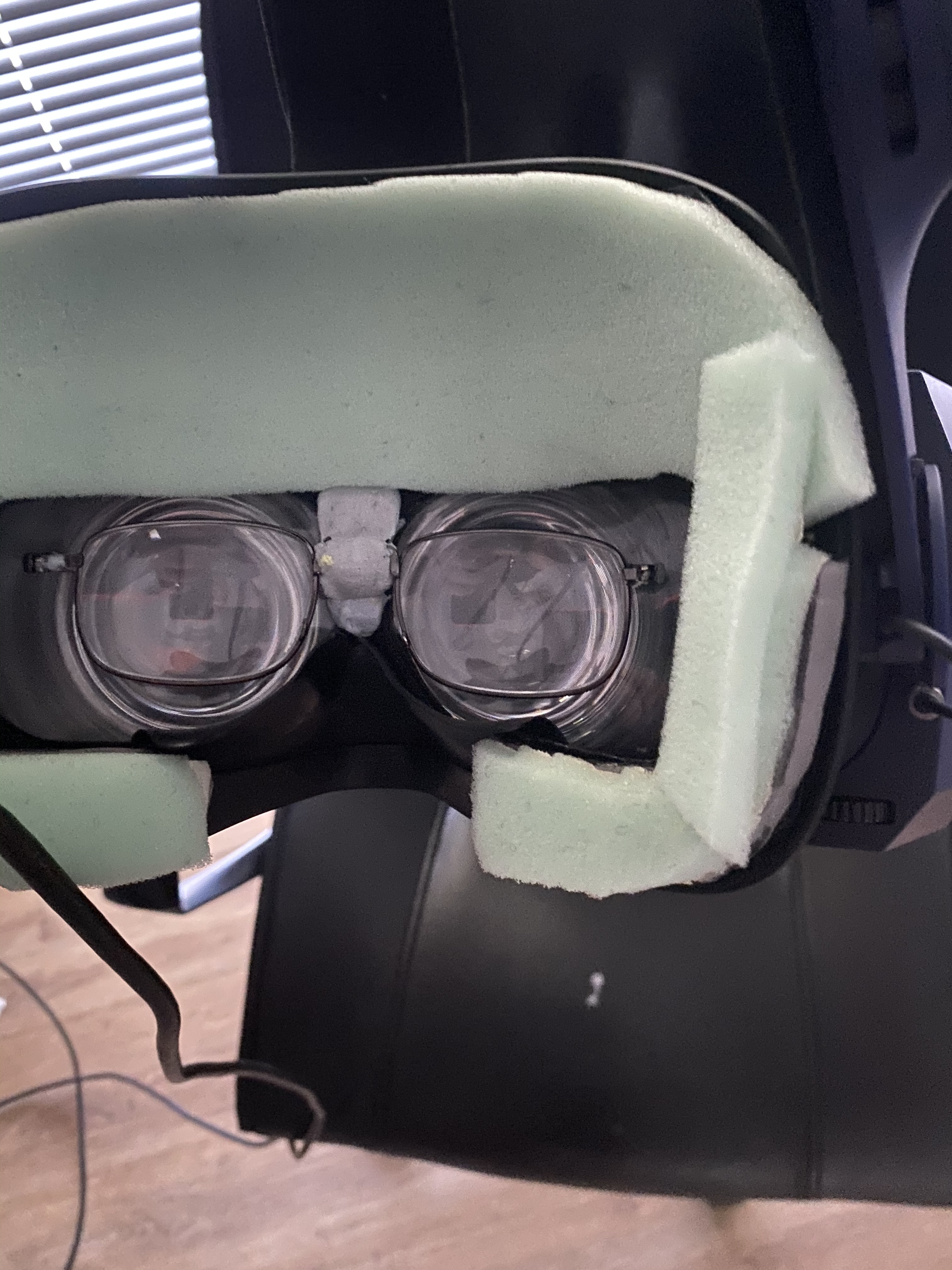

Today I removed the face foam from my 8kx and I have managed to make it much more comfortable by making my own custom fit. The sids are thicker to stop it wobbling when I turn my head. I also made the foam even thinner on my forehead to get my eye’s closer to the lenses. How I have a larger sweet spot and a bigger FOV. And because I have made the sides thicker it distributes the pressure more evenly so it is MUCH more comfortable. This headset really is awesome once you get it dialled in. The colours are vivid and the blacks look very good to me. I think if @Davobkk could make some different size segments for the face foam like a top piece, two side pieces and two bottom pieces in there different thicknesses I would definitely buy them
Don’t worry about my blu tack mod to help hold my glasses in it’s only temporary but it works fine. It is really astonishing how clear the image is on this headset. The SDE is gone and that makes the colours look very solid if that makes sense.
