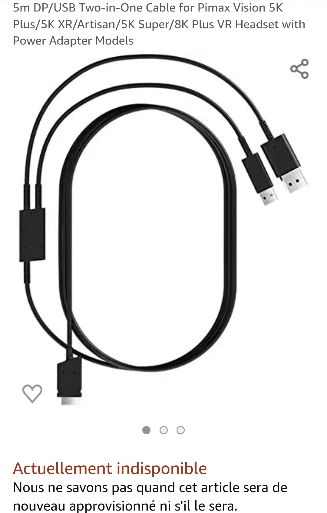

Ok… cable is a wear item, surprising.
So I’ll need a new cable, but in pimax amazon’s store they ran out of 5k plus cables… is it compatible with optical fiber cable?
No. But the 5 meter standard cable the 5K+ will work with is currently in stock on the Pimax website.

The 5m cable is unavailable to me…

5K+ cable shows in stock when I look. Just got a new one 2 wks back
Before you buy a new one, check Amazon, I got it 30% off u should too. This was right after waiting for 5 days for Pimax to get me a code for a discount, which didn’t work.
Yeah, that’s the plan. 98$ with shipping… I’ll wait a little to see if it comes back to be available on amazon.

So now after posting this my flickering has gotten even worse and the headset even blacked out a few times. So I want to order a new cable. Out of stock on Amazon and the Pimax store won’t ship to my US address. I get the message:
“There are no shipping options available. Please ensure that your address has been entered correctly, or contact us if you need any help”
So annoying how bad these cables are and now I can’t even buy one because everyone has probably ordered at least 3 by this point.
