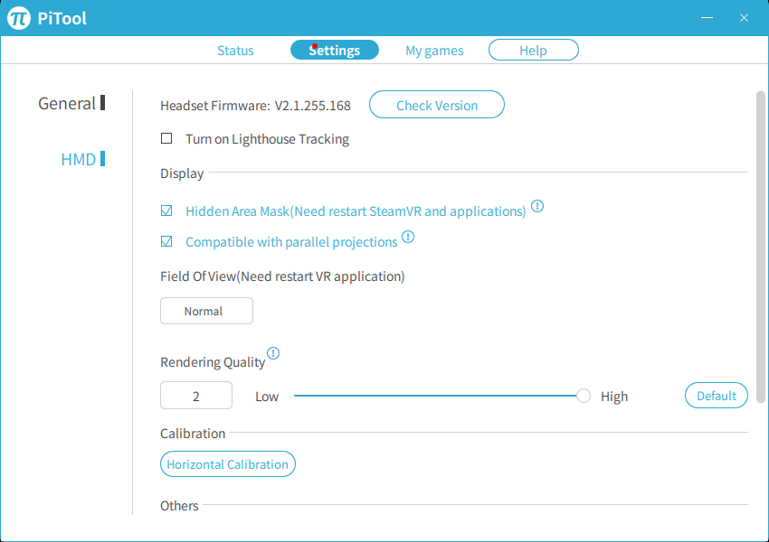

The first thing I’m trying to solve now is low resolution. It is felt in the absence of clarity in the image, as well as in the complete unreadability of the fonts in Bigskrina and the virtual desktop. Current settings:
I feel somewhere a dirty trick and conflict.
