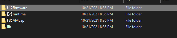

  4. Once downloaded extract the zipped file. once extracted there will be a few files. these files are listed in numerical order on what goes first
  5. Start by running the firmware upgrader it will ask for a code. check the file that says “code.txt”. It will be in there. place that code into the prompt
