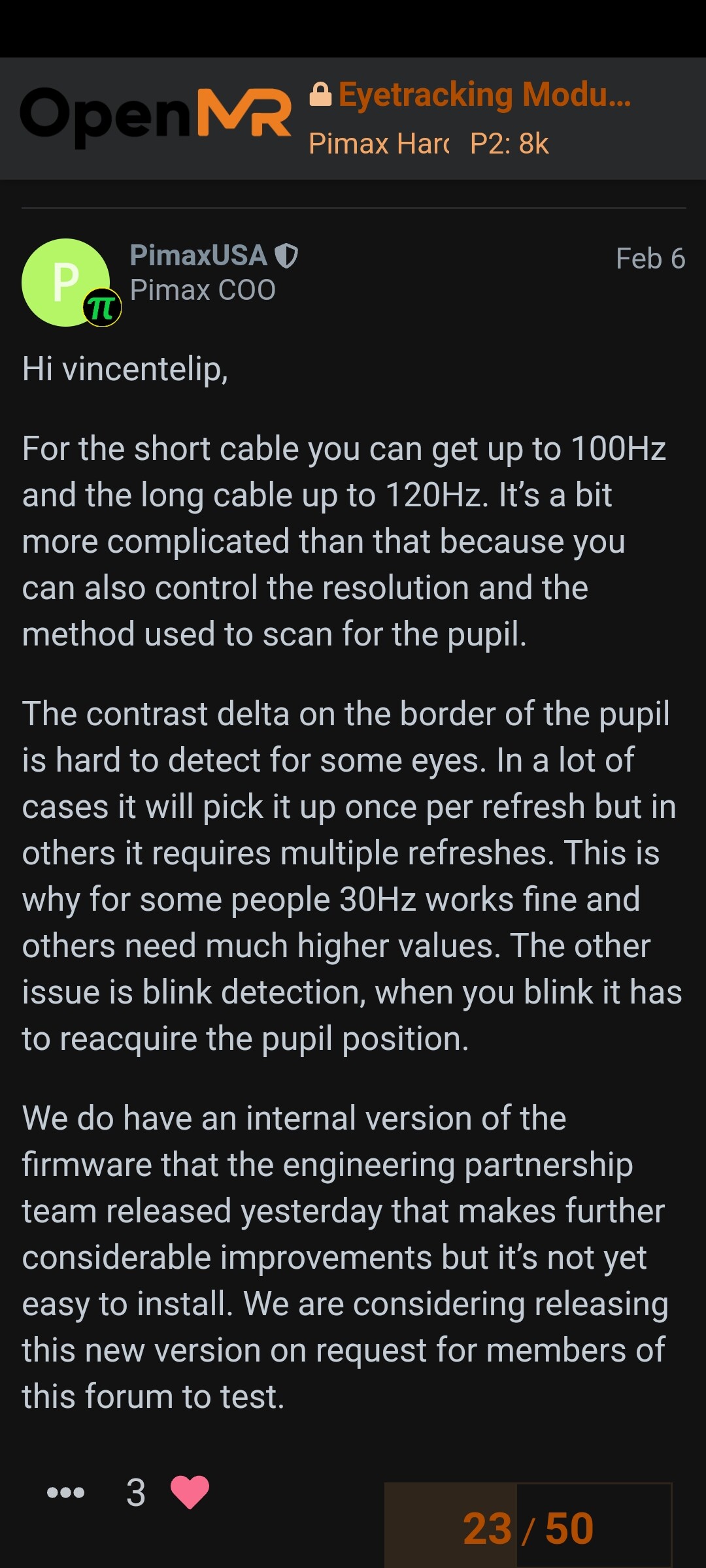

How many hz do you get with “USB 3.1 cable from AliExpress I linked”? 100hz? Do you notice any lag? Thanks again.
It’s been a while since I tested it but I got 120Hz and there was very little lag in the movement of the focus area.
