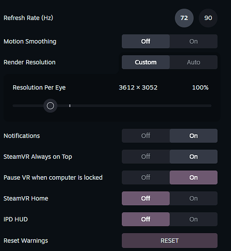

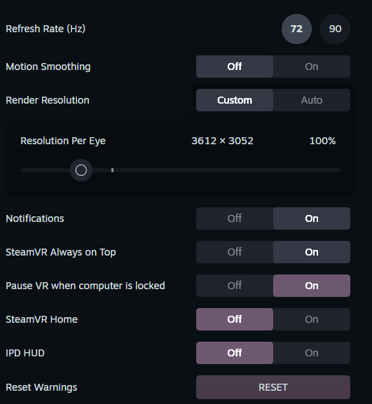

Current settings: Parallel Projection ON (required — IPD breaks without it), Hidden Area Meshes OFF, Stationary Dimming OFF, Motion Smoothing disabled in SteamVR, Advanced Supersample Filtering already disabled, SteamVR resolution 100%, eye tracking OFF in EVO but ON in the SBoys GUI.

Config, in case any of it matters: Parallel Projection is on because IPD geometry breaks without it. Hidden Area Meshes on, Stationary Dimming on, Proximity Sensor Type set to Stationary Dimming, FOV Clamping on, Rendered IPD 65.7, Super Sampling Filter Percent 500, and the VSync-to-Photons and Photons-to-Vblank values left at stock 0.007 and 0.0025. On the SteamVR side, Motion Smoothing is disabled, Advanced Supersample Filtering is disabled, and resolution is at 100 percent. Eye tracking is off in Pimax EVO but on in the SBoys GUI, and I’m not sure which one actually governs.
