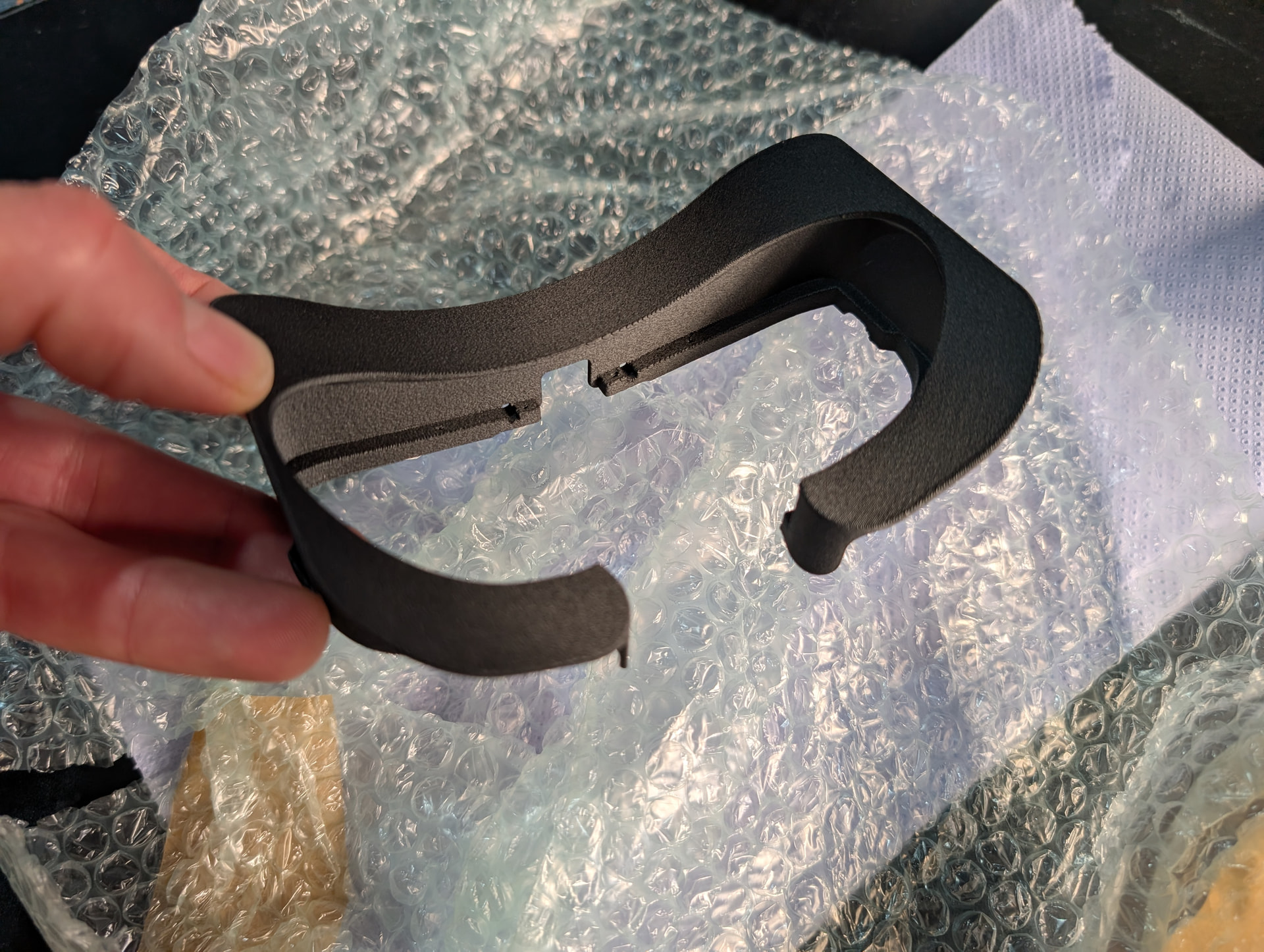

Just received this for my Dream Air courtesy of the design by designer Ancillary and made by print shop surface scan here in UK £37 including tax and shipping
Ah great thx, yeah UK is perfect for me. I know it’s early days, but how do you find it compared to the stock one so far?
I only received it today so haven’t had the chance to assemble yet. But it certainly has more room than the stock Face mask base so looking promising already. I tried without the face mask and experienced a noticeably larger fov but without lens distortion

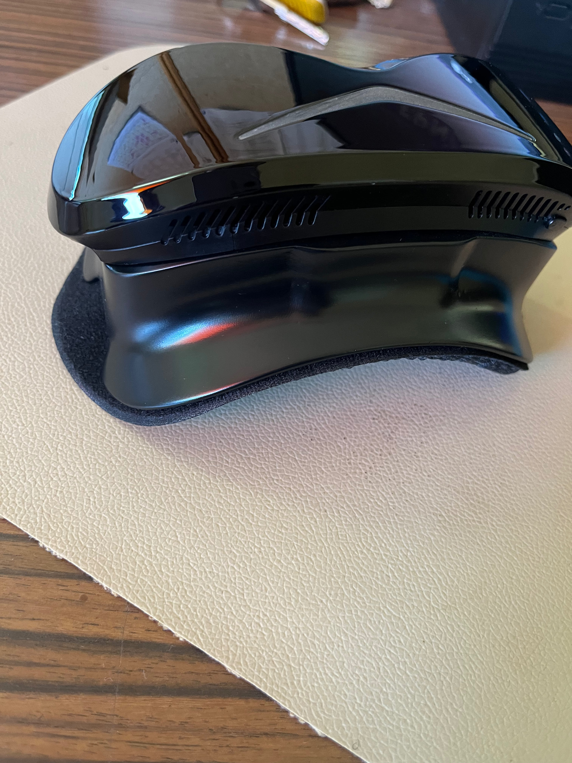

Just been getting this sorted this morning
These are the people I used in the UK went for 10 day service less expensive

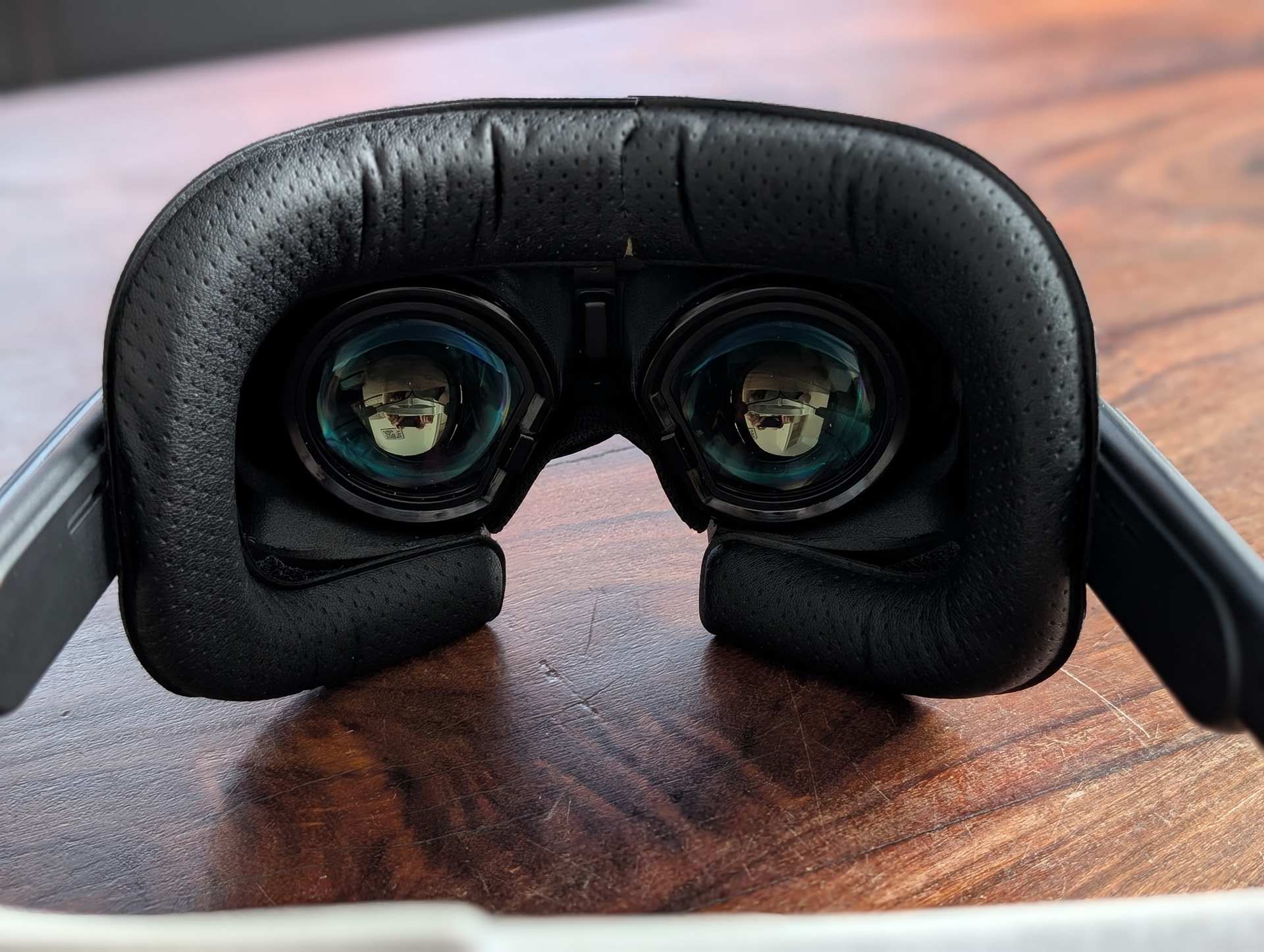

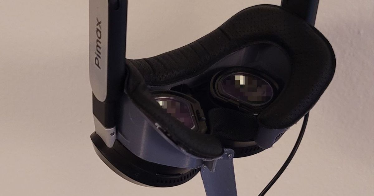

Here it is. Had to cut down a third party cushion to fit the smaller plastic base.
Sourcing two screws for the top as the much larger base is more prone to coming loose compared to the small stock setup, the 3d print is a little rough in places so will clean up after testing the new fit tomorrow
Ace, looking good. And comfy!

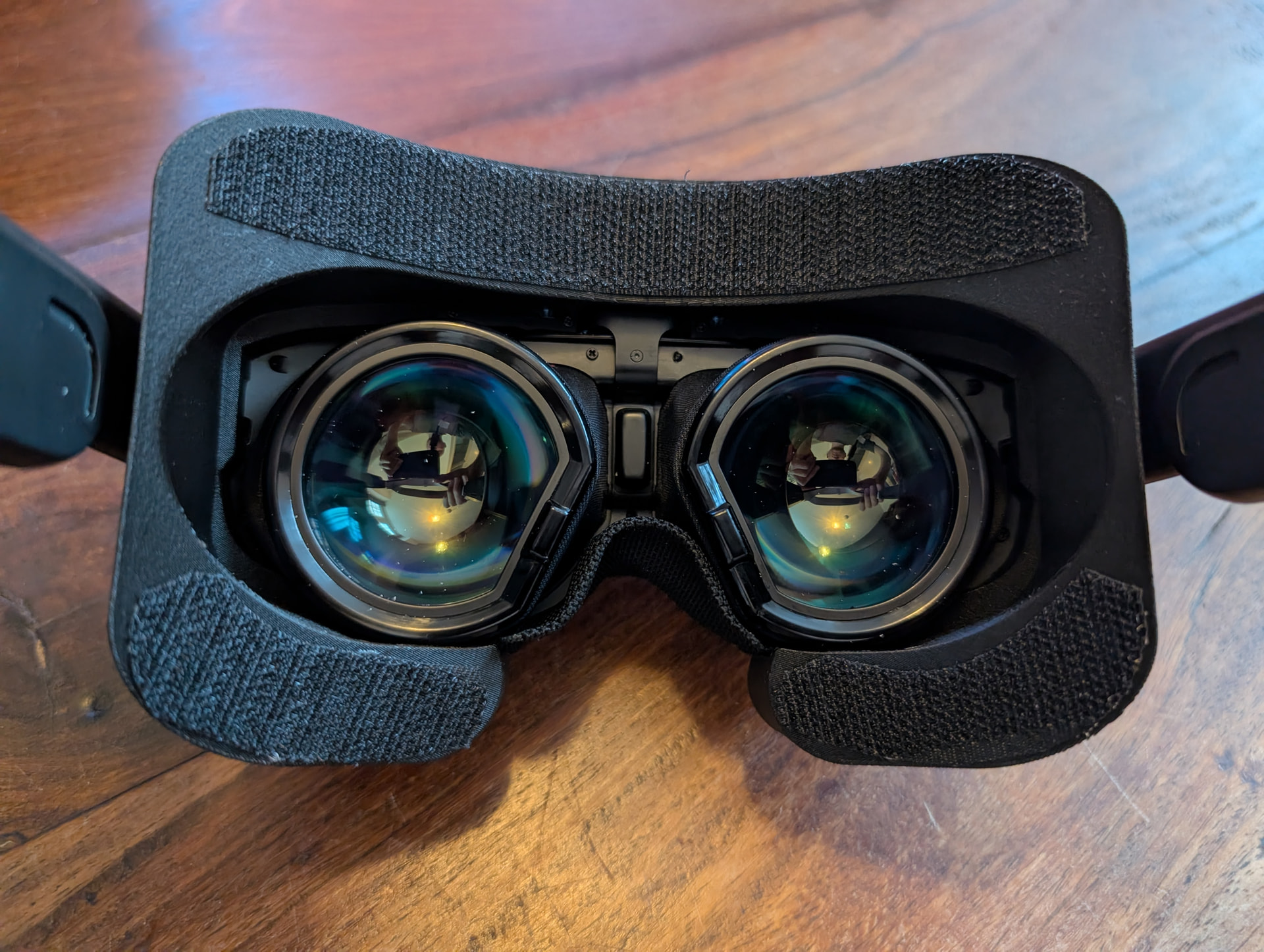

Added 2 x M2 screws which has firmly bolted the 3D printed piece to the headset - a huge improvement as it’s tricky to fit/ lock into place and I didn’t want it constantly coming loose which happened several times when handling/fitting cushion.
There is a light leak where the USB ports is now exposed will place a piece of tape to block.
Feels great on the face will try tomorrow.
