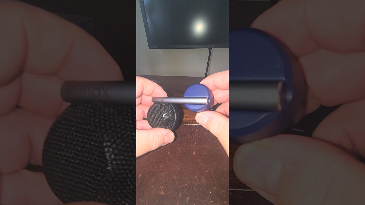

To fix my problems I had to pinch the sides of the pogo pins on the dmas earpiece connector with tweezers (so make them stiffer and taller) to make better connection with the pads on the head strap socket. been smooth sailing since then.

I have now screwed the headphones on and off several times. Screws are tight too.
However, it does not wobble on the screws. But it wobbles in another place.
