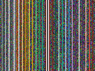

At very low compression ratios, DSC may break down a bit with synthetic images combining exactly solid colors, high-entropy noise, and periodic patterns. Whereas frequency filtering allows much higher compression ratios before approaching a risk of artifacts, at the expense of far more computation.
_
For DSC artifacts to be observable, images would almost certainly need to be sent to the framebuffer directly, and approach the limits of normal human visual acuity, with none of the rendering in 3D space typical of VR.
Some psychometric researchers using VR headsets to present raw stereo pairs may need to consider how known artifacts could impact their study. Worst case, their images could be run through the same algorithm, highly magnified, and viewed in slow/fast motion, before performing the study. Whether these limits will be encountered in any case for which current VR headsets are in fact the best available technology seems doubtful.
(Various HTML colors casually selected, random RGB noise added, checkerboard pattern added. Absolutely no coincidental resemblance to any real-world symbols intended, and was actively avoided.)
