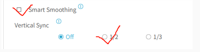

in 283 there is a selection for 1/2 and 1/3 and from the description it depends on the frame rate set for the headset, so if it uses 1/3 even when 1/2 is selected it would still be possible to set the headset to 72 or 64 Hz, then there should be no need to 1/3 if the frame rate drops below 45 fps
(72 hz is barely usable for me and 64 is a flickering mess but that depends on the user and its also possible to get used to it after a few minutes)

looks like this in 283
not sure how it looked in 27x, from the dialog it implies as if you choose 1/2 it would use this and nothing else

Yeah it’s just renaming of the compulsive smoothing I think.

Did you turn on Smart Smoothing and 1/2 at the same time?

Yep the above doesn’t work to disable the 1:3 smart smoothing, unless something else changed in the last two versions of Pitool I currently stuck with .280. (there are two bugs with the newer versions - one is that the GUI doesn’t scale to the desktop scaling properly (I use 150%); the second is a glitch mentioned by @mbucchia that the menus get handled differently). They keep suggesting the above in the ticket as well. It misses the fact that if your frame rate is less than that of the 1/2HMD refresh rate, we want it to simply skip frames instead of go into 1:3 mode. It stays there too long and looks far worse. More importantly, Pitool currently seems to measure the timing wrong such that it induces the 1:3 mode way to early as frame rate decreases.
