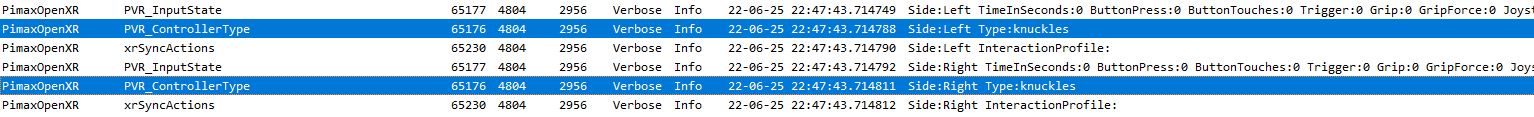

Can someone with Index controller contribute a trace? Preferably MSFS2020. This should be enough to get strings from PVR for the Index controller.
OH nevermind that! Turns our @DJSlanr did provide a trace and I finally had a chance to look at it. The issue for Index controller is obvious now!!
The Vive controller string is vive_controller in PVR (Pimax SDK) and also vive_controller in SteamVR.
The Index controller string is index_controller in SteamVR… So I had guessed that it would be that in PVR as well. But DJSlanr trace is showing the issue:
They called it knuckles instead!
So it should be a simple matter of replacing index_controller with knuckles in my code to make it work! ![]()
