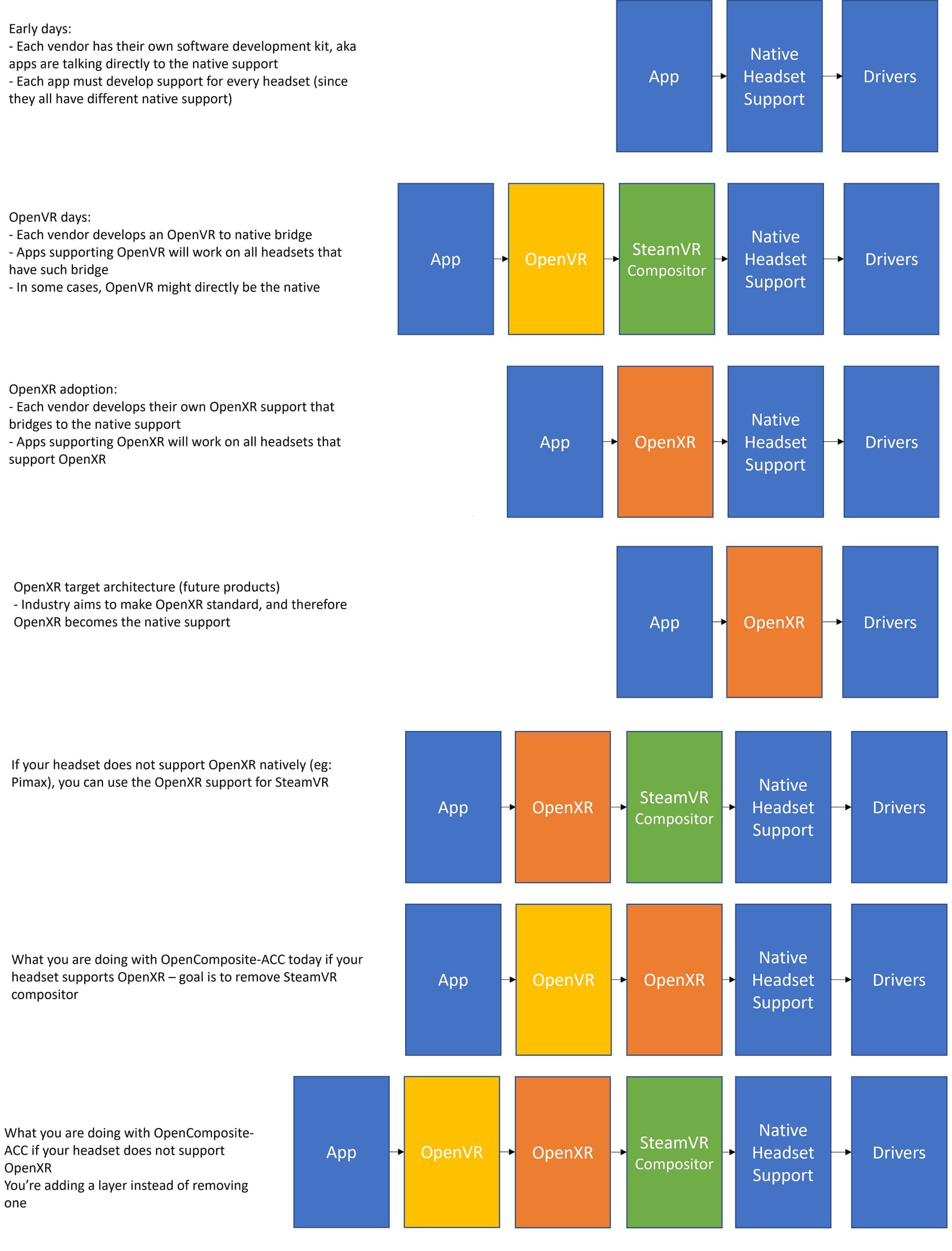

I don’t think you’re going to get any gain from using OpenComposite-ACC to use OpenXR with DCS, because Pimax does not support OpenXR directly, and it passes through SteamVR anyway.
Here’s a quick diagram I made and that should convince you why (see last row):
Yeah no need to use Opencomposite if DCS supports Occulus mode. Just use Pimax’s Oculus support that works without steam.
This brings maybe points for wmr HMDs and his bad SteamVR translation, but not for the pimax.
Look, crappy wmr 40FPS without Repro, pimax, same scene 78 FPS with much higher resolution.
