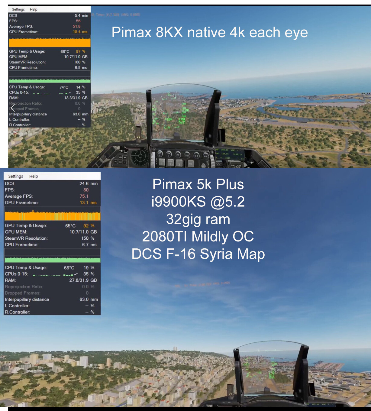

10:57 - DCS performance comparison on 2080 Ti vs 3090. The 3090 doesn’t gain much. But not sure what game settings he is using:
Edit: I also use Smart Smoothing with the X to hold 37/38 FPS with a 2080 Ti. As a casual player I just use the ‘VR’ graphics settings to do that. Low to the ground or in busy locations it will drop, but generally works.
You seem to know most of them already. Getting 37FPS isn’t that abnormal if you are going for 1.4x TotalSR, depending on the situation. You might try lowering Pixel Density to 1.0, setting SteamVR Video/App resolution to 2160v, and PiTool Render Quality to 1.25 or even 1.0 , then setting all DCS World quality stuff to minimum. Some of those, like MSAA 4x or Terrain Texture Quality, are known to have massive performance impact and minimal to no visual quality improvement.

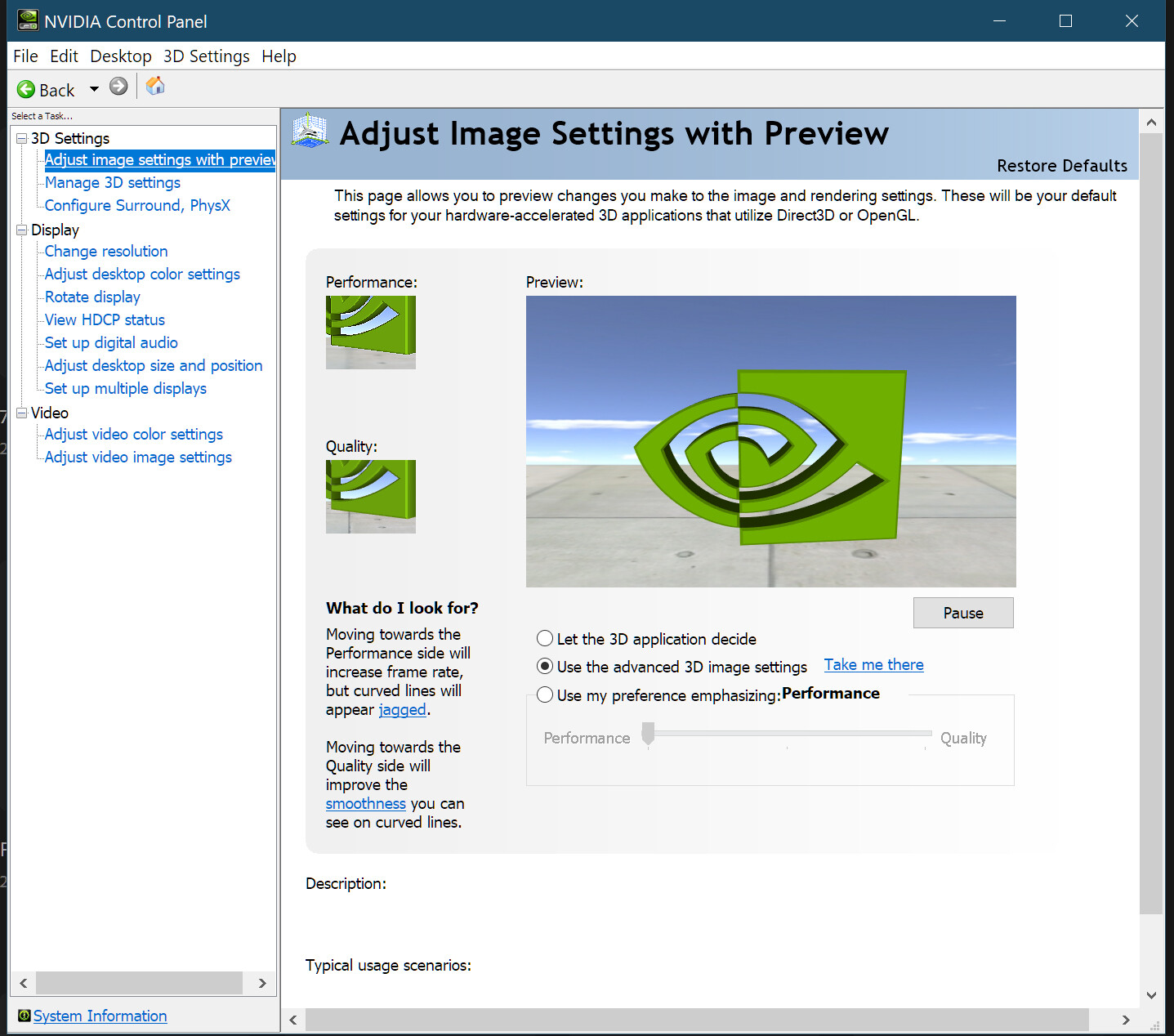

I’ve tweaked my NVIDIA based on a lot of research online to max FPS - when you are running high resolution graphics either in VR ( pimax ) or Flat screen and need FPS don’t waist resources on smoothing keep those setting at their lowest or off. The more the pixels the less you need smoothing.
Will post my nvidia settings - hope it helps
