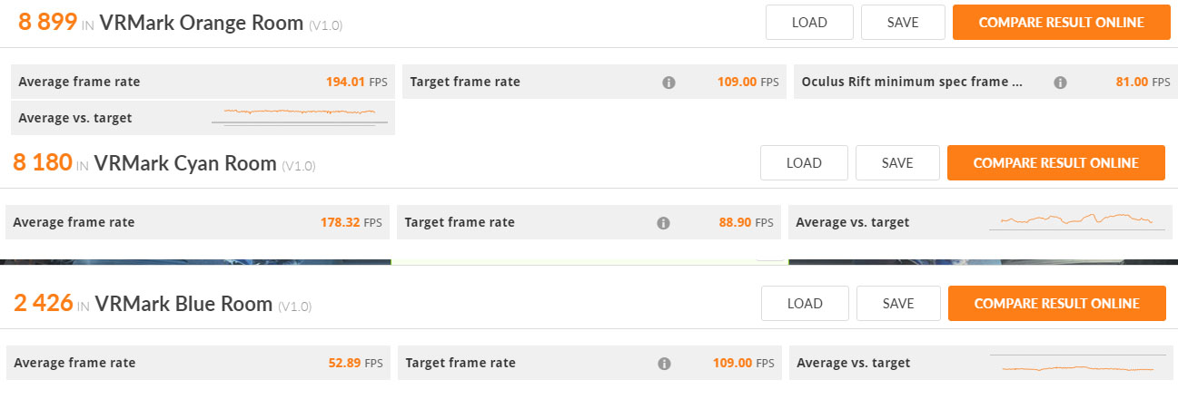

VR mark is like any other synthetic out there, it’s not completely indicative of whether you can or can’t game in VR, but if your system can make a good showing in it, it will most likely perform well in most games. If it looks like my 8150 results, you might consider sticking with 60hz small fov VR. Orange room basic is still free if I remember right, so it’s no loss to try it. It’s also has a great demo for people who have never used VR, that just need to sit still and look around. My kids and ole lady loved it. Blue room is still brutal for all but the most expensive systems. You can also feed the headset the benchmark as well, but your frames will of course be capped at the refresh rate of your headset.
If I had a dollar for every time you answered that :rofl:

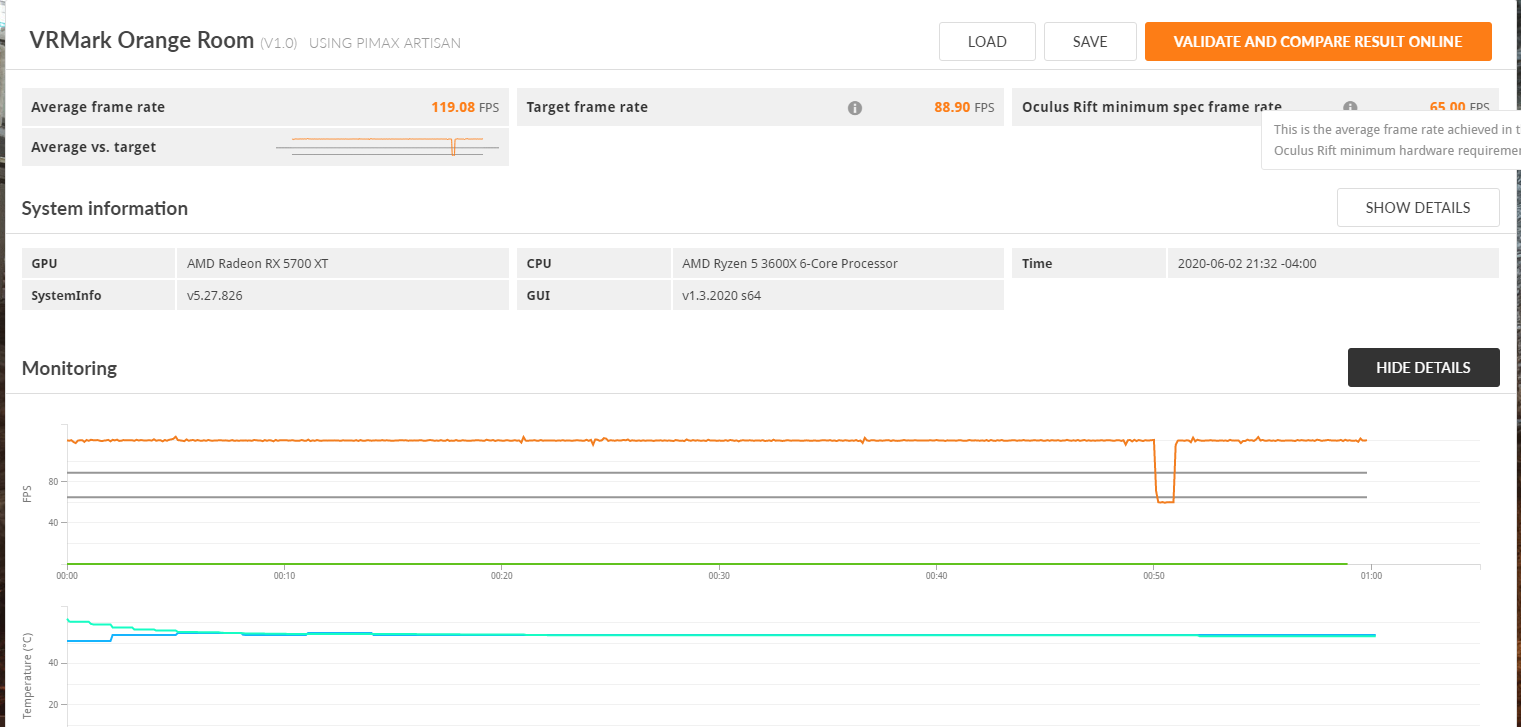

I would ignore the odd frame drops to 60fps, it looks like an anomaly to me.
These are tests through the headset of course, (don’t know if it matters) but additionally it’s being displayed on a 144hz monitor. It was kinda fun to see just what my rig in normal every day use configuration would do. I’m half impressed. :slight_smile:
For reference, same settings (default on VRMark, and whatever my PC was set to for everyday use) while watching youtube, on another 120HZ monitor, while playing the audio through a 4k TV, without sending the video through the Artisan.
