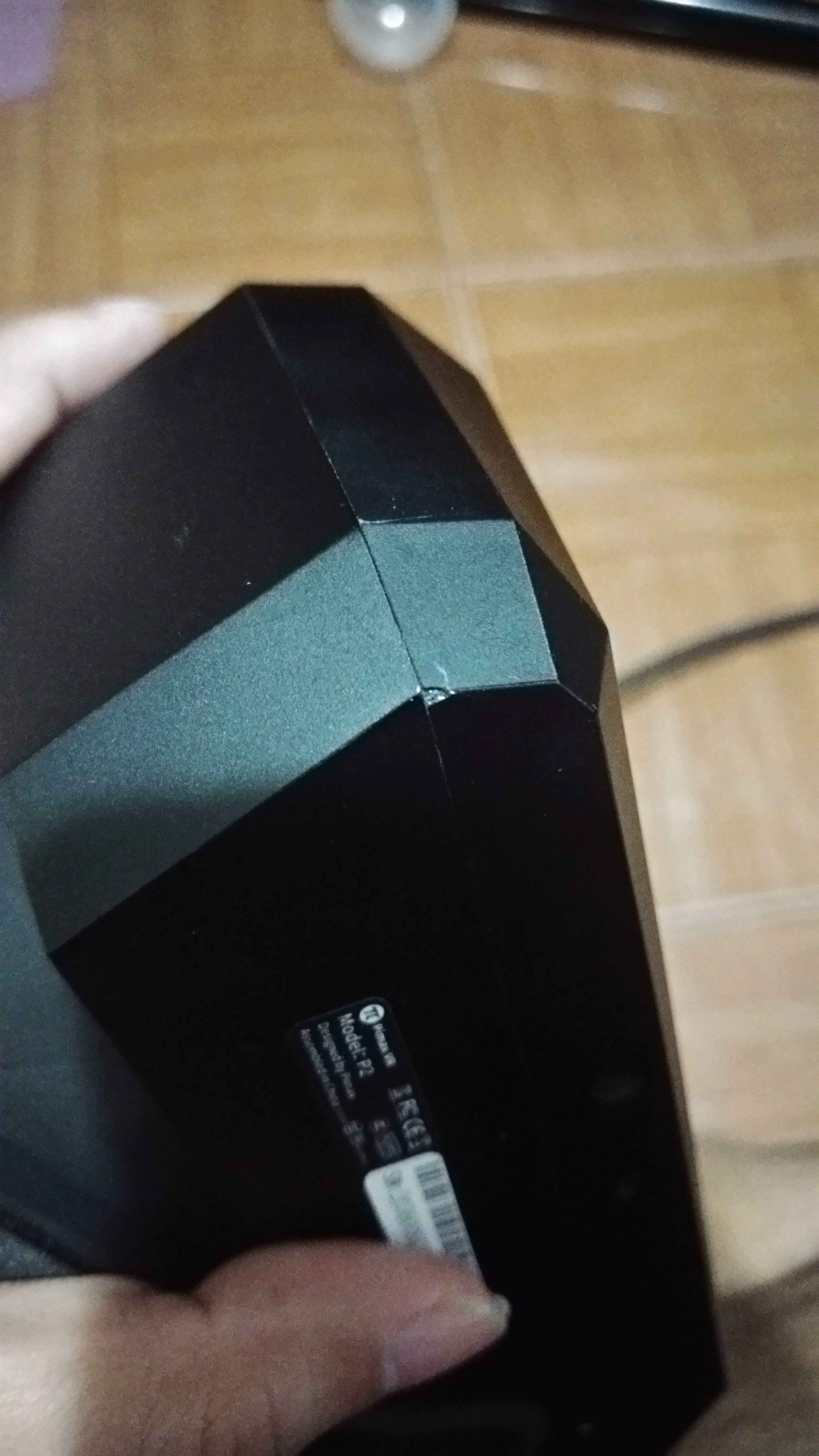

  1. Housing issue.
Old headset, the small crack can be bigger
First week.
Now.
