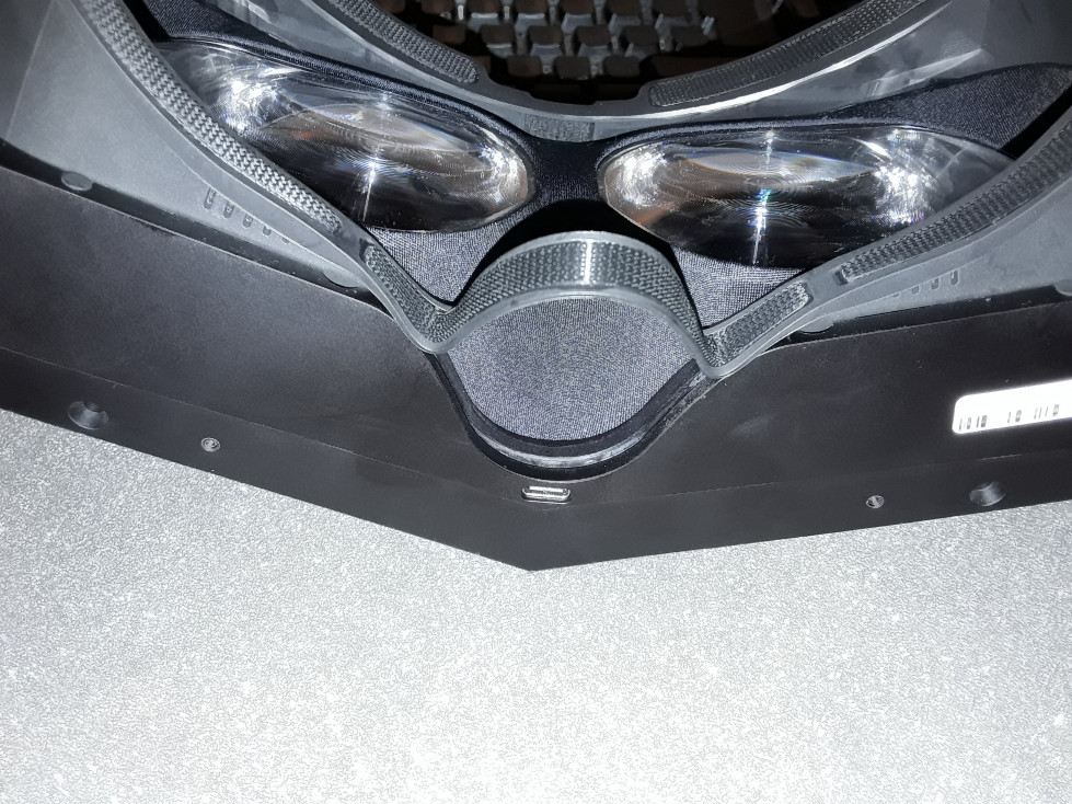

First, bend the nose part backward like this:
Then unclip around the nose by pulling like below (do that for the 2 sides of the nose):

I finally managed to rip it off, but I would definitely not call it user friendly. I felt like I was at the brink of crashing the headset. I do not think Pimax originally planned it as a user replaceable part. And as you wrote, it really did not help pushing it in or out, it just needed a brute force to pull out.
If you have the comfort kit, look at that, it has indents were the HMD clips are, then you can pull the cowling of at those points, I would not recommend pulling it from the nose area, My one looked like it was going to split the cowling when pulling from the nose.
I Had to use a butter knife on one of the top clips at first, once you get one clip free the rest will follow.
