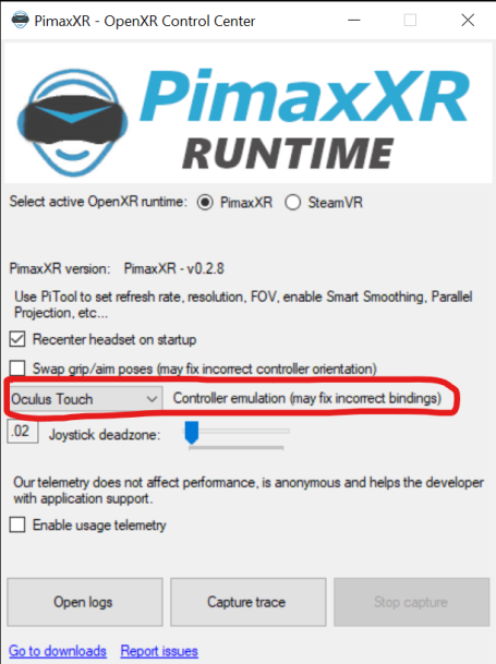

I have released a new version of PimaxXR, the unofficial OpenXR runtime for Pimax. This version 0.2.8 makes the game playable I believe. If you are using an Index controller, you must enable Oculus Touch emulation from the PimaxXR Control Center app.
Download here: Home · mbucchia/Pimax-OpenXR Wiki · GitHub (version 0.2.8).
What type of controllers are you using? I have tested Vive and Index, both worked with and without OpenXR Toolkit. Maybe give a try to new version 0.2.8.
