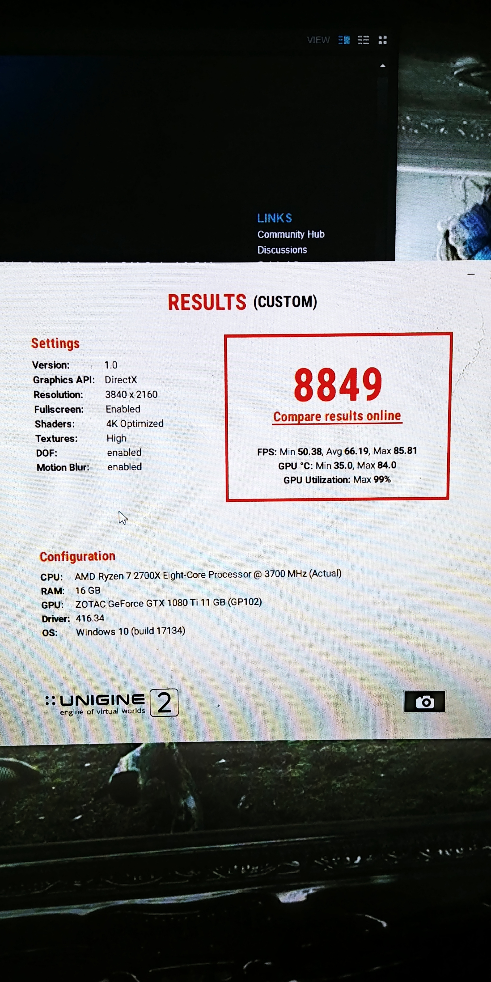

I have R7 2700x with 16g ddr4 3600
1080 ti Zotac mini
Avg Fps 66.47 Target 109.00

Unigene Supposition Benchmark.

You mean Suppository? Or Superposition?
