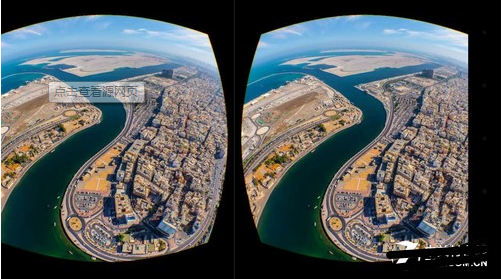

Hi Dpreller, if the Blue Ray Player uses a Microsoft Windows OS, it’s possible to Light up Pimax 4K. But there is a big problem to watch a movie because the display mode is totally different from a TV. When we connect a TV to a Blue Ray Player via HDMI, the TV will show one picture as a whole. In VR display, there are separate pictures for each eye. Not sure if you understand these words. I will upload a picture for your reference.
The image in VR display is like this
Thank you MXZ. I totally understand how the two images would be displayed and Thank you for the reference image.
