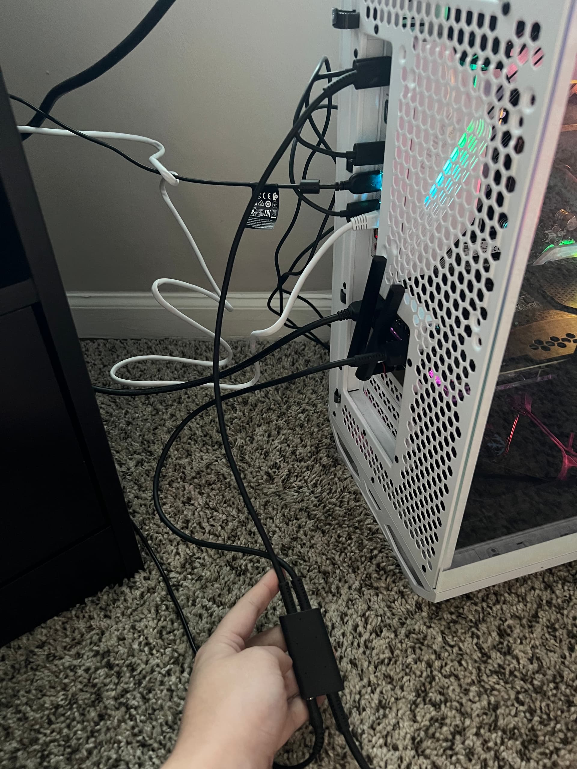

The snow issue is related to the shielding on the cable being absolutely terrible (at least it was in my case). I noticed it gets way worse if the usb part of the cable is near any other cables (which is quite hard to avoid when plugging into the back panel of a pc). I’m sure that’s where a vast majority of complaints about the cable come from, and it definitely explains why lots of people have the issue day one.
See how I’ve connected the usb lead from the Pimax cable in such a way that it’s not crossing any other cables too closely? That was the fix for the snow issue for me. Try playing around with it a bit while in vr and see how just moving the cables around impacts the intensity of the snow effect- I wouldn’t be surprised if the fix is just to add extra shielding around the Pimax cables (both usb and DisplayPort separately) where they connect to the pc.
Nice tip. Thanks Brian. :beers::sunglasses::vulcan_salute::sparkles:
