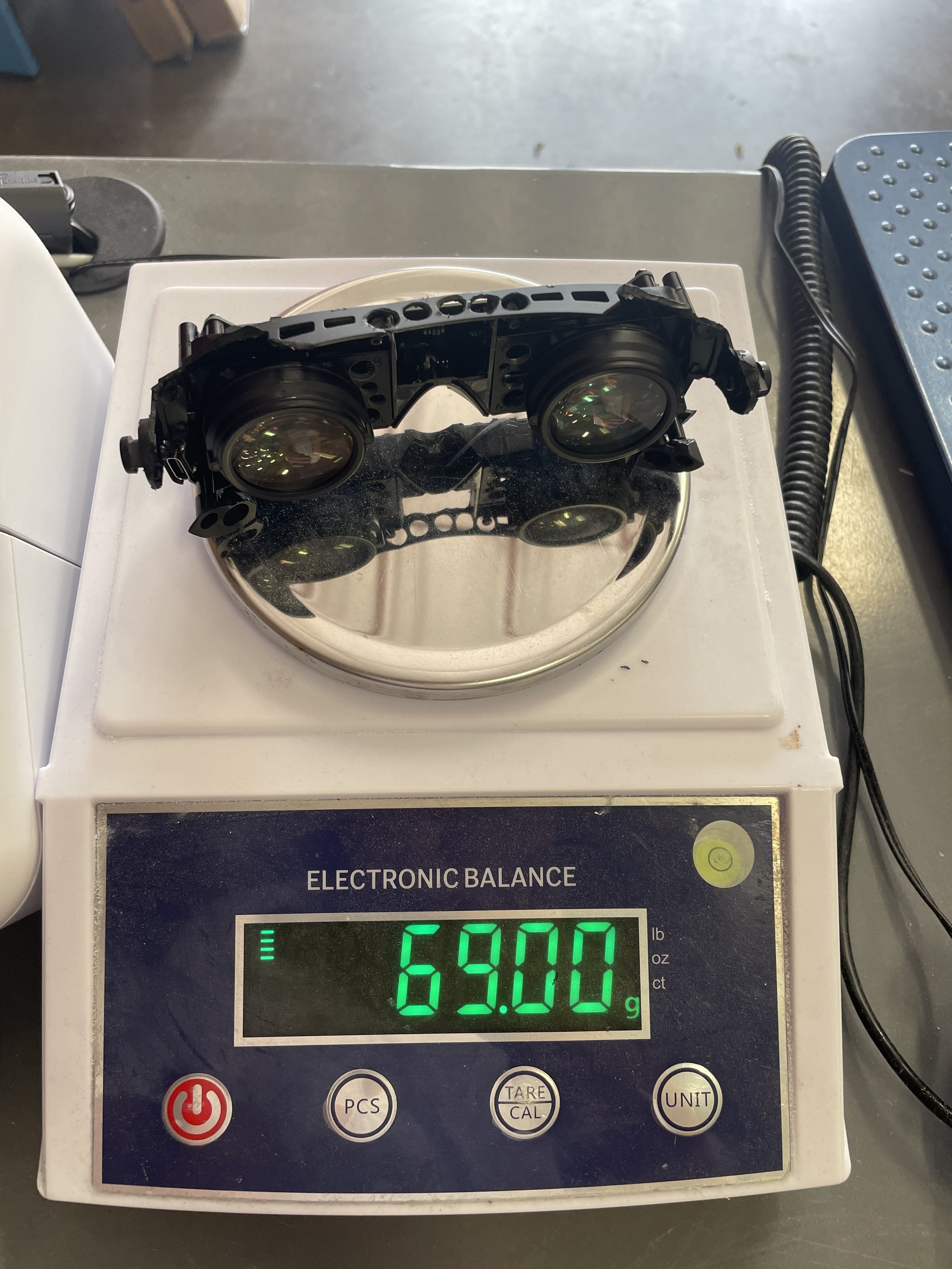

So I modded hmd to halo option with a nose bridge (you can find all mods refs in remix section Bigscreen beyond nose bridge gasket by pruban - Thingiverse )
After the mods, I have no issues with heat, no more face strain, and eyes are also fine. Moisture problem became same level as on index, so no issue here. And wow only then I could realize how light the hmd is, when your comfort is good and you have no strain spots issues, it’s literally weightless, I had no this feeling with any of others hmds, so this was the main selling point for me along with oled and native steamvr headset. That’s a truly underestimated feature.

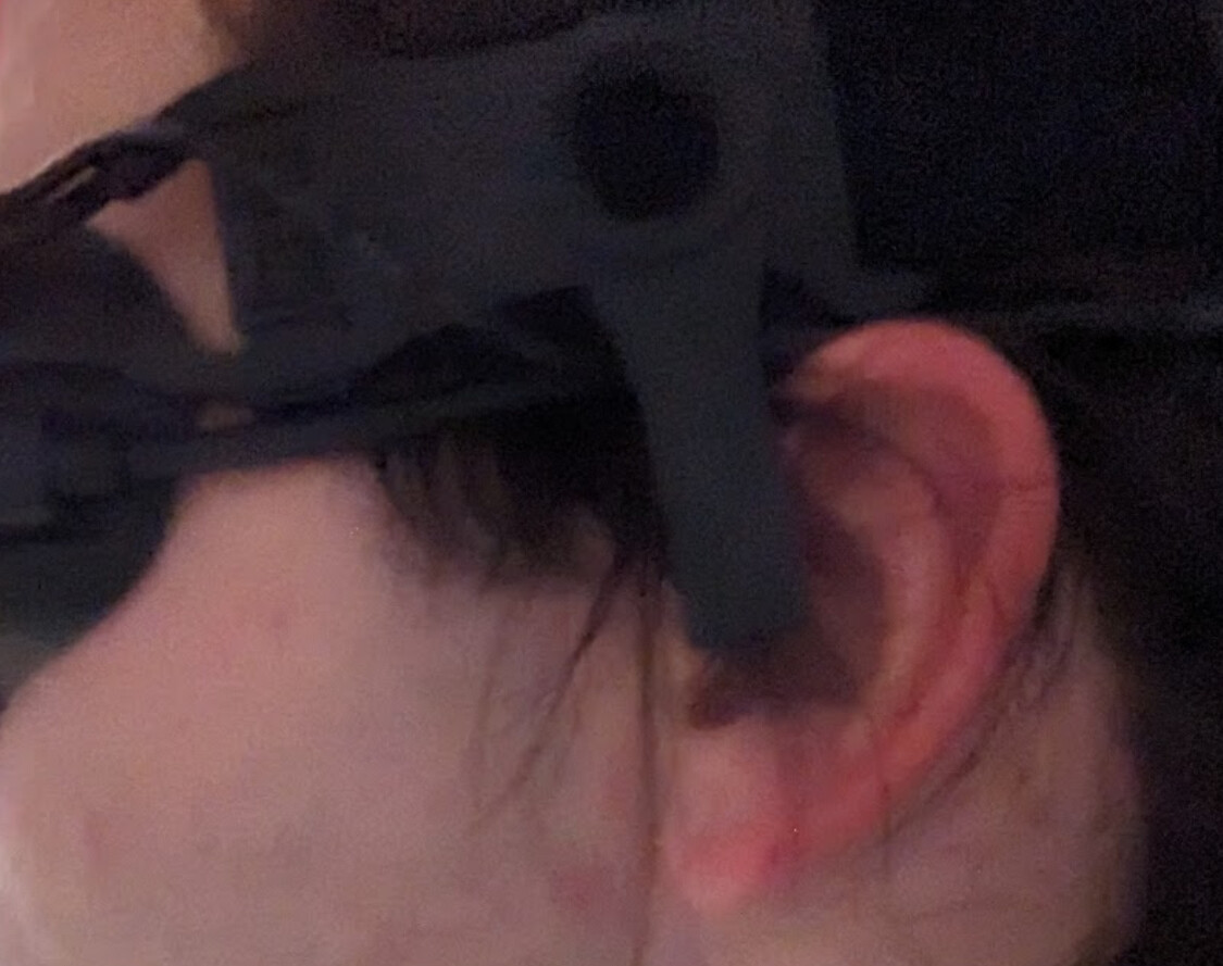

For audio I opted to soft strap tiny speakers similar to quest concept, to not increase the weight. Before was using hd-650, it is very ok but I don’t like to add any not mandatory weight to the hmd this light
You need to join Discord server to see the link, it is public now Discord (invite Bigscreen Beyond)
Here is the picture of the audio mod
